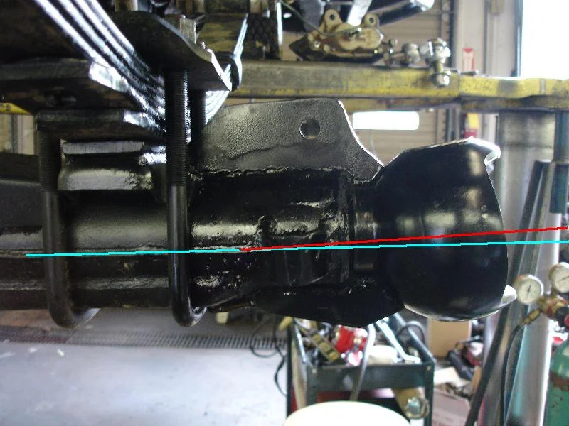

I have been in the process of upgrading my front axles from 27 spline longs to 30 spline and while I was there I would clean, replace all seals and new studs for the high steer arms. I also reinforced the knuckle (because it likes to bend there) with a new shock mount from Marlin.

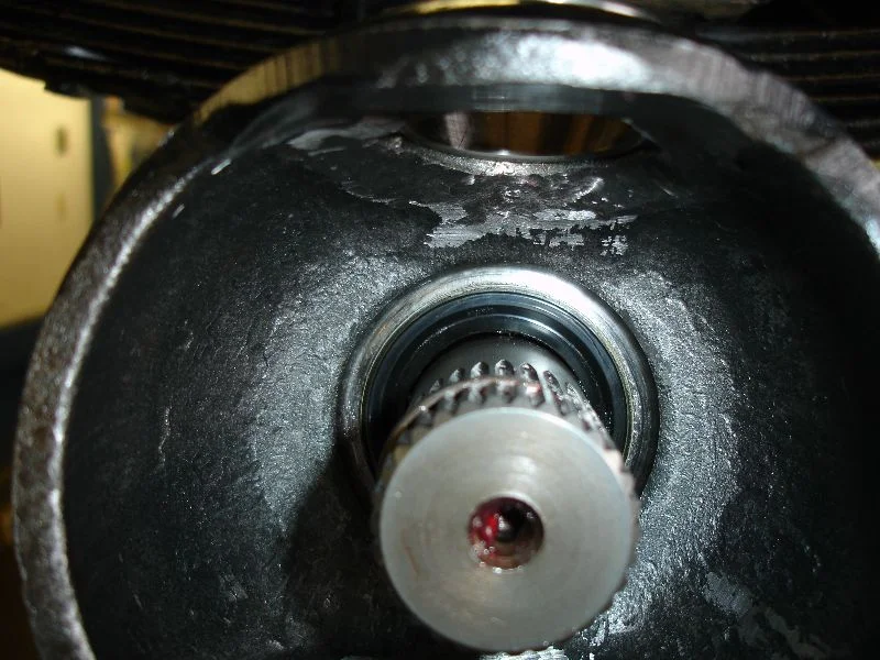

I noticed that I was having big problems getting the longfield to clear at the bottom of the knuckle housing, and when I installed just the axle it would bind on the seal.
It now explains strange noises that I heard and why the axle came out of the longfield and stripped, and that I had to use a slide hammer to get the axle out of the housing.
Problem is that I just reinforced a already bent housing and didn't know it at the time. :mad:

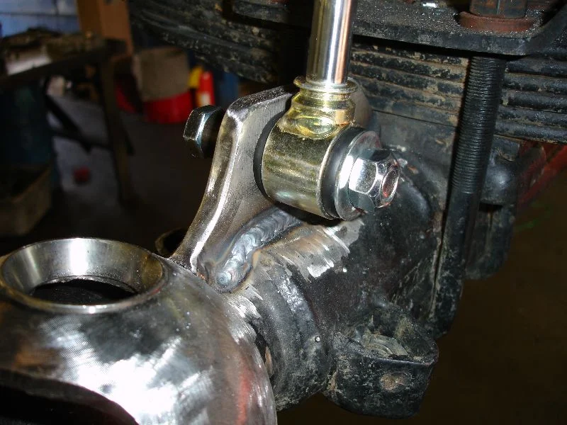

Nice new gusset with shock mount

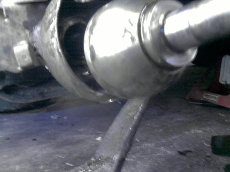

This is the new axle in the bent housing, the axle is smashing the seal down. I cant even push the axle up and I had to use a dead blow hammer to get it all the way in.
Kiss that seal goodbye.:crybaby:
Wonder why this side was leaking so much :lol:
After a entertaining thoughts about dana 60s I wasn't going too give up all that work that I had put into that axle and was determined to fix it.
Turns out that the shock mount that was supposed to strengthen it was going to help me bend it back.

Is it possible that the shrinkage induced by the long weld on the gussett is what caused it to bend up?
My front axle is also ever so slightly angled like yours, and I would like to make it perfect.

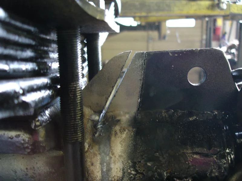

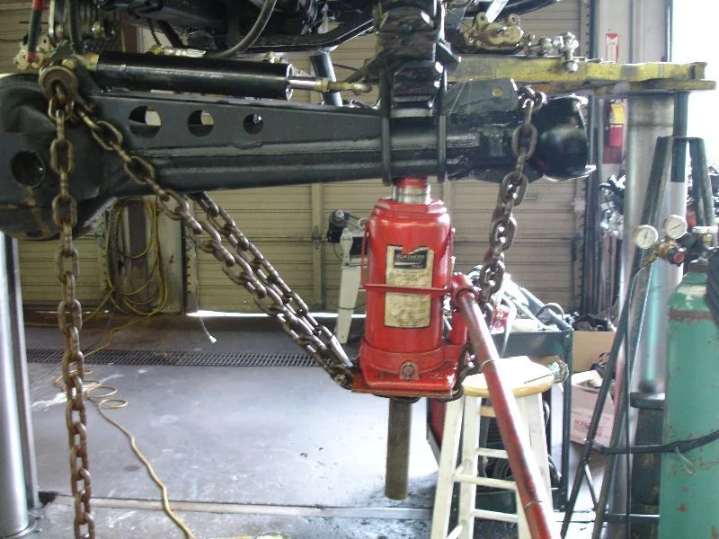

First I had to find out where to bend and with using the Portaband bandsaw (the best tool ever). I made two cuts down the top gusset where I wanted the bend.
A few on the bottom gusset to allow some room.

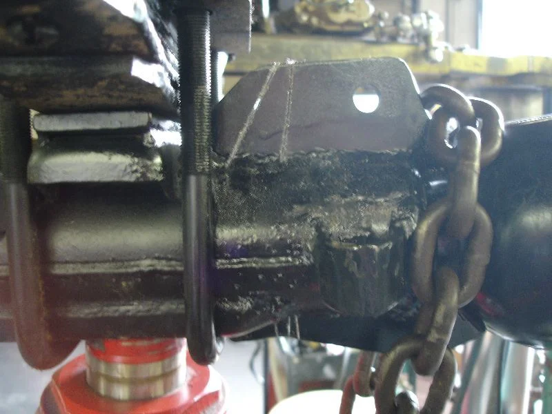

Then I wrapped a big chain around the knuckle and up around the ram mount over the diff, using the shop 30 ton bottle jack still mounted the the press plate with ram. I hung it from the chain with bolts holding the chain together on both sides of the jack. Found a good strong point right between the ubolts, double checked everything and went for it.
After applying some heat with the torch and swinging from the jack handle the axle bent right where I wanted it to. I had left the axle in the housing during this and checked it along the way, stopping when the axle freed up and slid out of the housing with only two fingers.

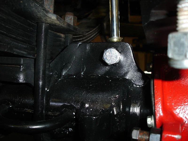

Welded up the gaps, let cool, replaced the seal and good to go.
WOW - I'm amazed the jack didn't crush the axle housing when you were swinging from it. Too bad somebody wasn't there with a video camera...

I did the same thing on my Toyota before putting on the ball gussets. I used a piece of railroad iron for the jack to rest on. It worked really well and no catstophic failures so far.

To the original poster: I bet you bent the axle while welding, which is very common if you dont weld an inch and let cool and repeat.
Shold be said: Long fields often require clearencing to fit in the stock knuckle balls, so if you cant fit your longfield it doesnt necessarily mean your housing is bent.
Having said that: Yes Mini truck housing are notorious for bending. I am on my 3rd housing.
I fully agree......alot of heat looks like was applied

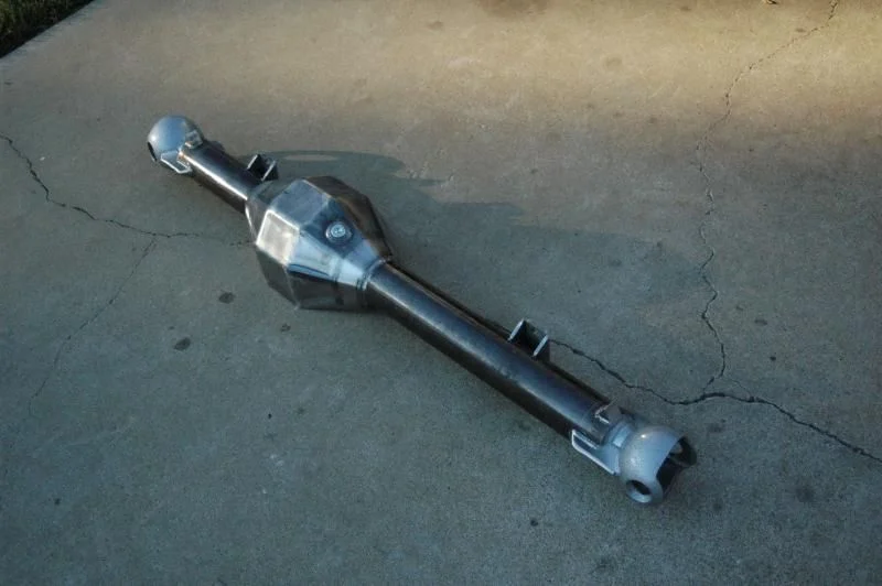

There's a lengthy thread on Pirate by "Pat" about lengthening a mini housing. he built a fixture to measure runout on a dummy axle shaft, then watched the housing warp as he tacked various bits. Even small welds on next to the flange face that holds the 3rd (he was building up the face for an elocker retrofit) cause it to warp significantly. He's totally convinced that welding gussets, especially the large ones that go on top of the long side of the axle cause them to warp like crazy. As a former machinist, I can vouch for the quality of his fixture...so I trust his observations that the thinwall material the housings are made of really pull.

yep. those big blobs of molten metal become smaller blobs when they solidify, pulling the housing with them.
