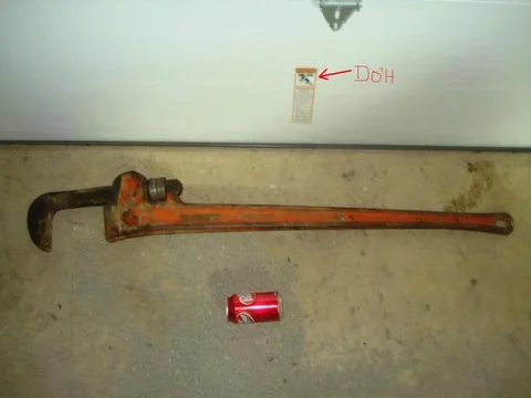

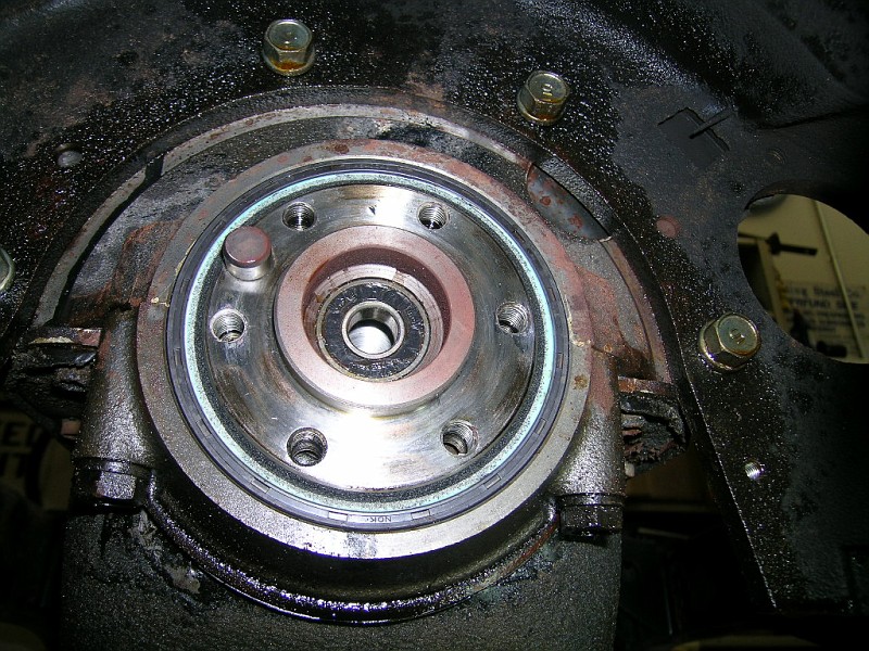

hey guys thanks for all the help! i was able to turn the engine to get the bolts off the clutch, my neighbor Alan came over with his "BFT" and we were able to turn the engine, once the 12mm bolts came off the clutch the flywheel was pretty easy! i placed a DR.Pepper can next to the "BFT" so you could see the sheer size of this thing, apparently this thing was used to repair old tractors down here in Tejas!
