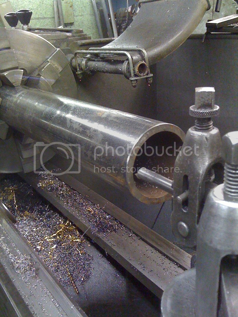

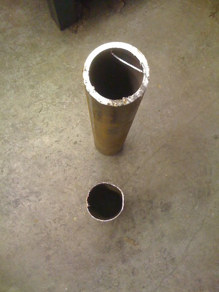

thought it was time for an upgraded drive shaft..
the old stock one on the bottom if you can believe it
had to bore out a little to fit the ends. and then welded it together
That thing is BEEFY! Can you run something that heavy on the street?
Where does that move the next weakest link?
Front drive shaft only , the stock one was so bent up from the PO .. And i guess this is the only way to protect the drive shaft from getting distorted from rocks and such... And as far as the next weakest link ?? u Joint i suppose
I'm bettin pinion..
Hope you have that thing well balanced
