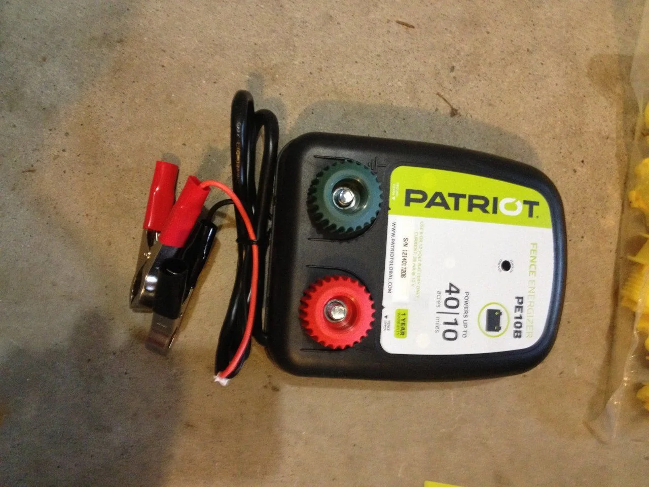

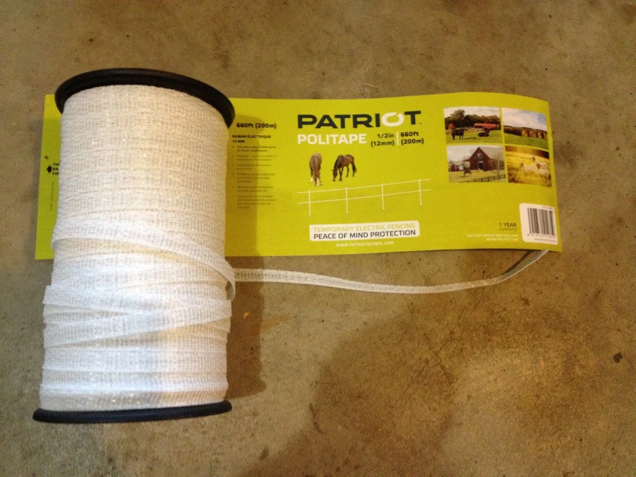

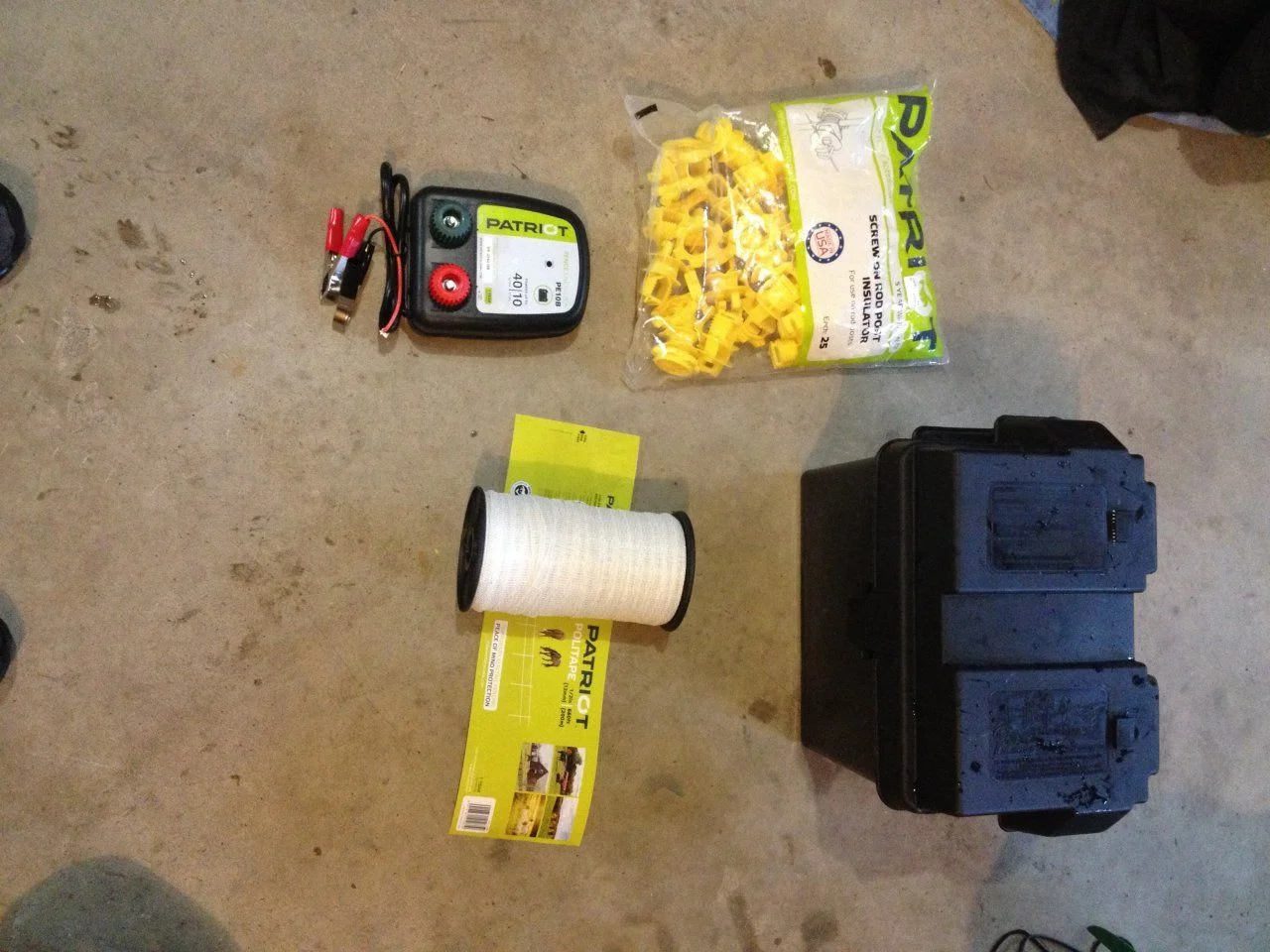

Ok. Here is what I found at Pevymart with some pictures. (CND $$$)
-Patriot PE10b electric fence energizer. Can be plugged to 6v or 12v battery. $75
-660 ft of 1/2" wide tape. $30
-four warning signs $5
-rod post insulators 25 in package $6.50.
-battery box I found at a garage sale awhile back.
There was a solar charged unit for $110 but I decided against it. This way I can use the battery for other things like lighting up the camp. Also the solar unit had half the power and thinking grizzly bear...
Thoughts so far is buy a small 12v battery and mount everything inside the battery box with an on off switch. Use 12" steel tent pegs to ground the unit. Charge the trailer body and a string of around the outside. If an animal touches with the string or the trailer steel they will get a shock.
Alternative is if I want to protect the whole campsite I can use the plastic insulators and some rebar or sticks go all the way around.
Definitely a work in progress. Suggestions welcome.
