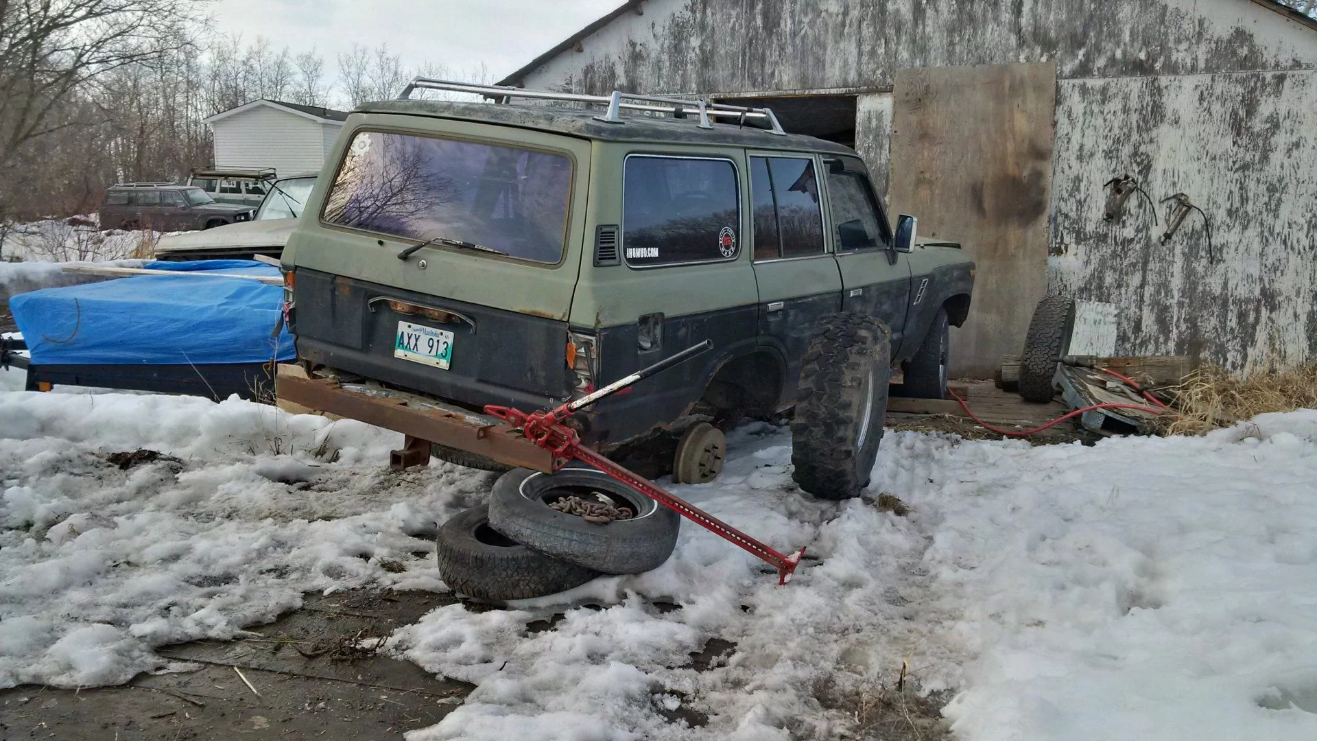

don't know about that particular tool, aside from seeing many YT Vids about similar home-built ones. But I'm thinking that there are so many "free" DIY alternatives that I suspect the market may be limited for tools like this. Personally, I'm usually using a HiLift jack, always around and works fine.
Ok , good point, but if your hi lift is already in use to remove the assembly, what's the procedure to use it to break a bead if necessary?
^^ well, if I had used the hilift to jack the vehicle up to remove the wheel in need of beadbreaking, I would either use another method than the hilift altogether, or put something under the axle or put a spare wheel on then lower the hilift and use it for beadbreaking. No biggie.
As stated, hi-lifts SUCK at holding a load stable. Use a proper jack under the axle if the situation allows, or set the axle down on a block to take the hi-lift out of the equation before working.
