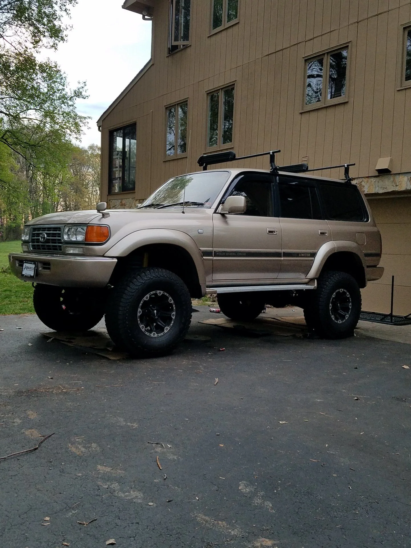

1. Purchased Dobinson 4" lift kit with heavy shocks (future armor/bumper compensation), adjustable panhard, trailing arms, sway bar drop, caster correction plate(did not use), proportining valve bracket (did not use)
Before install measurements hub center to bottom of fender LF-23.50" RF-23.5" LR-23.00" RR-23.50"
After new lift install measurements (armor weight simulated) LF-26.75" RF-26.5" LR-27.25" RR-26.75"
I did leave a set of 20mm spacers in the front
HMMMMMMMM? using the standard that I've read here that stock is around 20" from hub to fender, I now had a 6 to 7" lift....well s***, 4" caster correction plates aren't going to do and those brake lines are stretched and other issues so 2nd round of purchases started....

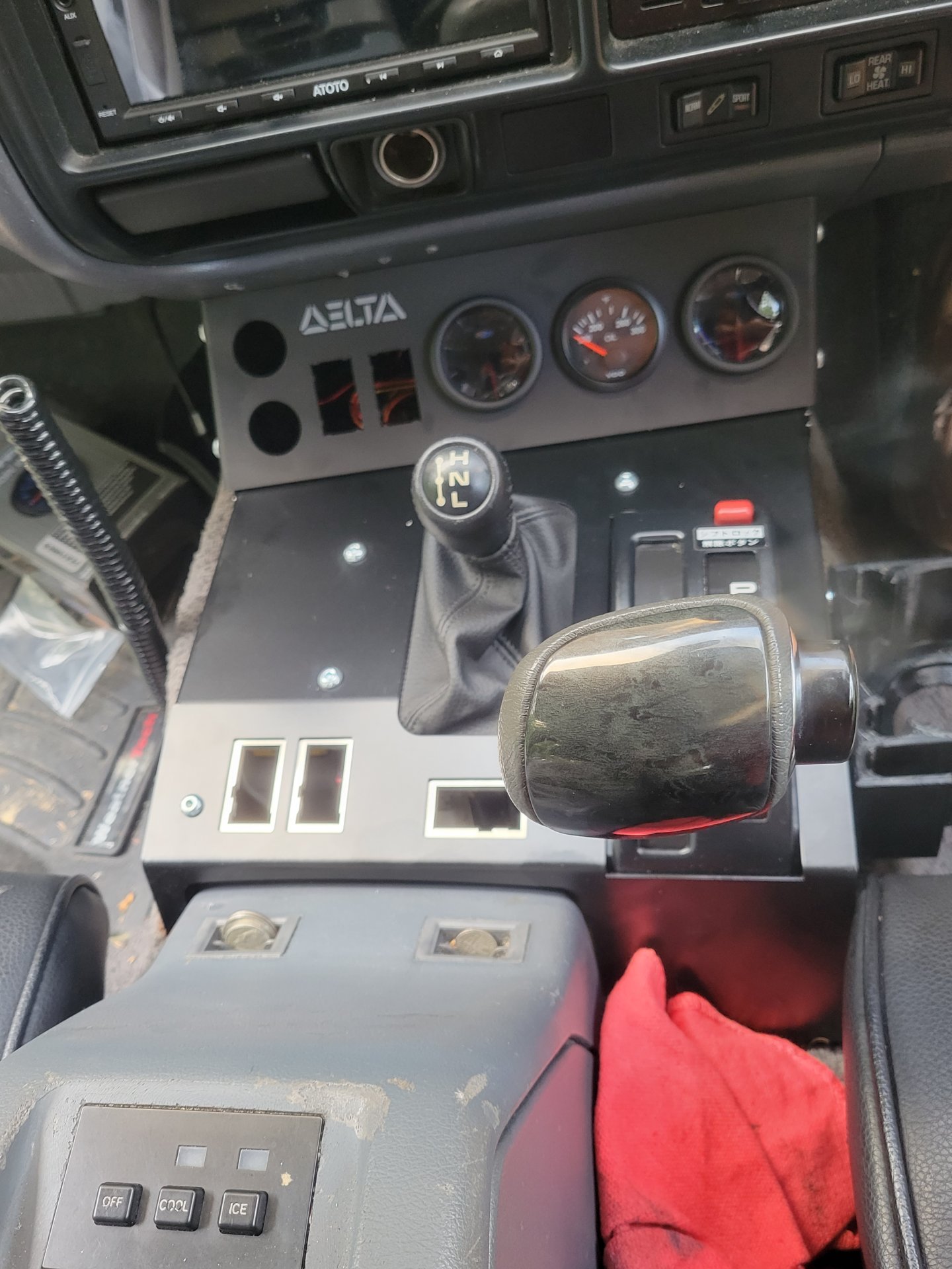

3. Round 3....Front hub rebuild (cruiser outfitters), Delta VS front and rear bumpers (squadron lights, spare tire mount, ladder) White Knuckle Sliders 10 degree slant, smitty bilt XC20 12,000lb winch, Iron Pig skid plate

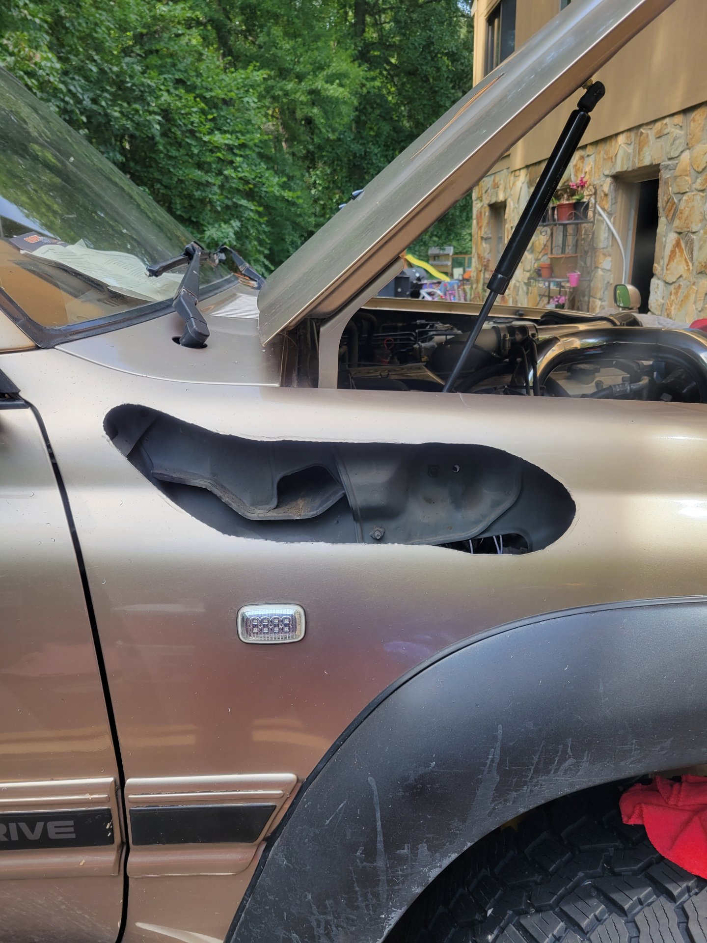

5. Round 5 things bought not yet installed: Airbox (junk yard) (current filter is aftermarket junk) with larger than stock intake pipe (HPS-4.5"), Iron Man snorkel, Oil catch can, Split rear window (junk yard),
6. Round 6 wish list: 37's, re-gear diffs, North west Fab works black box and/or Yukon 3.12 low range gear, Part time 4wd conversion maybe?, Delta VS shift console, Gauges, front runner roof rack, more lights! powertank or onboard air.....and the list goes on

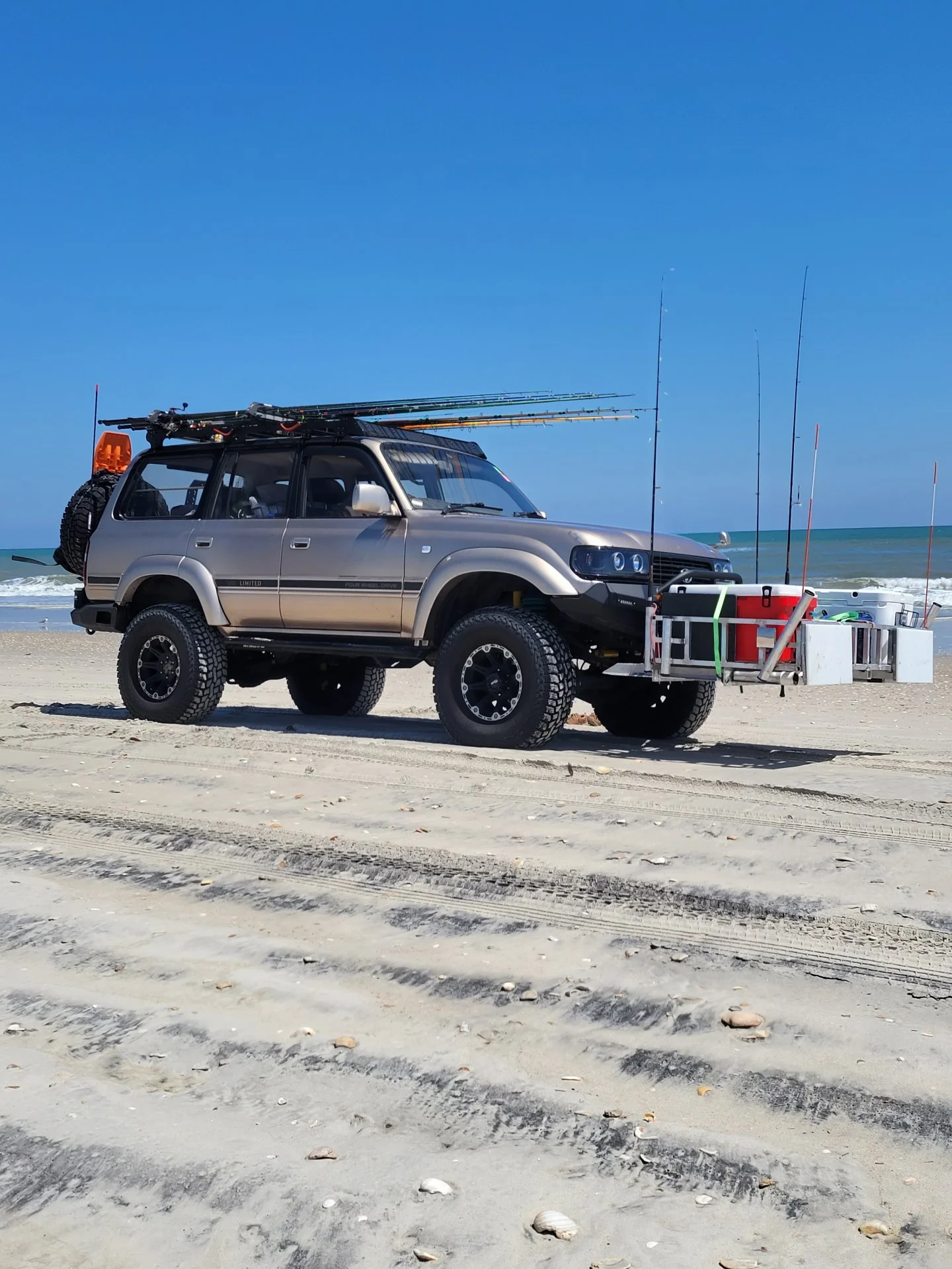

Some pics
Nice build, glad I'm not climing into it. I'd have to carry a mounting block. LOL

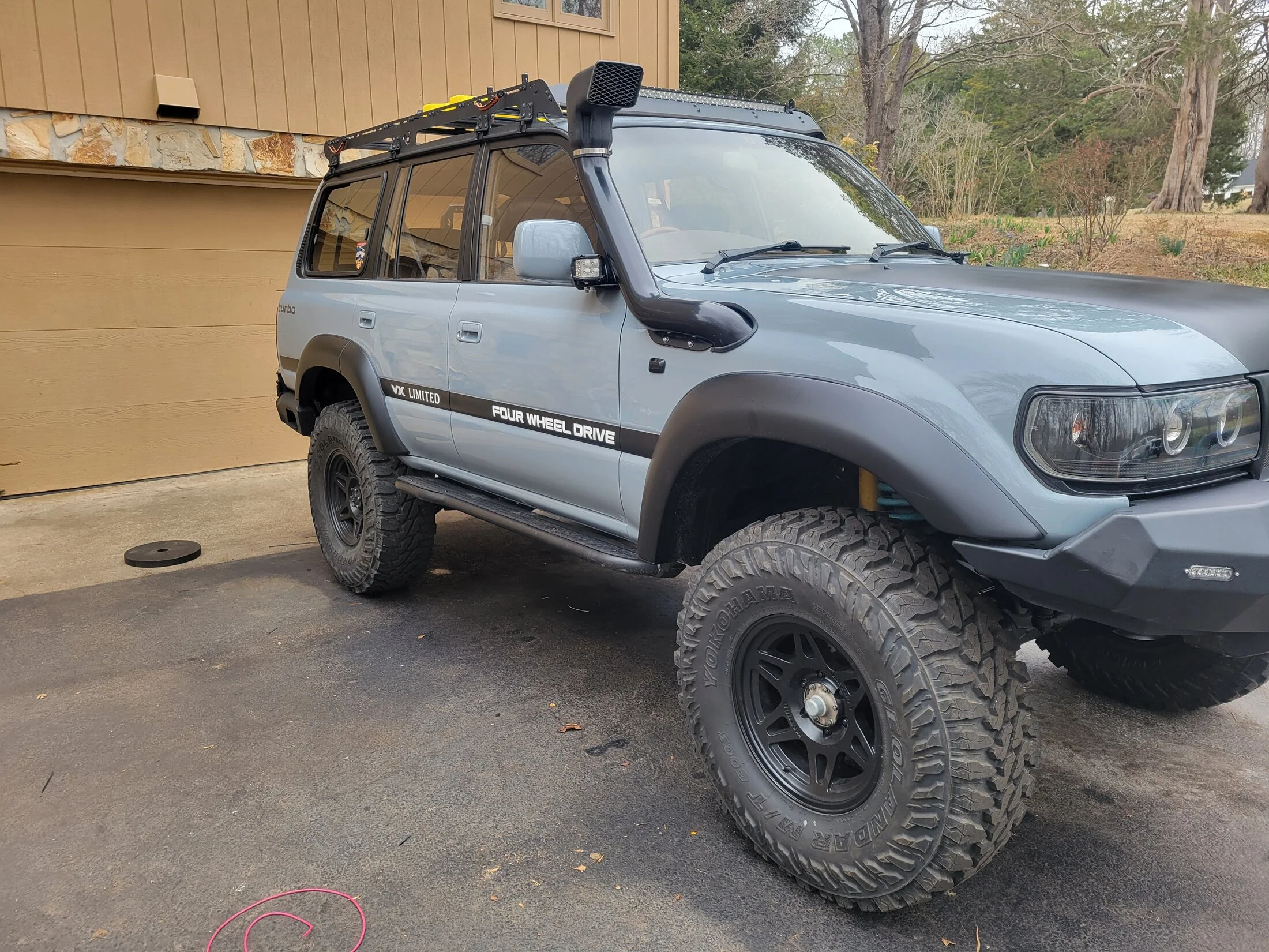

I definitely will drop it down as I get older! I really only wanted 1 to 2" more than what I had and ended up with 3+"s above the lift I already had. Thats why I did this post to alert others. I extremely happy with the performance of the Dobinson lift but if I was going to do it again I would have gone with a 2.5 or 3" Dobinson lift.

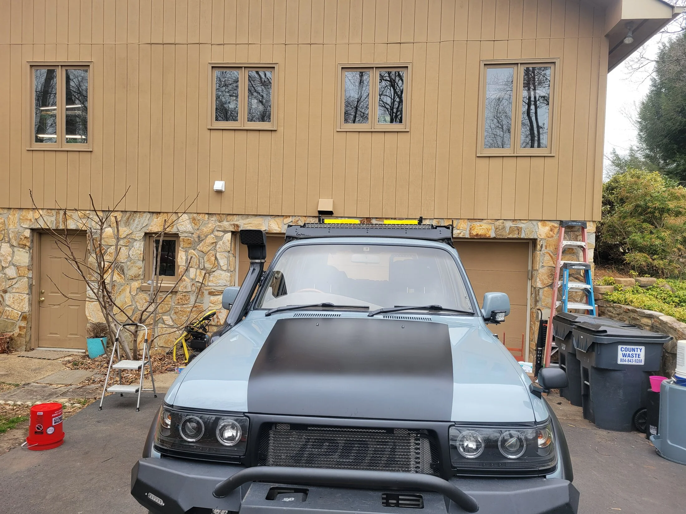

Designed and had built a custom front mount cooler rack.

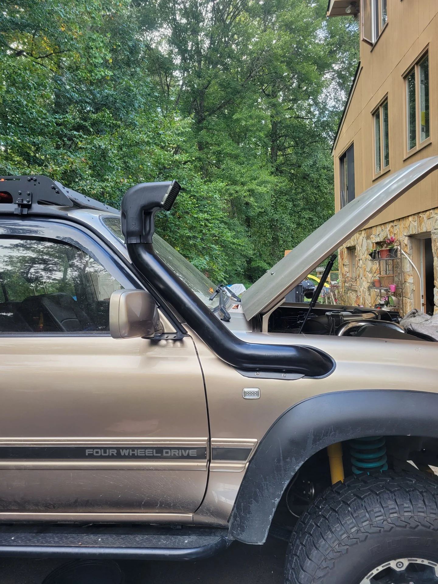

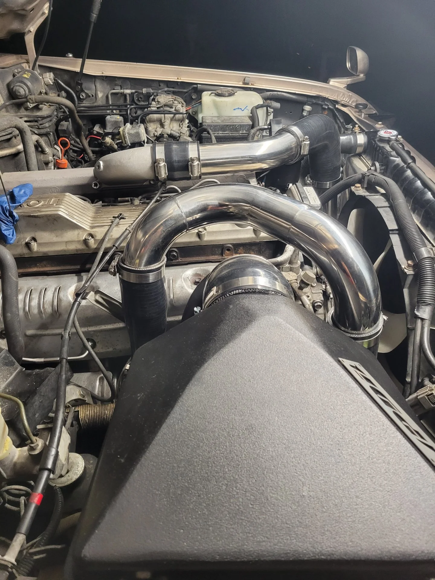

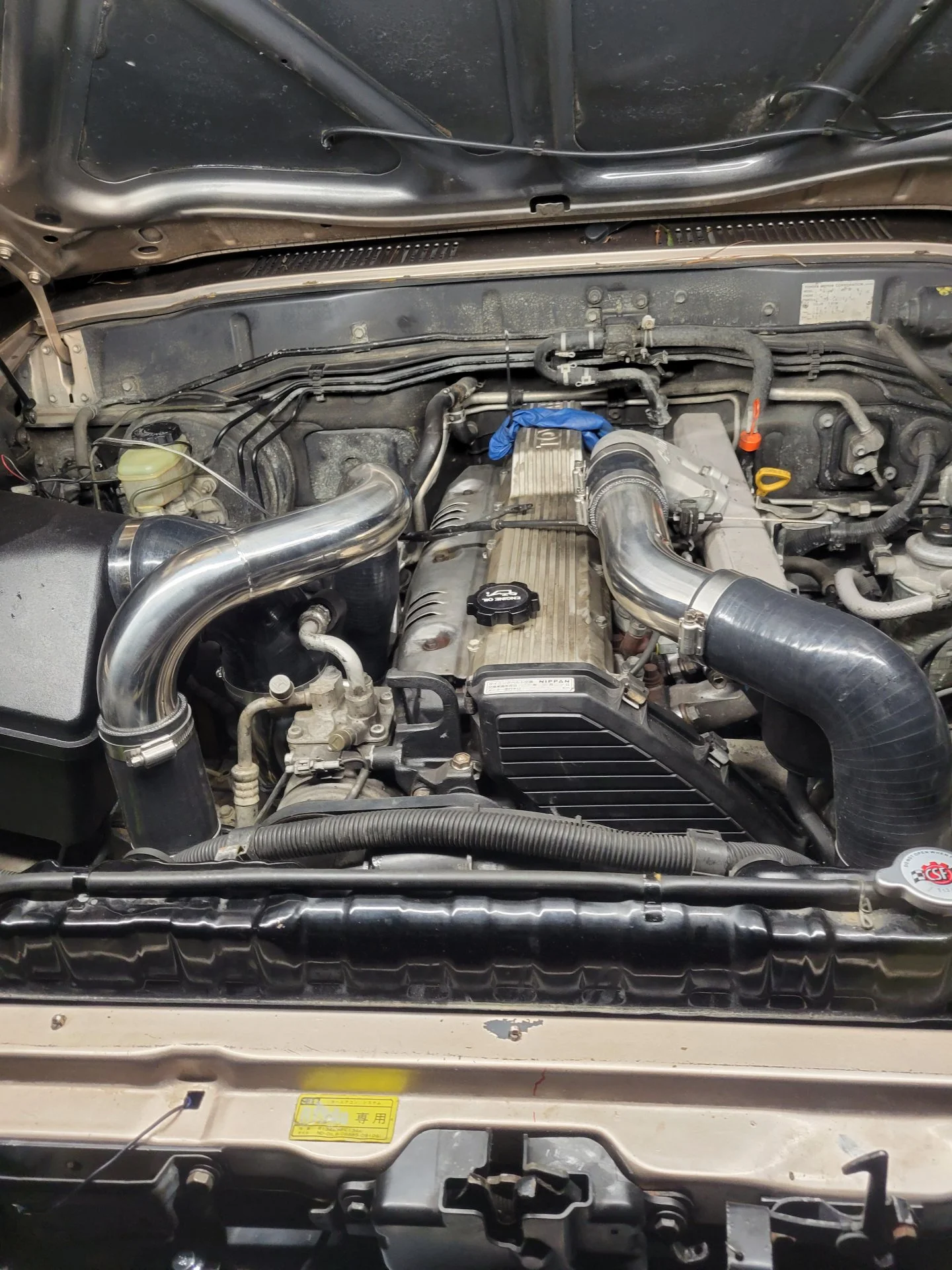

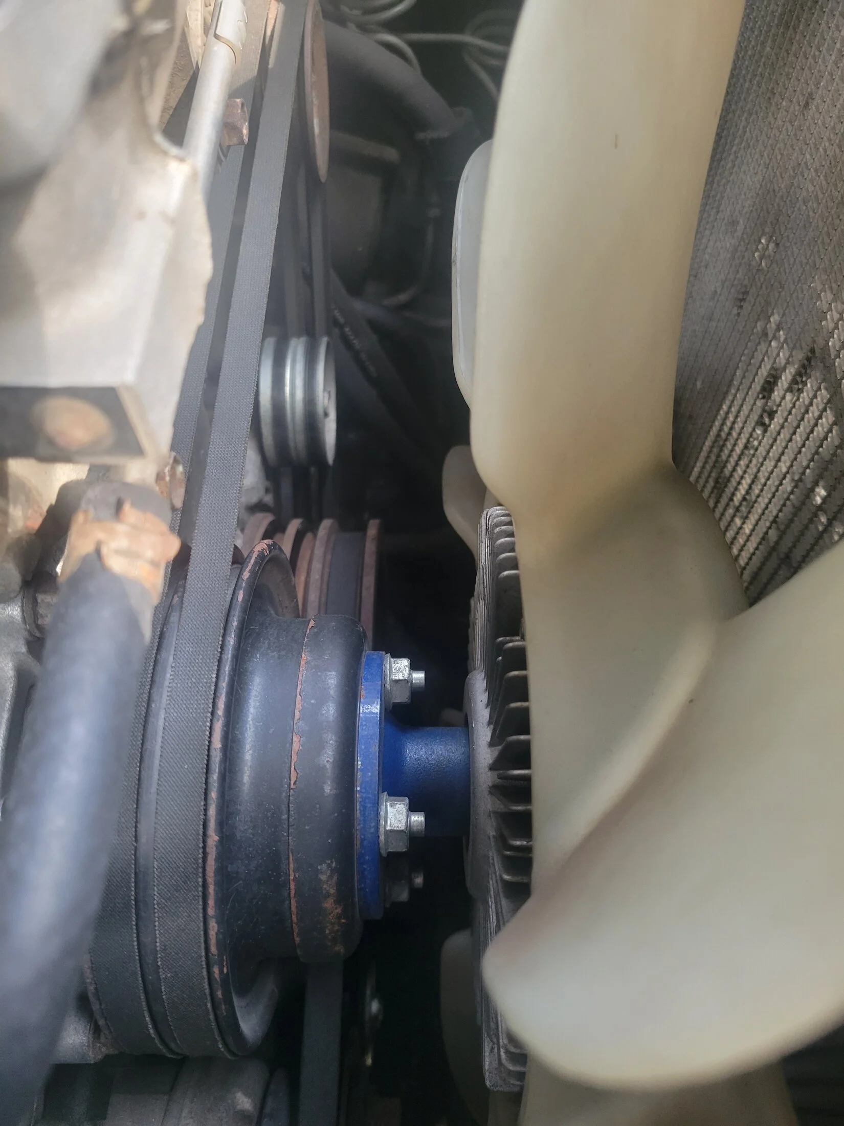

Build up date: Moonlight 4" stainless steel snorkel installed. Aneroid pin installed, tuning is ongoing but noticeable power difference! Currently wide open EGT Max around 1100*F. Working on tuning to AFR. Manta 3" stainless steel exhaust! Sounds so nice!

- Method bead grip wheels, Yokohama geolander mt 37x12.5R17

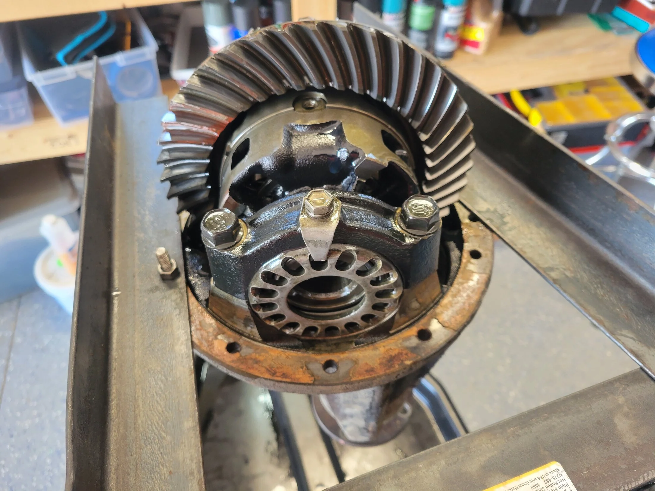

- 4.56 Nitro diff gears, solid pinion spacer

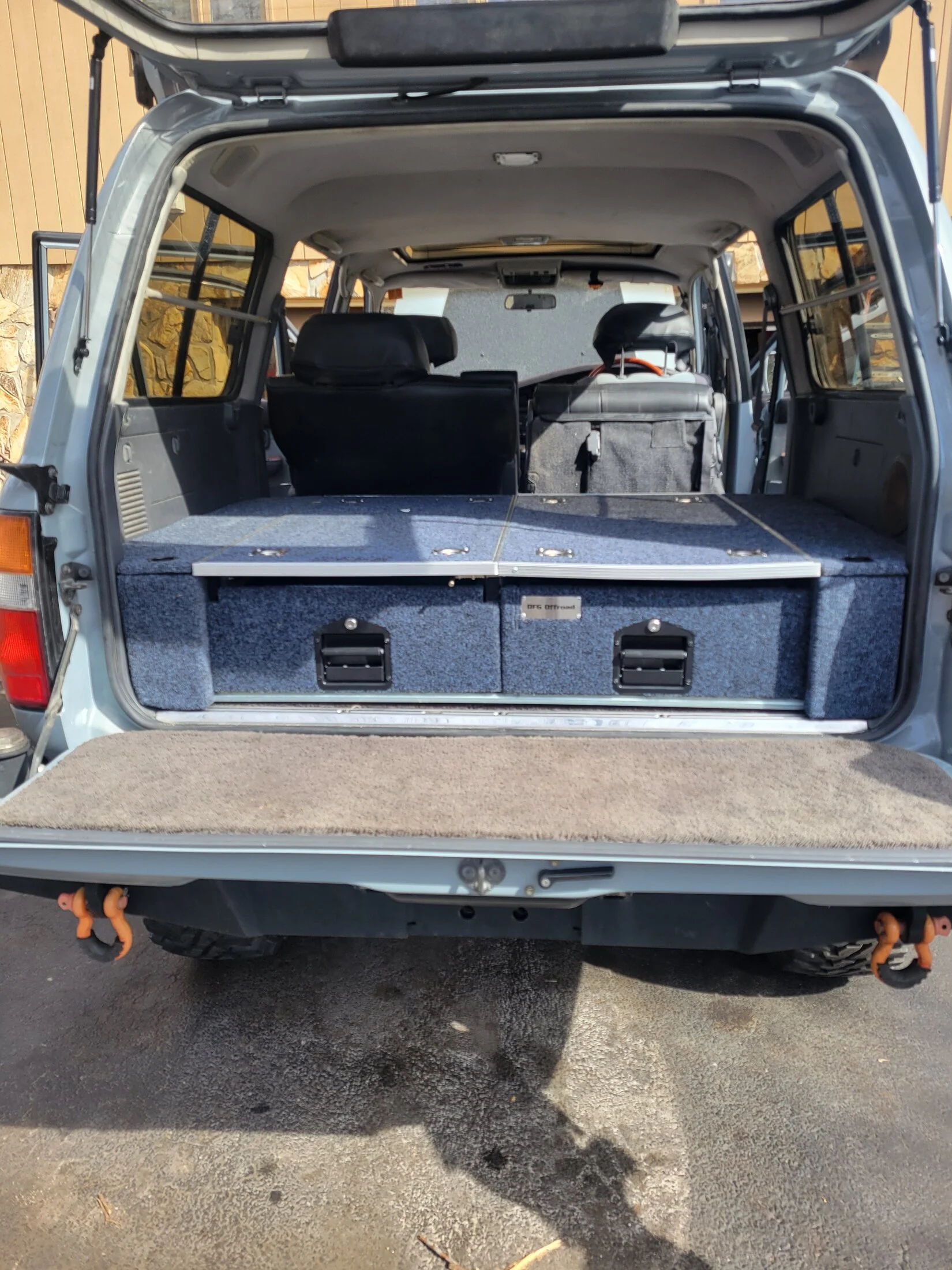

- rear cargo drawers

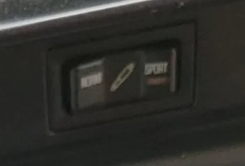

Hey @Beach80 what is this?
Probably JDM awesomeness but I have never researched it.
I put a blank in mine for now. But kept the switch in my box of parts.
