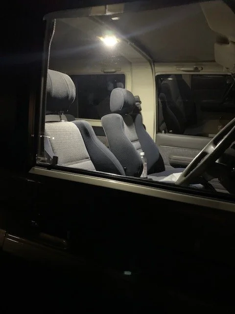

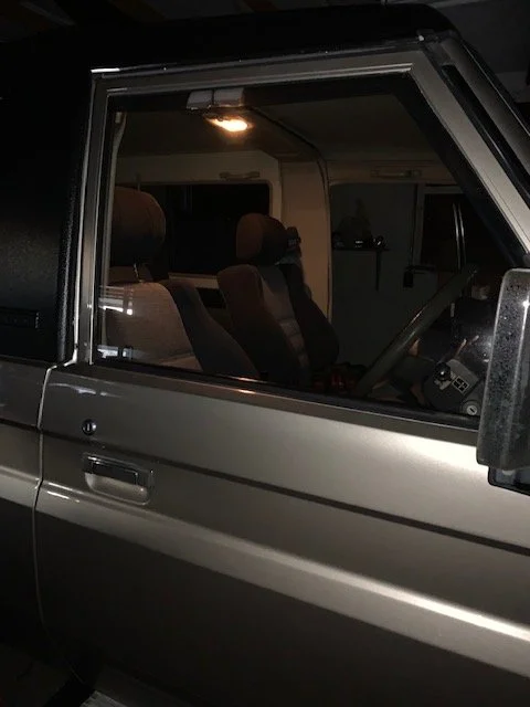

Replaced reverse lights with LED bulbs from Odd Iron
Later this week, I'll get to the rear diff, trans, and x-case, as well as mounting the sweet cupholder from Odd Iron.

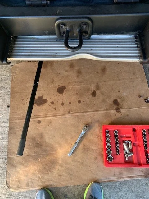

Completed more baselining today
Drain and fill of transfer case (Amsoil 75w-90 ~2.3qt), fill plug (90341-18006), drain plug (90341-18057), and gaskets (90430-18008 x2)
Drain and fill of transmission (Amsoil 75w-90 ~5.1qt), fill plug (90341-18006), drain plug (90341-18057), and gaskets (90430-18008 x2)
Drain and fill of PTO drive case (Amsoil 75w-90 ~1.7qt), fill plug (90341-18006), drain plug (90341-18057), and gaskets (90430-18008 x2)

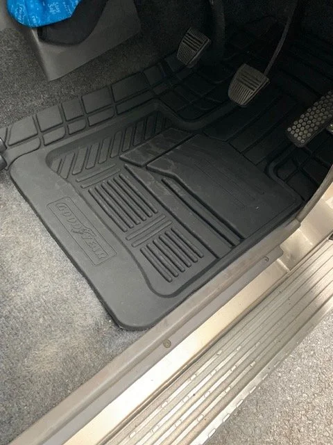

Found some interim floor mats at Auto Zone; Goodyear D9104NRBLK on clearance for $20. For the price, I'm quite happy with the fit and quality.
Driver's Side
