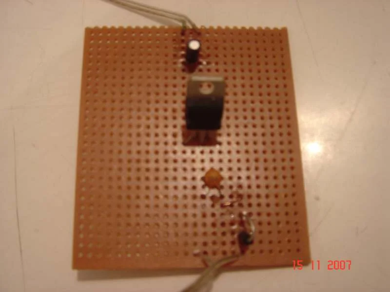

Extremely sorry for the bad pics. But I just don’t know what’s wrong with my camera.
Looks nifty, little hard to make out how you connected everything.
But what is important for the capacitors to work properly is that they have to be as close to the regulator as possible.
To be honest, for my LM7812 setup I have not used any board.
I just bolted the regulator to one of the walls of the alu-box, bend the pins a bit away from that wall and soldered everything directly on the pins. Just wrap the leads coming from the C's around the pins (in the right way, the electrolytic capacitor -the large one- has a minus and a plus connection!). Do the same with the diode (ring away from the IC) and connect the leads. +24 V(input) to the left pin, +12 (output)to the other end of the diode.
Make sure the soldering rod is the right temp and solder has raisin core. Solder each point quickly, let the IC cool down in between each soldering point.
Middle pin = same as metal back = mass (ground) = connected to body/chassis therefore you don't necessarely need aq minus lead.
I made sure the leads where fixed so no strain can be excerted on the IC-pins.

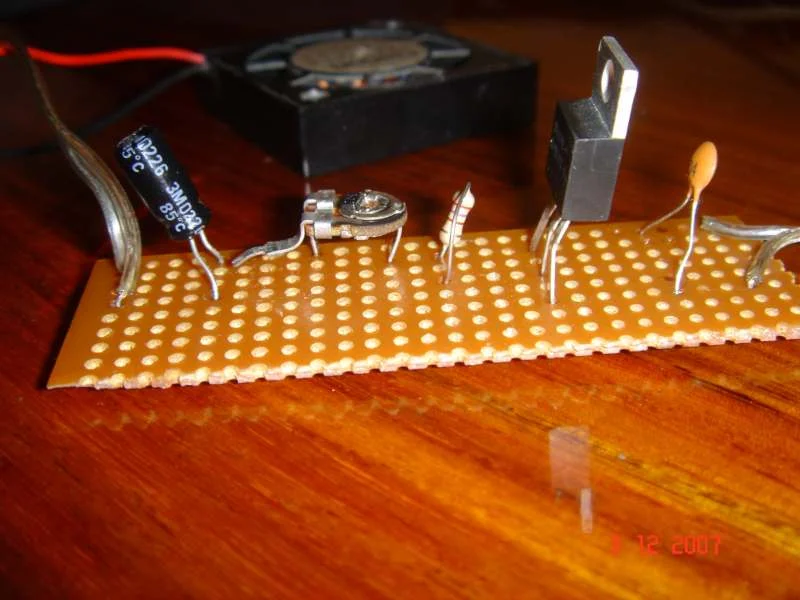

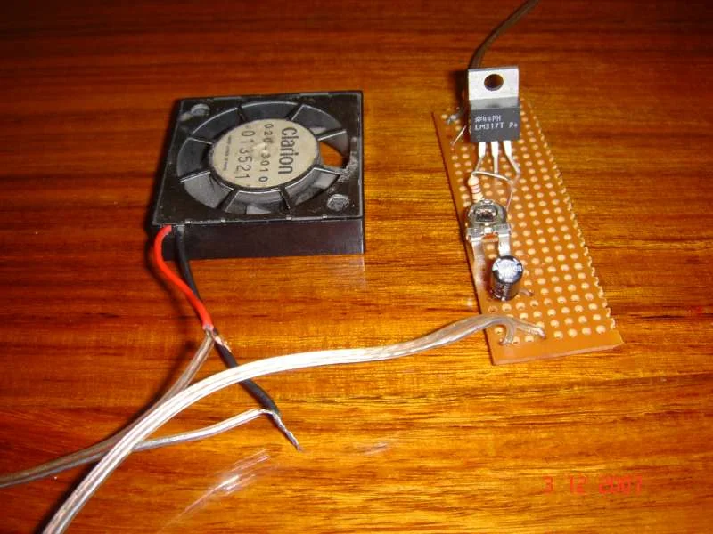

See the pic. Its LM317T (adjustable 12V regulator). You can see a variable resistor, I used it to increase the voltage to 13.8V. Even with LM317T, the amp draw is 0.271 with or without load:crybaby:. See the pic, I used a small 12V fan as a load.
Extremely disappointing.:crybaby:

Well, you have extra losses through the resitors. If you want to go this way (using an LM316, I mean), use a combination of resitors with the highest values that are usable.
You are using a 180 Ohm resistor with an 2Kohm (?) variable resistor here. Try something like 1k5 resistor with 20K variable. This might improve (reduce) the draw. The current for the adjustpin should be in the 50 - 100 micro(!)Amps. Hardly measurable with an ordinary multimeter. ;-)
Ok now I know you are an electronic-wiz.
270-ohm resistor with 5k variable resistor. OK I will increase both and see what happens.
I used LM317 primarily since I had them lying around. It is strange but I am not able to get quality stuff.
