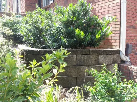

Hi guys I have got a slightly musty basement in one corner of the daylight basement in need some suggestions on how to dig out in area that's about five to six feet deep and then what waterproofing products to consider. Obviously I will need to add a French drain and coat walls with a good product. I have used thoraseal in past. Key question is how to dig out. I have water pipe, sprinkler popes and possible gas pipe to deal with in a tight area. Do I use a large post hole digger and trench a 2-3 foot wide area parallel to foundation or use a small excavator? Thoughts suggestions?

I don't know. It looks like the land lies such that water should drain away from the house. Are the gutter functioning properly? I believe you can apply thoraseal to the inside of the wall and expect good results. Before I'd dig, I'd try to get the water away from the house and coat the interior of the wall. Otherwise, you are talking about removing the retaining wall and landscaping and digging down to the footer. Please, if you do this, shore up the dirt wall. Many people die every year in collapses in holes like this. Anything over 4 feet deep should be shored.
One think I would like to know is how wide the overhang from the top roof is over this area...one foot?...two feet?...
If it's one foot overhang, my inclination would be to dig along side the house, probably about 16" deep by 12" to 16" out from the foundation. I would then line it with plastic (6 mil) then fill it with pea gravel. I would pitch it to corner of that block planter (not the inside corner, the outside corner, and I realize it's rounded...just get as far from the house as you can) Dig down in that corner with the post hole digger and fill that with gravel to below grade of the block wall.
Then..I'd dig below the block, being careful not to undermine the structural integrity of the wall...in essence what you're creating is a "natural" drainage ditch, with the help of plastic and gravel....a natural gutter to force the bulk of the water and direct away from house foundation. The further you lead the water away, the drier hopefully it'll be.

I assume that the brick veneer on the front of the house extends down to the natural grade ... if so I'd replant the bushes currently in the "planter" formed by the retaining wall and remove the retaining wall and fill. If this solves your problem ... quit there. Not sure where you are but if you get freezing weather then that earthen berm created by the retaining wall will eventually cause spalling of the brick work .. at least near the surface and a few inches. In any event any water in it will find its way through the brick facing eventually and leave it perpetually damp.
I'd also be poking around that downspout .... its pretty suspicious ... could it be moved to other end (right) of that trough
You could empty the planter, dig it out and heavily coat the house wall. But that sounds like too much work. First I wound redirect the downspout to the other side and down the hill. I would drill some holes in several blocks to drain the water away from that planter. With all the rain we have been getting this year, these new problems start to appear. Are your gutters clean? If not the water could be overflowing onto that area.

THe planter area has to get dug out and wall coated and french drain added.
The gutter is not a problem as it is routed 6' away from foundation and on a slope.
THe biggest challenge is how to dig out, by hand or maching or a combination of both....
the water line, and sprinker lines are likely going to need hand digging , but a stump (not pictured) in planter area is going to be a bear to get out as some of the roots may be in the area where we are going to have to dig....

You are stuck doing by hand and going slow if you are going to remove it. I'd remove the planter wall and then dig it out. And leave it off or make it a lot shorter.

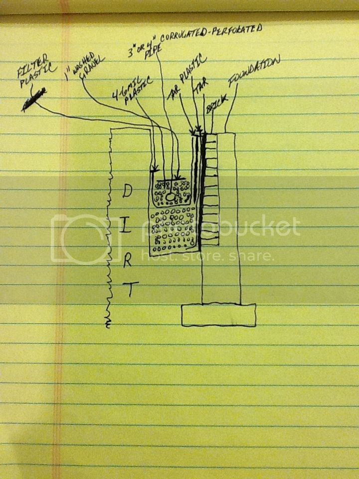

It was good talking to you this morning. I hope things made more sense than my post. Here is the ( crude ) drawing I told you I would post. Like I said, feel free t call with anything else. don't work too hard on it.
Matt
Matt,
THanks for the detailed picture. Gotta luv mud for connecting experts. This is going to make my job a lot easier. looks like I will get the 13yr old on it with me and work on it over the last few weeks of summer.
Matt
Matt .. wants to add my thanks as well ...your notes are VERY informative and I intend to apply some the instructions you have thoughtfully provided...THANKS!
No problem. Glad to be of some help and put backnto the MUD community. I will work on getting my photo bucket pics back up in the next few days.
One more note, try to use a winter grade roofing tar. It will be more plyable.
