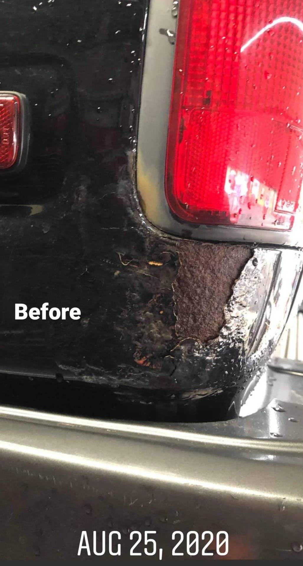

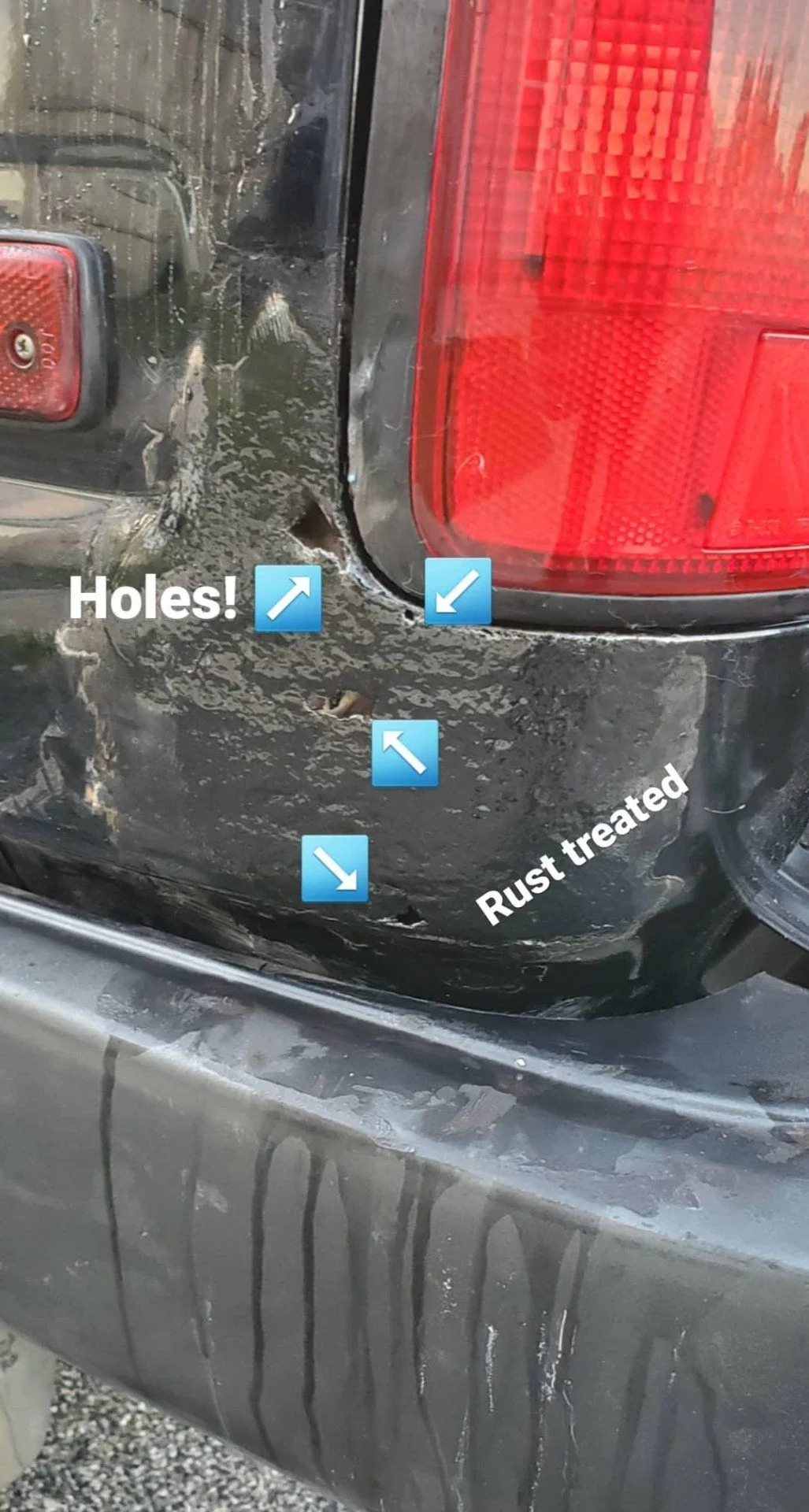

Hey AL I am in a similar boat but with less rust. I recently started repairingr tail light when I saw my inner rear quarter panel on both sides are shot. I am considering cutting them out and trimming the bottom, does yours suffer from that regard? How do you plan to tackle the surface rust in the undercarriage?

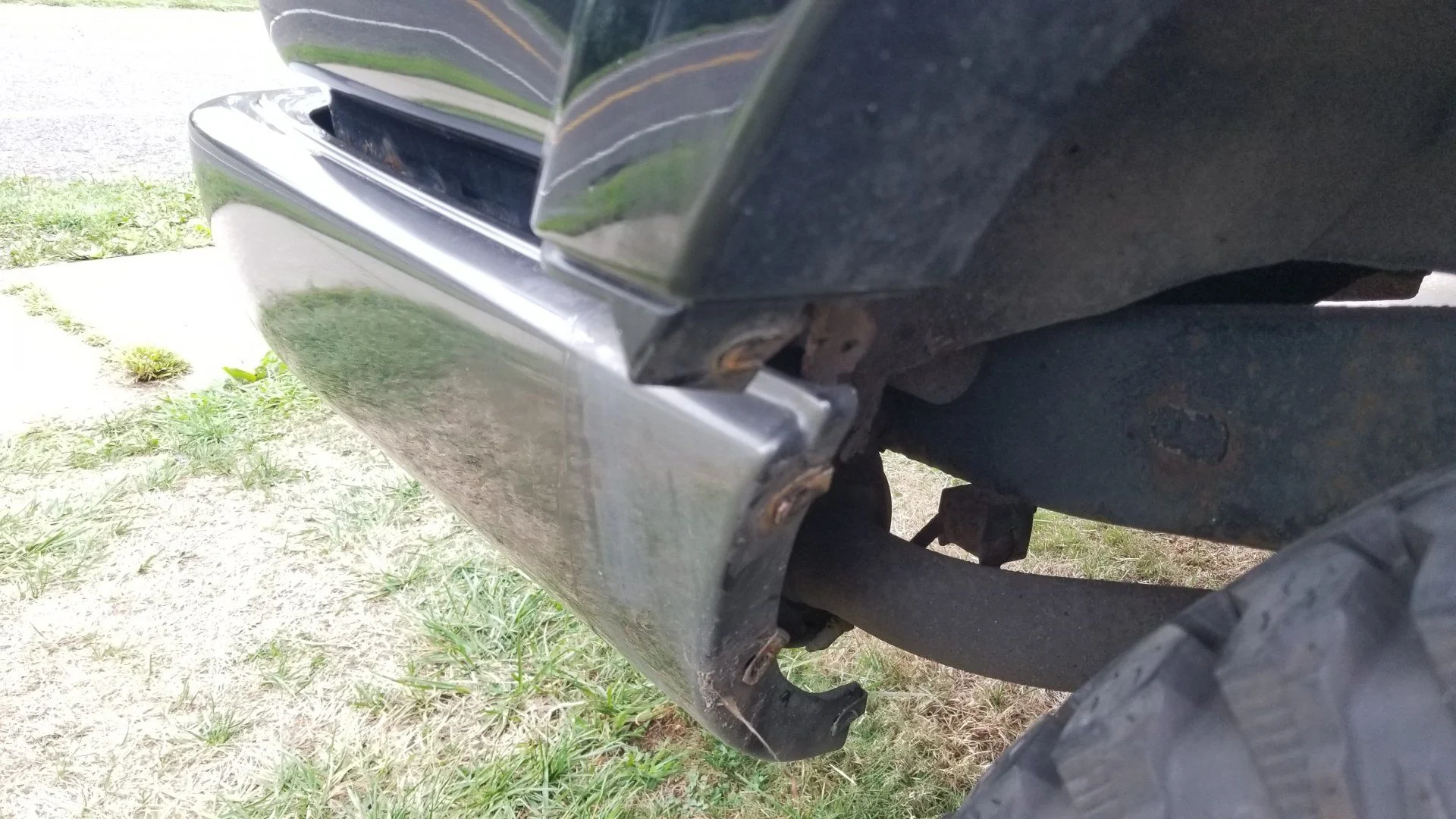

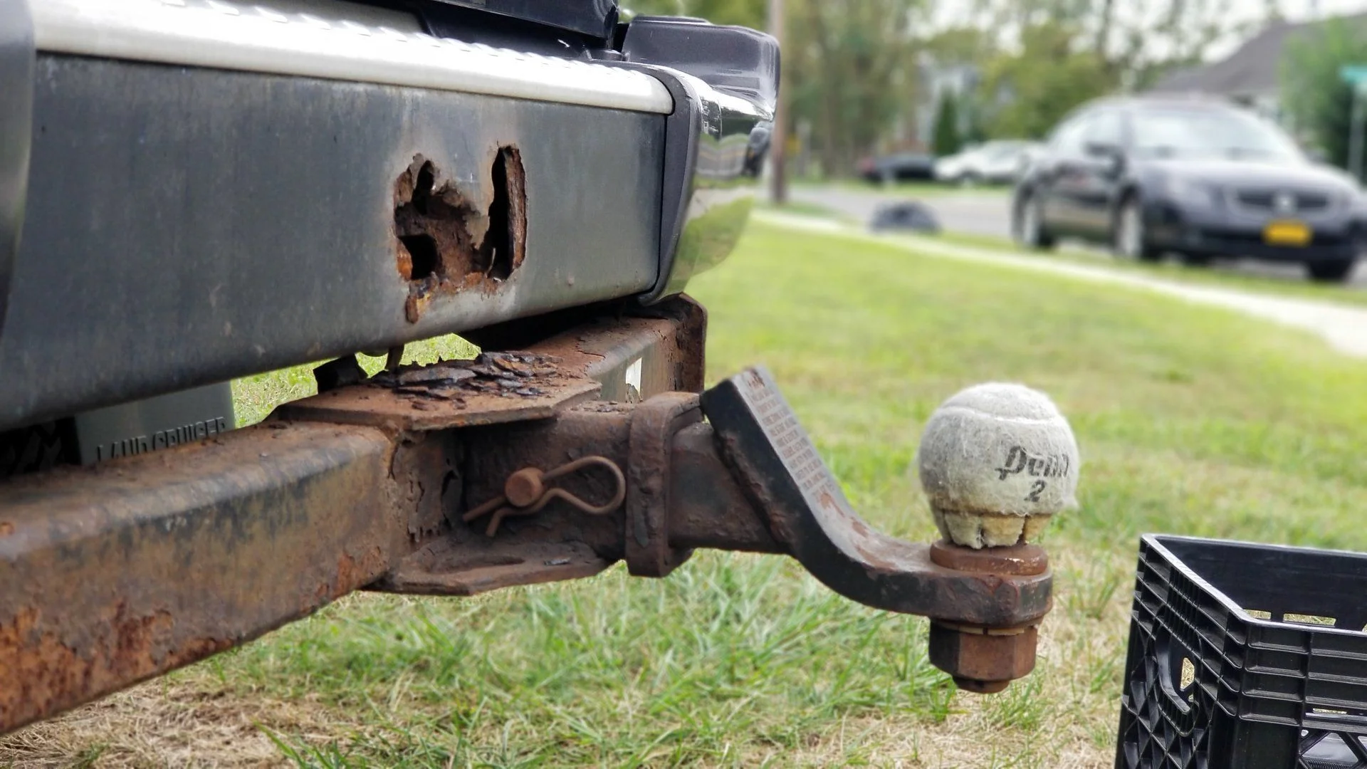

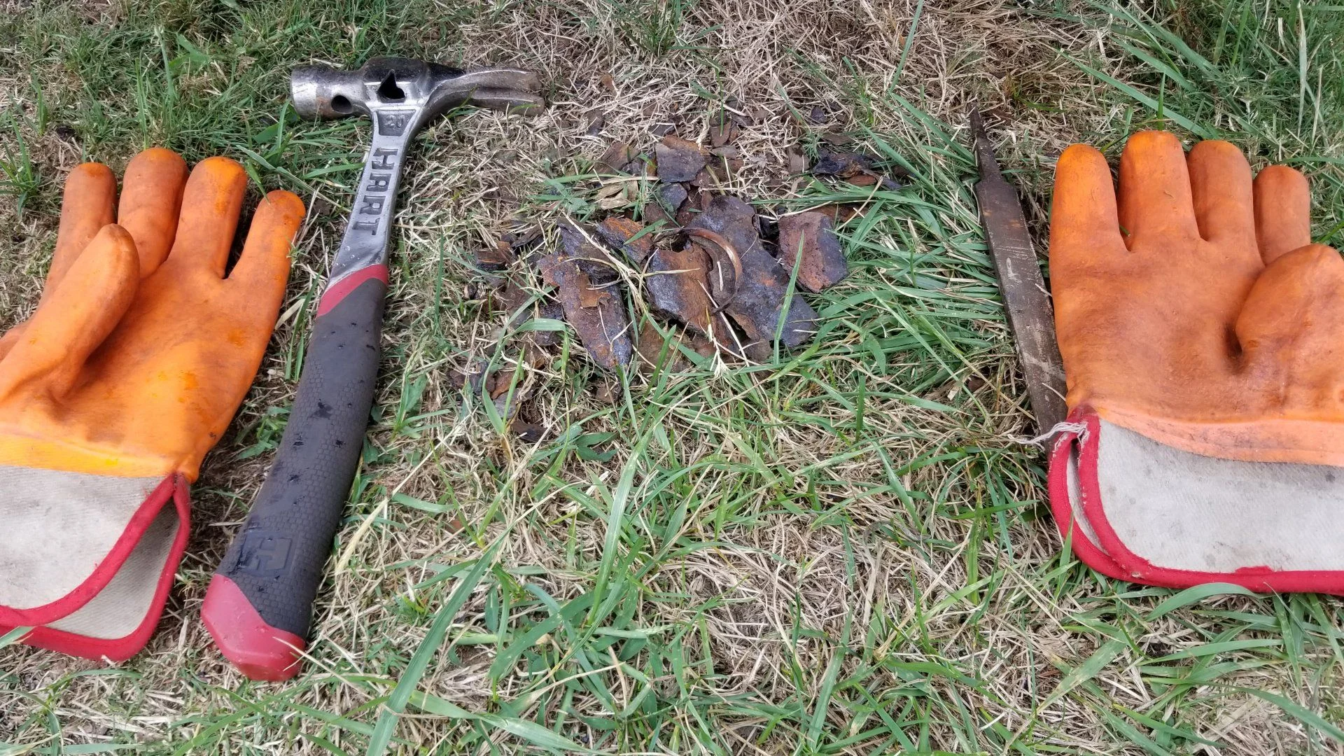

I saw my horribly disfigured mudflaps,.,.I became enraged and also decided at that moment how I was going to deal with the rust on my hitch/bumper/everywhere, and broke out the Hart,.,.take a look lmao
Maybe 1000grit can clean things up..
Let the bodies hit the floor!
I hate my bumper;)*twitch*

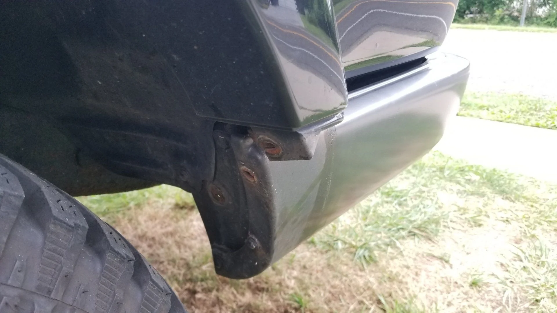

I guess I'm on my way slowly to that deflair

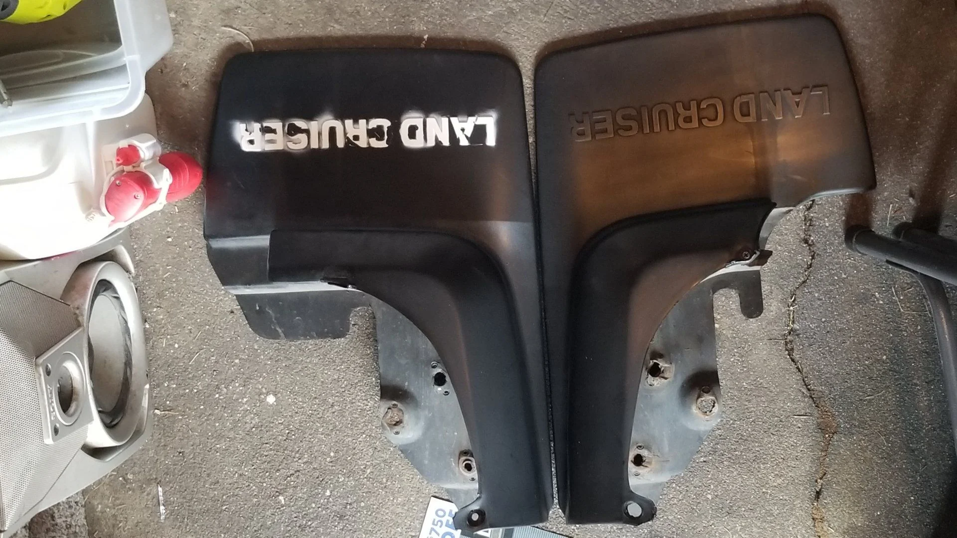

Damn looks like the mudflaps were holding on the bumper,.,.yay!:D

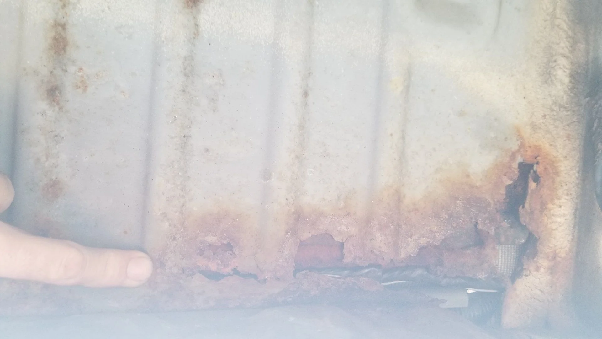

but from what I'm seeing here, it's looking like I should gut the interior to see if I have any rust hiding under the carpet. I do have some rear rocker rust to address (PO attempted a fix) as well as the rear axle / spare tire undercarriage area. Don't think mine is that bad, but still want to address sooner than later.

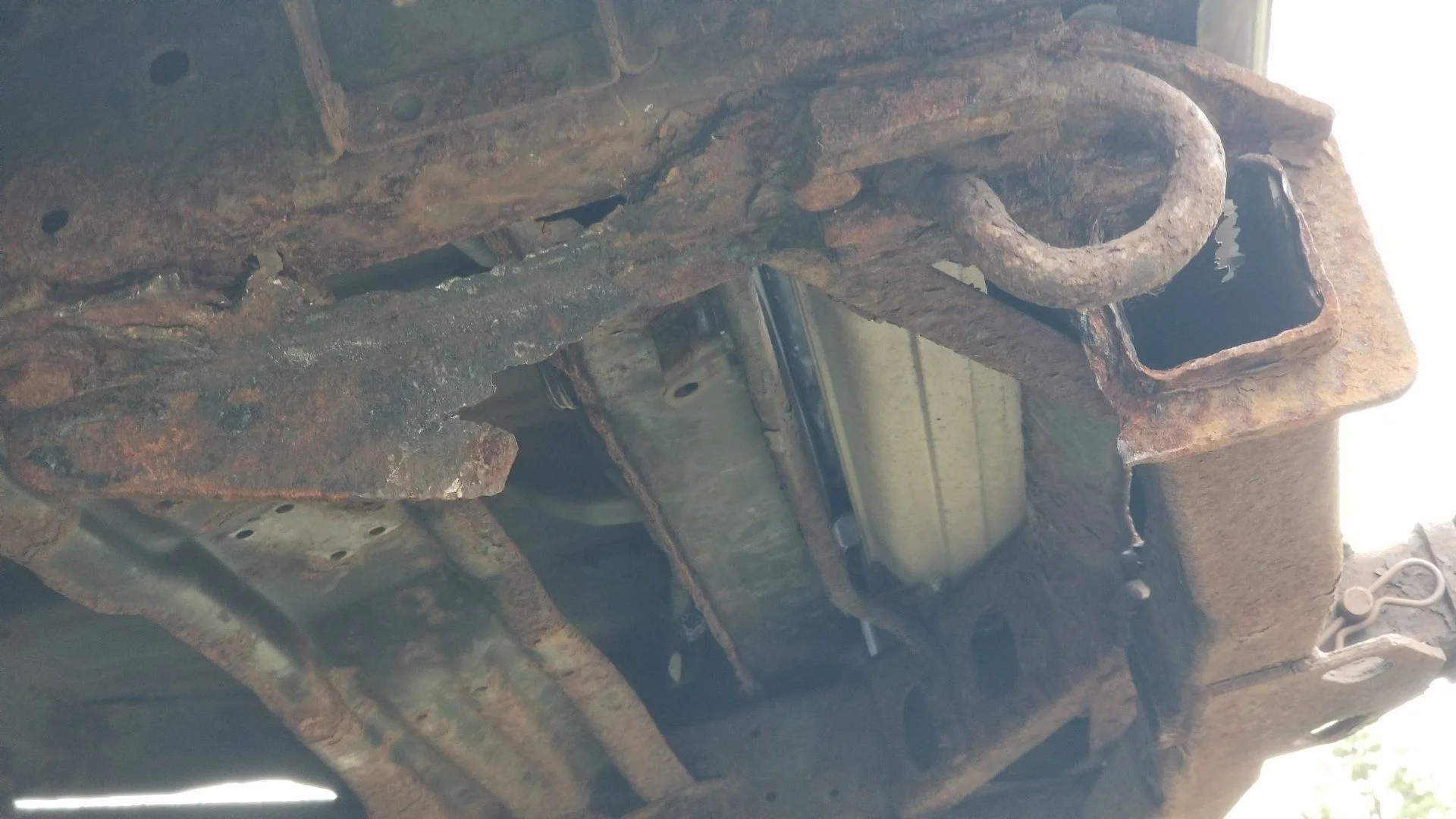

I'd start again with the carpet, in terms of rust hunting I found spots in the driver and passenger foot wells, the one in the driver isn't pretty
Will be very interested in how you will decide to freshen up your undercarriage (one piece at a time)

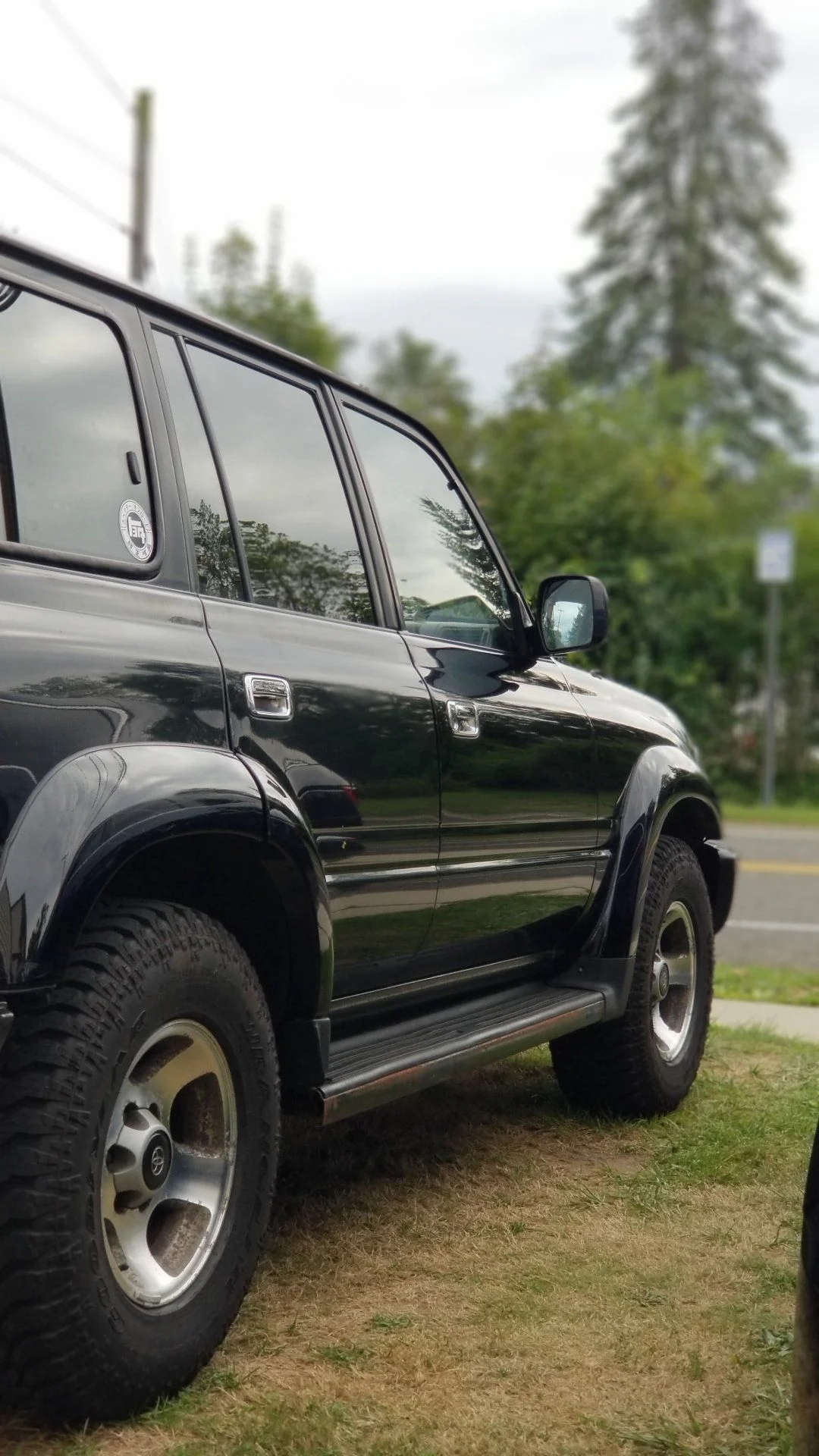

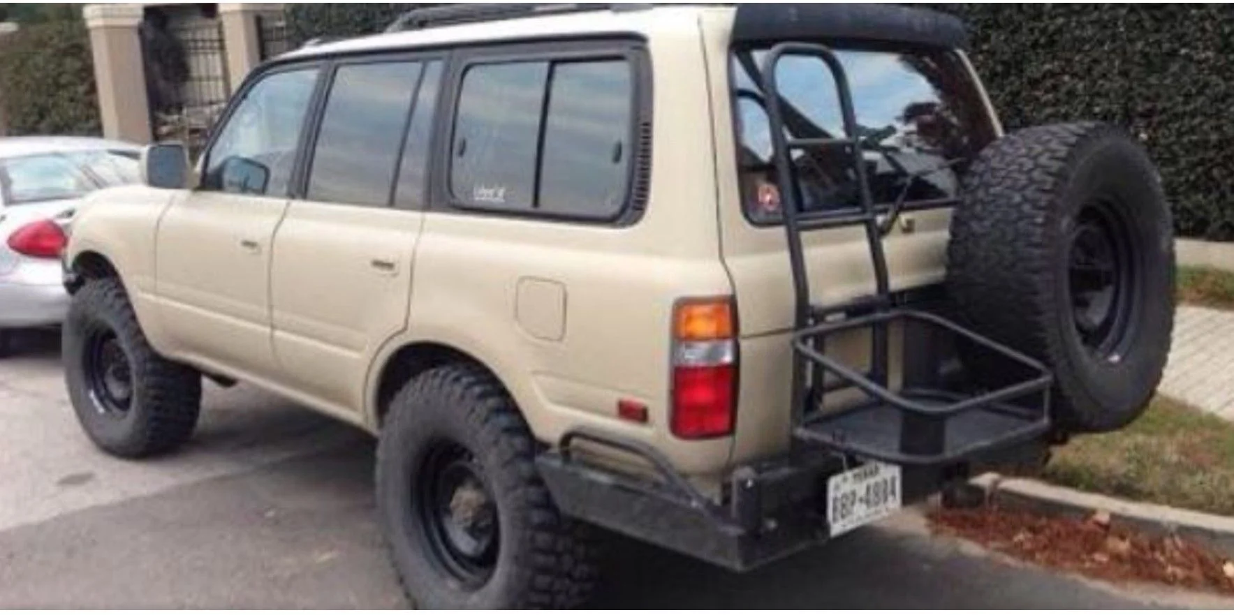

I prefer the de-flared look as well as the added clearance and ride height / visibility...just my .02

I'm really leaning this way too!
Then I don't have to buy that stupid factory running board as much as I want to be that Fatboy landcruiser it's the right move to de-flair and get some solid af rock sliders!!

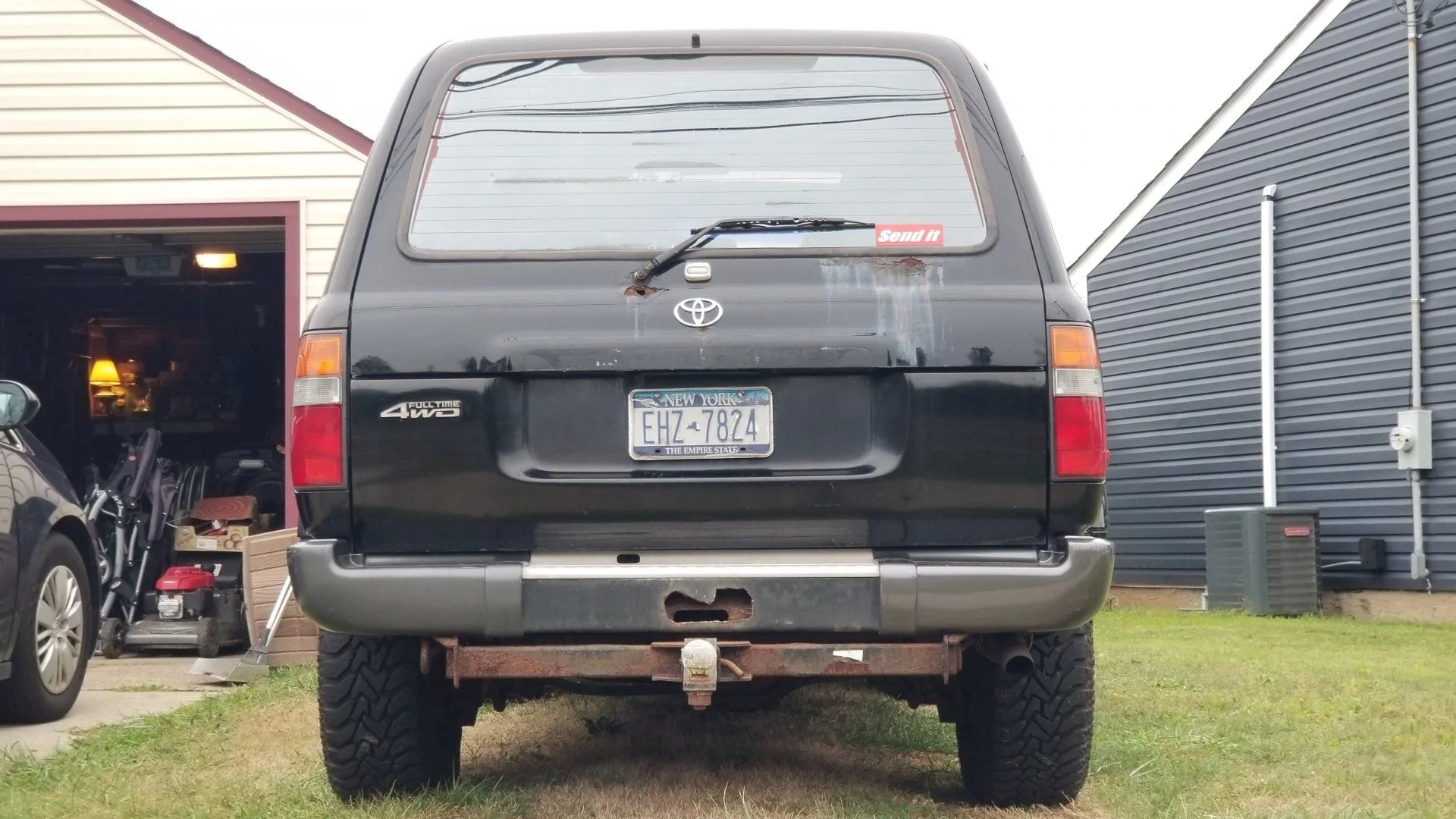

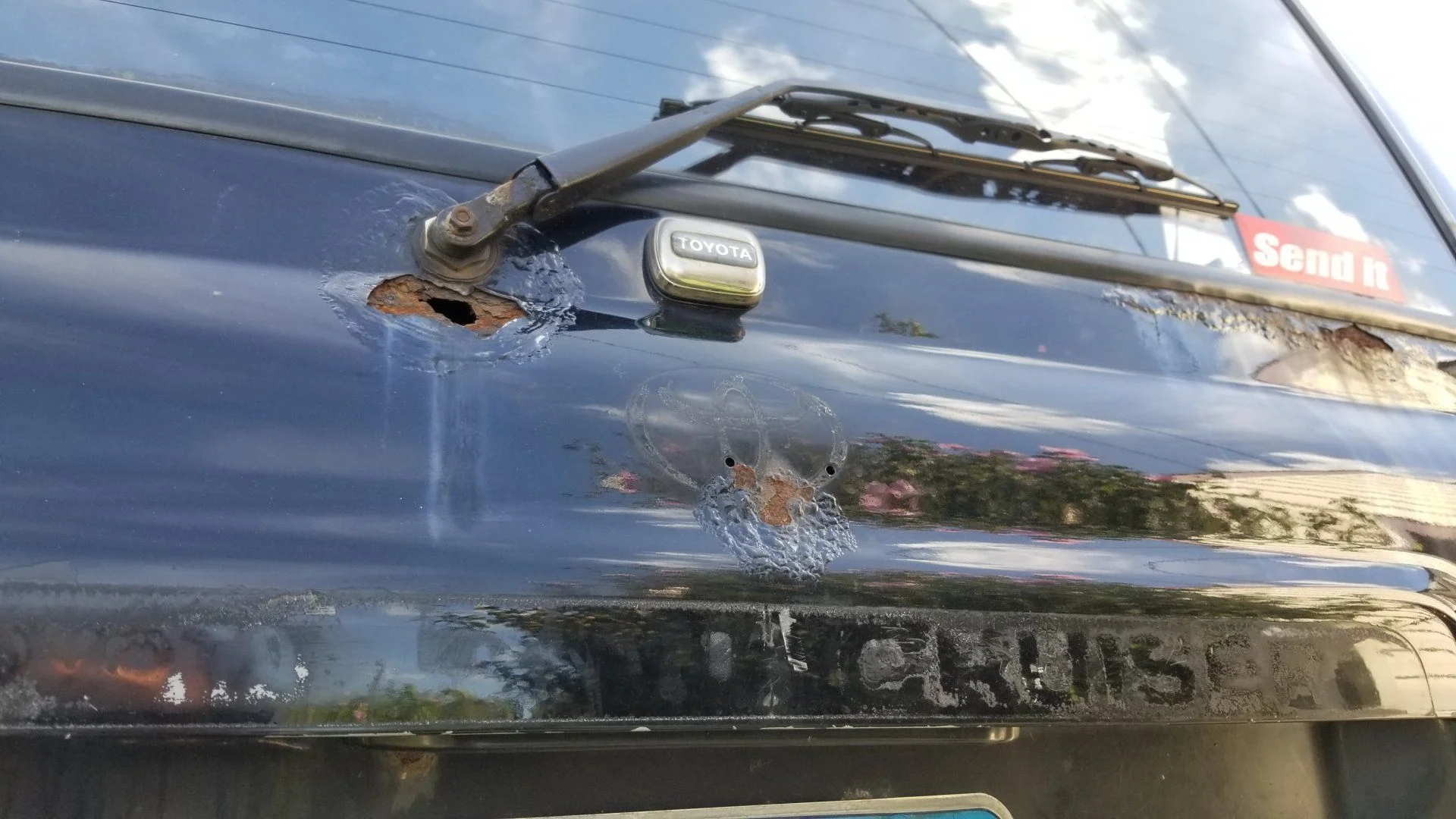

I have the same rust coming through the trunk floorpan near the wheel arch,.,.I dare not pull those rear lights,.,.I'm taking my mudflaps off in fear they will fly away one day,.,.love those suckers ,.,.trying to repaint logo on em! o_O
As far as dealing with rust,., I'm avoiding it and replacing panels instead as often as I can. Example 1 I'm buying that rear trunk hatch, mine is a near corpse, r.i.p. my rear wipers function lol I have a gaping hole below the spot where the wiper bolts in, and of course the spot under where the blade rests! Lol rust! Because rust
I hate to open a can of worms buuuut have u looked under your flares?...
I'm afraid...lmao
Actually I love the how the truck looks w AND w/out em! I'm torn,.,.but curiosity will probably get the better of me and I'll take em off and hoard them away on my top shelf!

Cry with me on this one guys, no emblems ,.,."send it" is right ,., damn
Haha mid west cruiser and yeah I poked all under there, and it's a headache instead of replacing the entire quarter panel I'm planning to nip tuck and cut the bottom right out. For light I tried my hand at Bondo to fix the holes looks like s*** up close but it did the job.

I showed him the B Pilar and rocker again and he agreed it was the most pressing issue for me RN...Besides performing some regular maintenance on the diffs, topping em up. I do have the standard PHH and heater control valve,.,. Belts look great, hoses too! PO's only credit to his name is the new radiator)hoses and the tires. Original owner babied the s*** outta that thing,.,.guys,.🤔🤔🤔

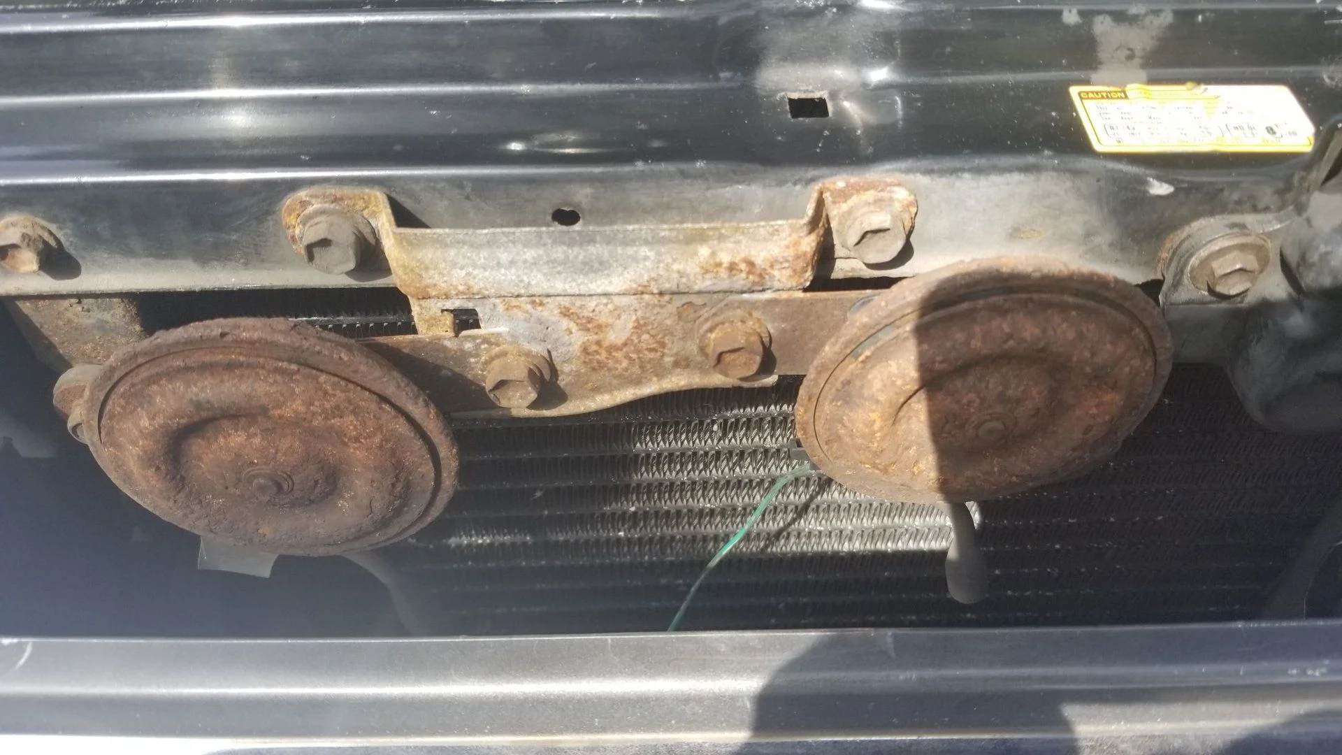

My horn sounds,.,.funny

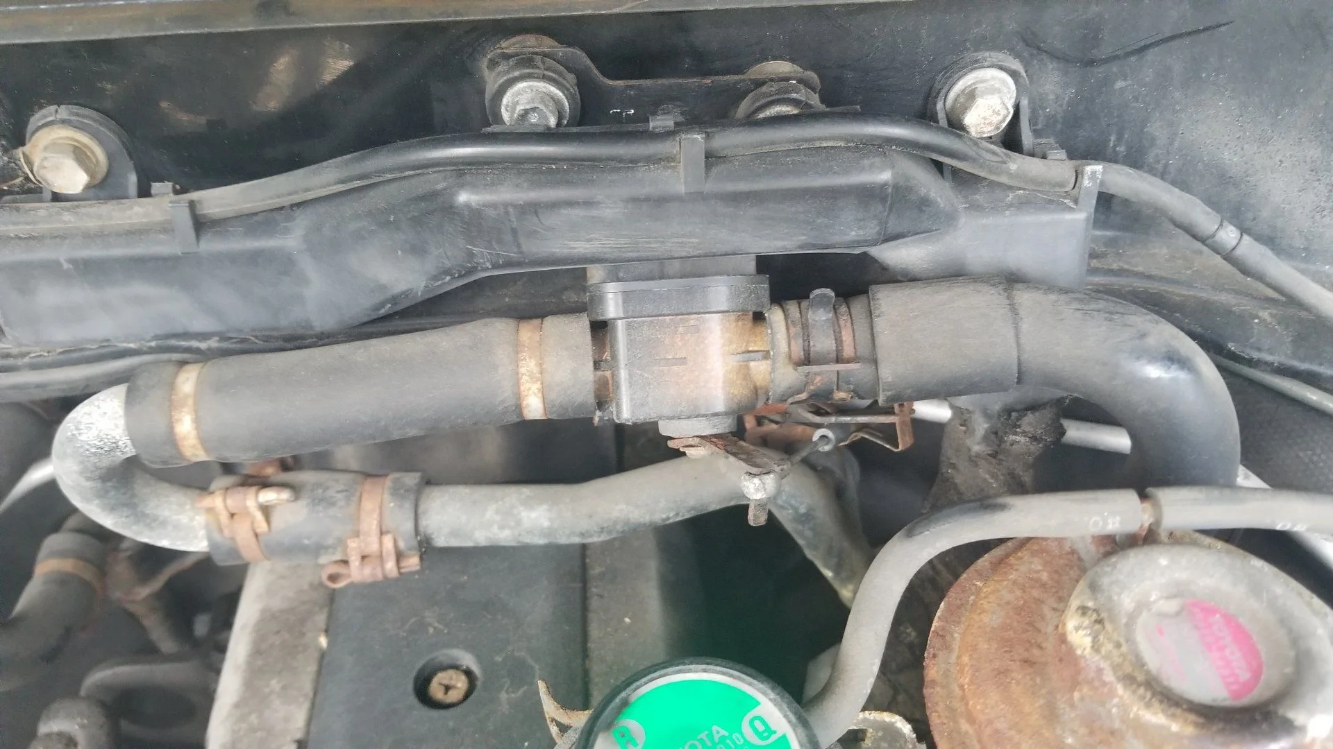

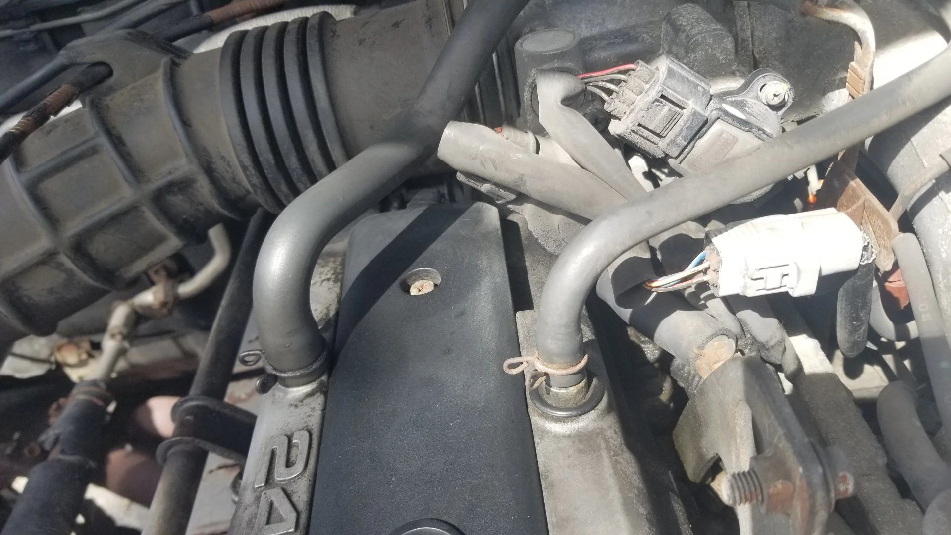

Pcv, just do it?
Looking pretty discolored and one hose bulging... Only a matter of time... This job should be near the top.
Opinions?

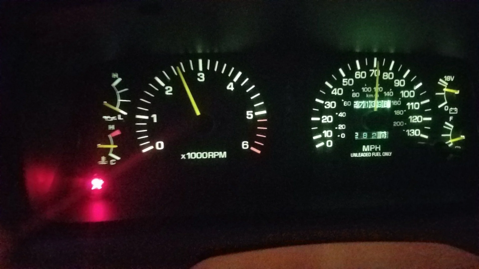

Oil guage is out... Went intermittent then dead
Need to install new airbag sensor sitting on shelf. 2,500 RPM @ 70 seems pretty good!

Pcv, just do it?
Opinions?

Yes, just do it! 80 Series 1FZ PCV Valve Kit and 80 Series 1FZ Curved Heater Hose Kit. HPS makes a silicone hose kit if you're into kinky stuff.
