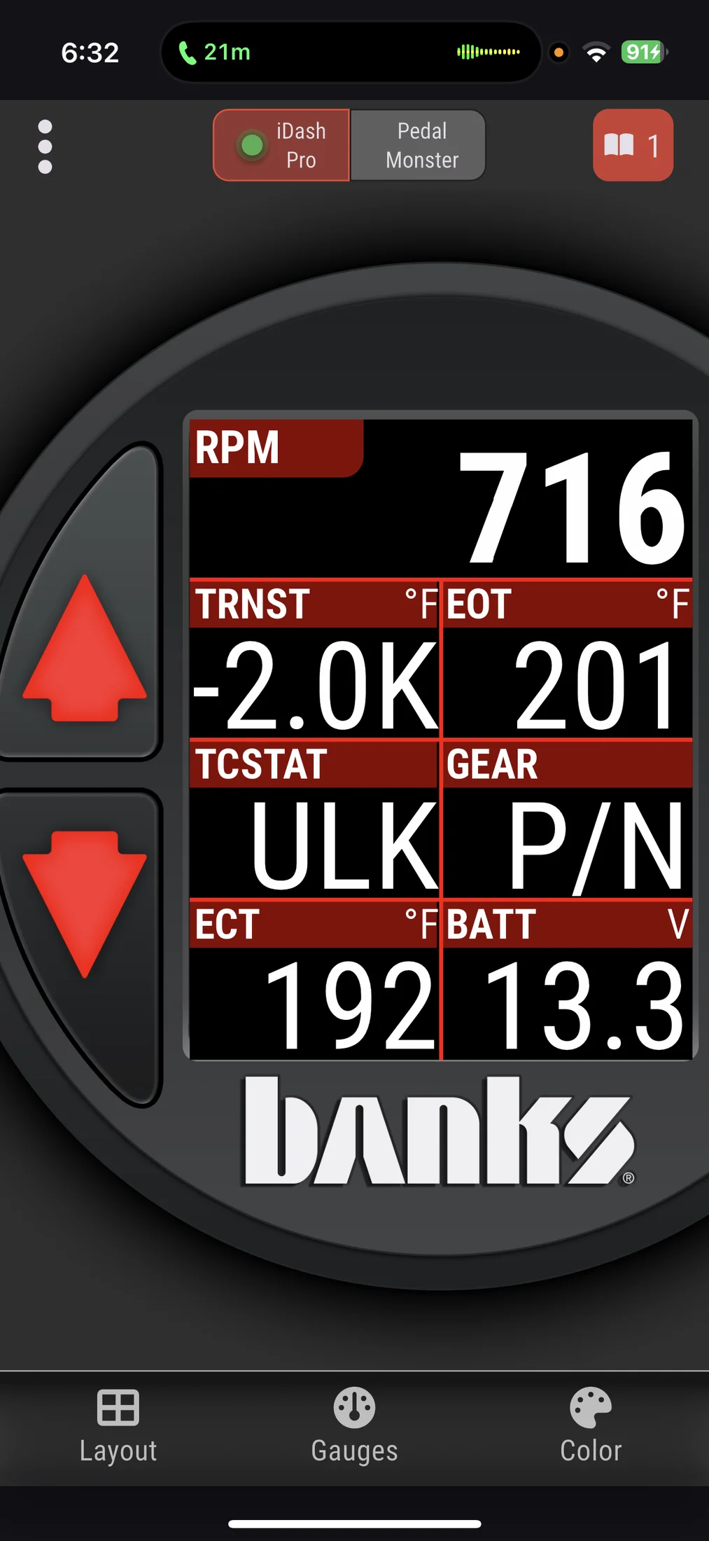

Hello everyone, on my last post, I had mentioned that I had requested an RMA from Banks Power, that afternoon Banks Tech-support called asking me to test a beta firmware that they were hopeful it would resolve the problem described above. I tried it and thought it didn’t completely fix the bug, I can report that the iDash Pro is now reading trans-fluid-temps that are spot-on with my XTool D7W scan tool and with the Torque Pro app. However, there is still a bug with the software that they are working on. At soon as my transmission reaches 190°F, the iDash throws an error (-2.0K) for transmission temp, and the instant the temp falls below 190°F, the iDash goes back to displaying correct temperature readings.

Update: today I tested beta firmware 1.06 from Banks and I’m happy to report that they have fixed the problem with the iDash and Toyota/Lexus vehicles. They should be releasing the official firmware update within a few days.
I'm seeing the same from my end. I tried Beta 1.05.05 first and temp was way off, showing single digits. Then 1.05.06 read correctly until 190 F as you mentioned. This new 1.06 seems much better now.
