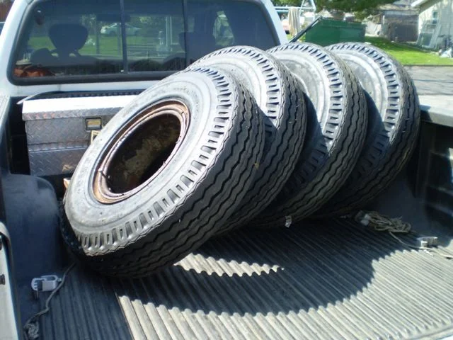

Got the new meats today. :D
Took 4 men 2 hours to beat them ol' wheels apart and mount 'em. :eek:
Once the wheels was apart, they took a wire wheel to 'em and cleaned 'em up. 3-piece wheels are part of our automotive history. There was only one old fella in the shop that had ever even messed with 'em.
They made it quite clear they didn't ever wanna see me again. :grinpimp:
8.25 x 15, 16-ply, rated for 4000 lb. each.

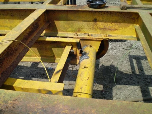

Torched the tongue free of the axle.
Now the tongue lays flat against the bottom of the deck where it'll be gussetted and welded solid ... creatin' a normal trailer. :hillbilly:
Once I take a buttload of measurements, we'll unbolt the axle to prep it for the suspension parts. :D

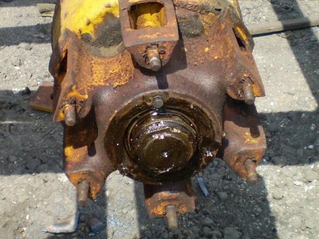

Tryin' to get to the brakes. Unbolted the cover plates on the end of the axles and found some big-ass nuts. Reckon we'll take them off next and see what falls out. Also some bolts on the backside of the hub that mite have somethin' to do with somethin' ... ain't sure yet. :confused:
Got 2 wires comin' out for the brakes on each side. Reckon one's a ground??? Thought brakes only had a hot wire. :hhmm:
[Editor's Note: This here would be a great time for a lil' advice from somebody that mite know just a lil' bit 'bout this s***. :grinpimp:]

one is a ground and one is a positive but most trailer brake manufacturers do not even label the wires.
Reason: it is an electo-magnet and polarity does not matter just put a neg. and pos. to it and she will work..... if the magnet is good.
cam:flipoff2:
Thanks Cam ... coarse the CoonAss claimed he knew that the whole time. :rolleyes:
... so I tossed 'im in the middle of the trailer and hooked up some jumper cables to the Trusty Ol' Comp'ny Truck ...
and I'll be damned ... brakes work fine. :cool:

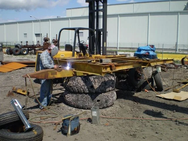

Brought the welder in early with me off the dredge so we could make some progress ... project here's windin' down ... runnin' low on time.
He made short work of weldin' the tongue solid to the deck. Redneck can burn some rod By Gawd. :cheers:

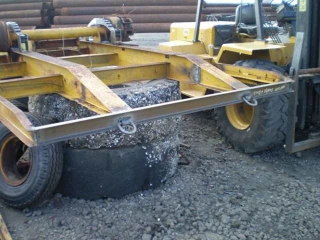

Got the new brace 'cross the ass-end ... :cool:
And there ain't nothin' worse than not havin' no place to tie s*** to on a trailer ... so we now got us 12 BIG d-rings. :clap:

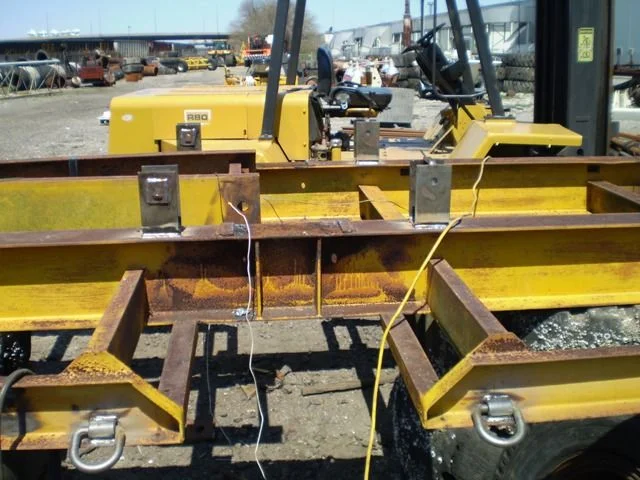

Suspension parts all come in today. :bounce::bounce:
We cyphered out the whole deal and tacked down the new spring hangers. :cool:
Tomorrow we gotta fab-up a coupla spring perches and then we'll cut the axle loose, wash off all the welds, and hang 'er. :cheers:

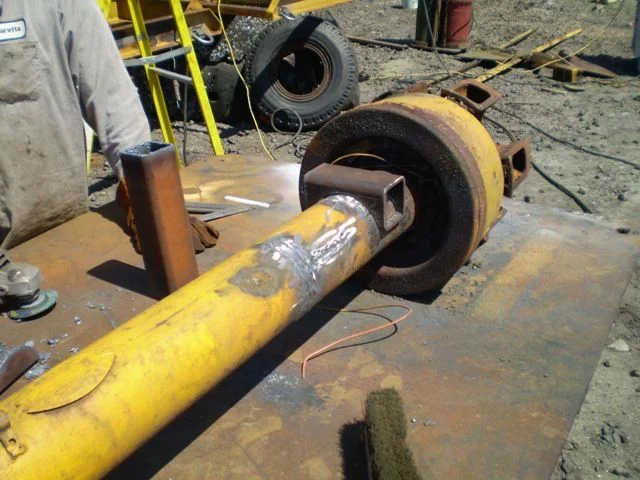

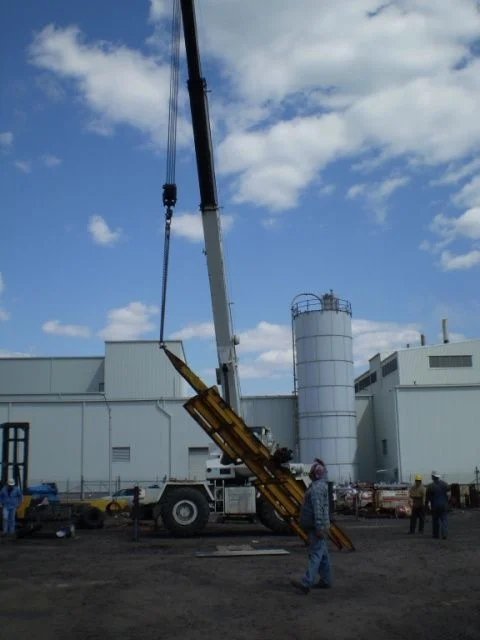

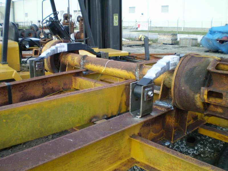

Past the point of no return now. Redneck got the axle cut off, cleaned up, and fabbed up some killer spring perches outta some heavy-wall square tubin'. Just ain't no substitute for talent. :cool:
