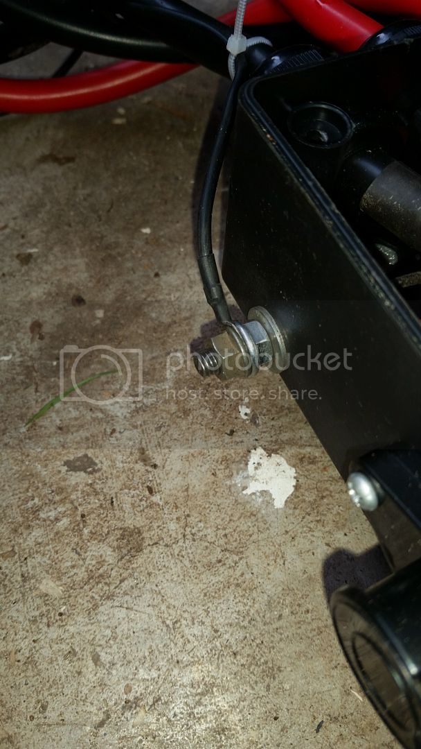

I found out, once it was all apart - that the wire on the side of the solenoid box (which is all plastic) had a nut on the other end that wasn't a captured nut. When I removed the small ground wire on the outside of the solenoid box, I inadvertently disconnected the ground wire internal to the solenoid box. Without it, the winch doesn't work.
I decided to reverse how it was engineered, so that if I get stupid again and decide to use that as a ground location for something else, I can do so without consequence.
I ran a larger bolt from the inside of the box outward (with the internal ground connected), with a washer against the box externally. I then used a nut, spun on backwards, with a 2nd nut run in and the ground wire between them. So now the bolt is bolted to the box, and then a secondary nut retains the external ground:
In this photo, the ground wire is on the left side of the box, upper corner:
Another angle:
From the outside:
All works well again in the 80......
