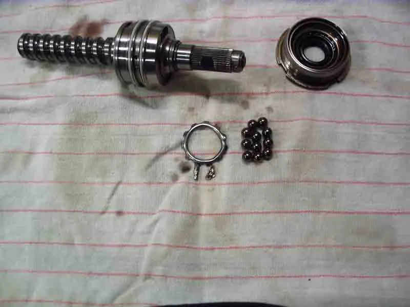

My power steering gearbox was leaking where the steering column attaches to the box.
I removed and disassembled the box and found that the worm gear bearing immediately beneath the adjustable cup is damaged.
It is a set of 11 ball bearings held together by a steel race somewhat like an old bicycle wheel bearing. The steel race has come apart.

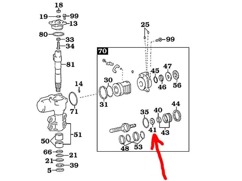

Does anyone know where to get this bearing - or an interchange? It's #41 in the picture. SOR shows "not in stock" and wants $51.
Thanks
90369-22004 appears to be the Toyota part number. ToyotaPartsDirect.com has it for $45, but if you search around, you might be able to find it cheaper.
EDIT: Check out toyodiy.com
