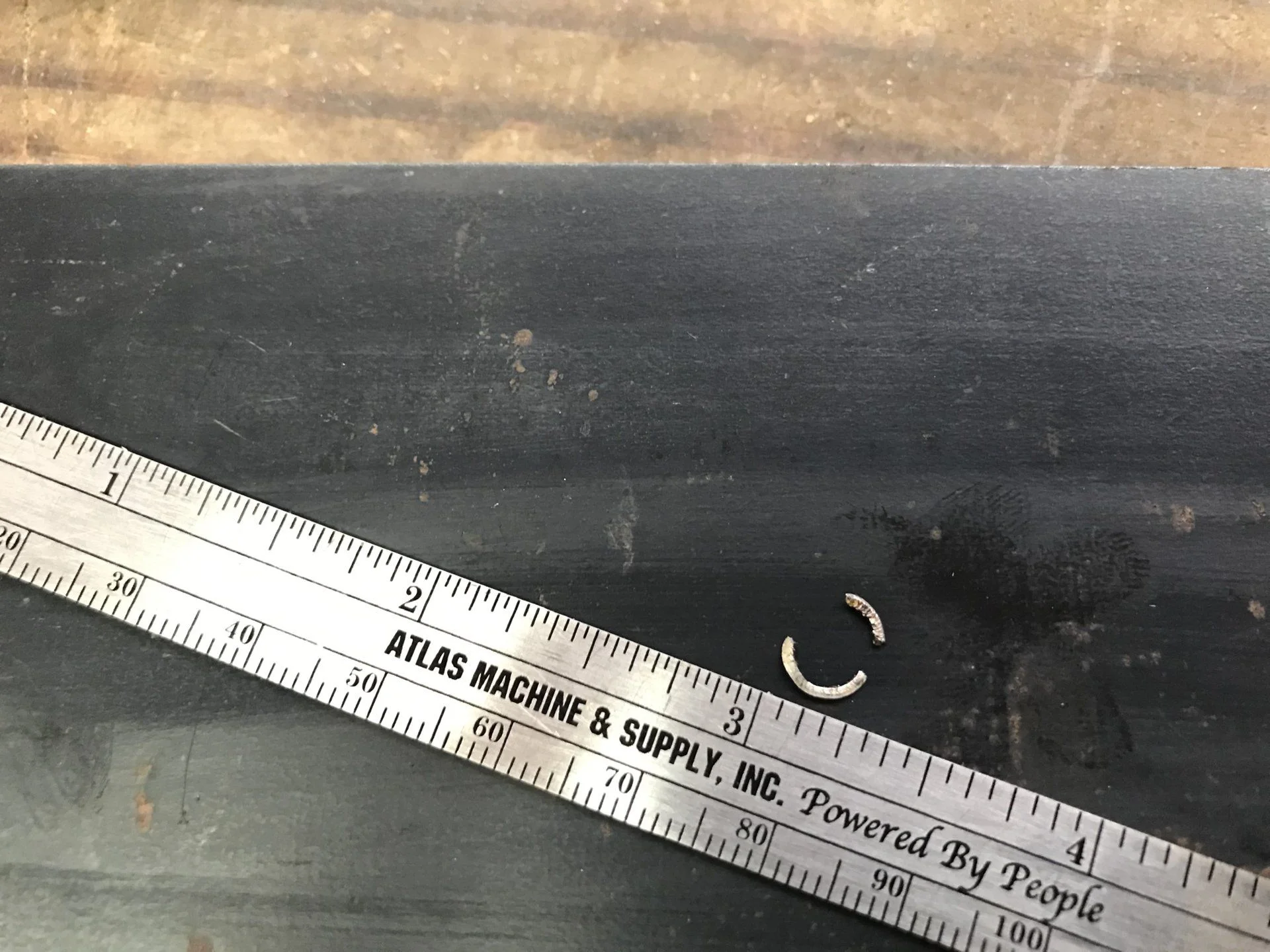

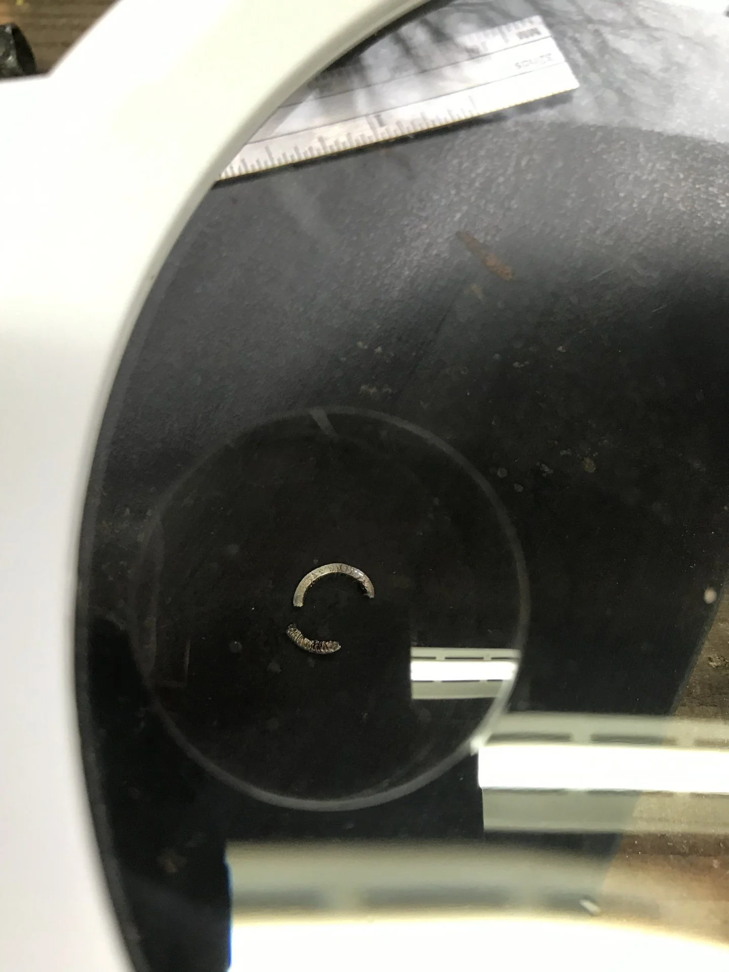

Hey guys, real quick. Im still digging into it. took the valve cover off and the oil pan. can really see much of the bottom end because of that plate covering. Is this just tramp metal chewed up or something significant and identifiable? It is non ferrous I'm just not sure what all is aluminum that would have been damaged.
Doing leak down tomorrow.
Thanks
found in the oil pan, btw. didn't have much in the filter. Glittery, but minimal..
