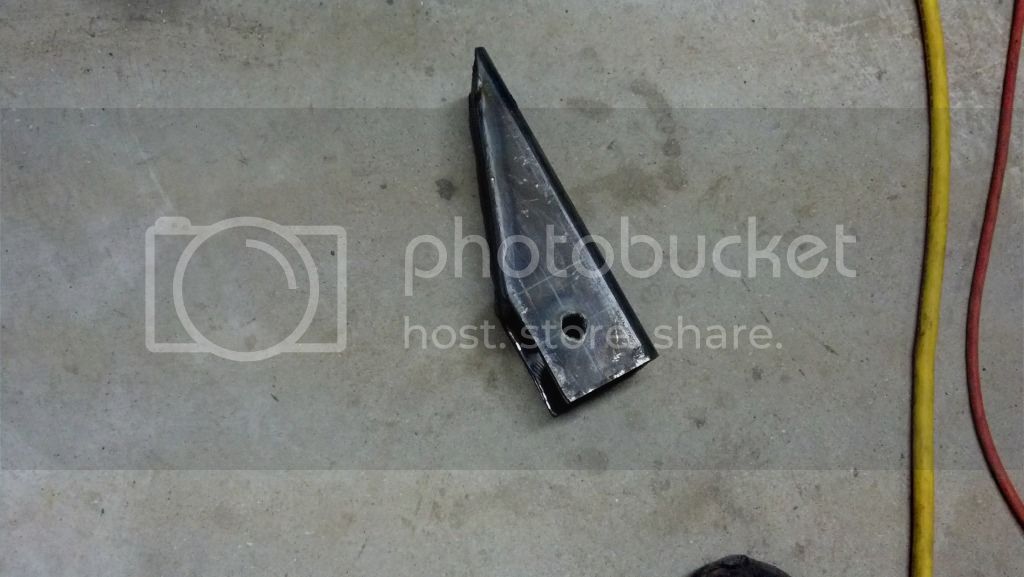

Homemade steering box relocation brackets...
Measuring...
Back together with out a front shaft and still rocking the s***ty Pro Comp rear springs. Ride is SOOO much better with the RUF over the IFS.

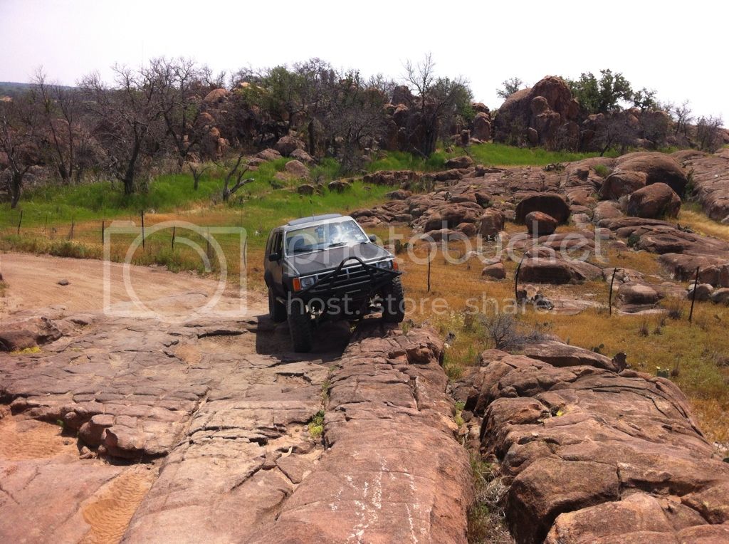

Took it wheeling....WAYYYYY better ride, and way better flex.
Super happy with the way it flexed...just needs longer rear shocks. Goal is to keep it low...so will be hard to put long shocks in the back without going through the floor.

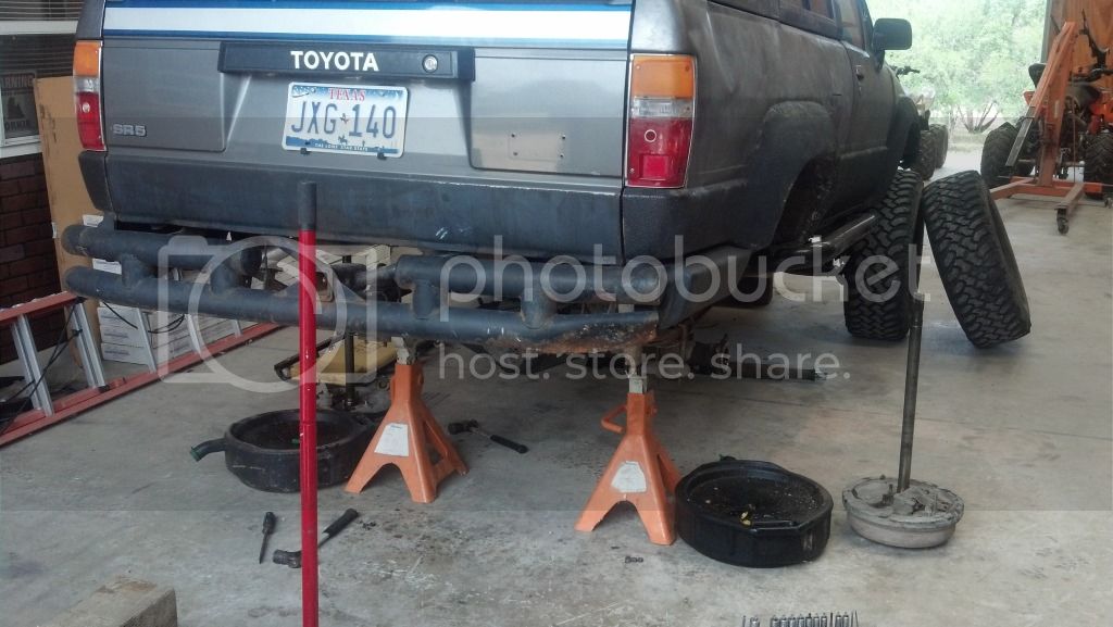

So it had horrible fender flares in the back that were homeade...I was afraid of what was underneath...well I had reason to be...
I went to the junkyard and cut out some really nice quarter panels but dont have the time to put them in, so for now I just fiberglassed over the hole with about 30 layers of fiberglass, hell its probably stronger now than factory.
Put some wheel spacers in the rear as well. Also went to east Texas and did some mild wheeling..

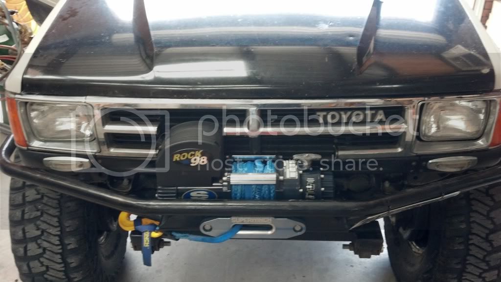

Then decided to hell with that stupid Smitty built bumper...
Got the old lady to do some grinding and welding for me...
