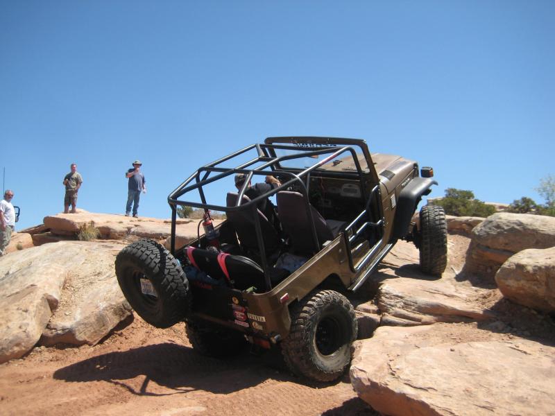

Quick question about your wheels. First, are those KMC wheels the ones with 4.75 backspacing? and second, are you running spacers? I'm in need of 17 inch wheels but dont know what backspacing will work. Thanks for any help or advice
Yes they are KMC's, Backspace is 4.75" I believe he is runnin 2" spacers.
