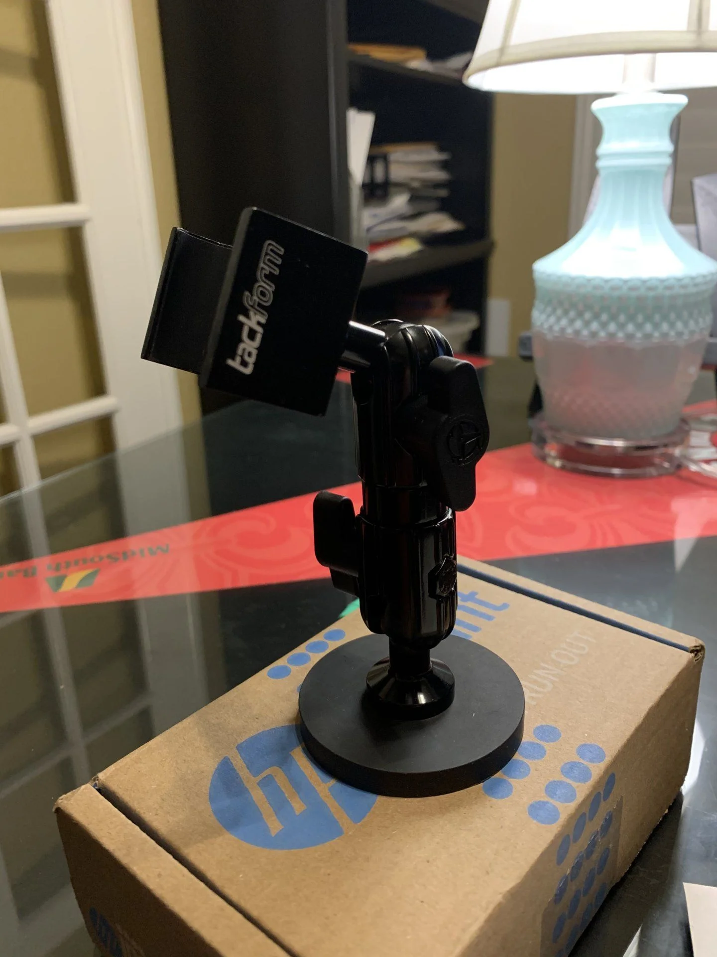

Awesome all metal phone holder that magnetically mounts to FJ40 metal dash
Used the Enduro line of gear from Tackform with a rubber coated magnet from Amazon
Tackform enduro series components:
Tachform Parts Used:
-TF-AR-09 3.5" ARM | DUAL 20MM BALL COUPLERS | ENDURO SERIES
-TF-BS-28 TRIPOD ADAPTER | 1/4"-20 HOLE | 20MM BALL CONNECTION | ENDURO SERIES
-TF-HL-20 PHONE CRADLE | 20MM BALL CONNECTION | SPRING LOADED CRADLE | ENDURO SERIES
Amazon Rubber Coated Magnet:
-MUTUACTOR 2pack Neodymium Magnetic Base Rubber Coated 1/4"-20 Male Threaded Stud Pot Magnetic Fasteners, 55lbs Vertical Pull-Force Magnet
