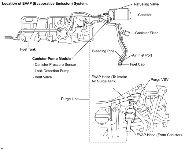

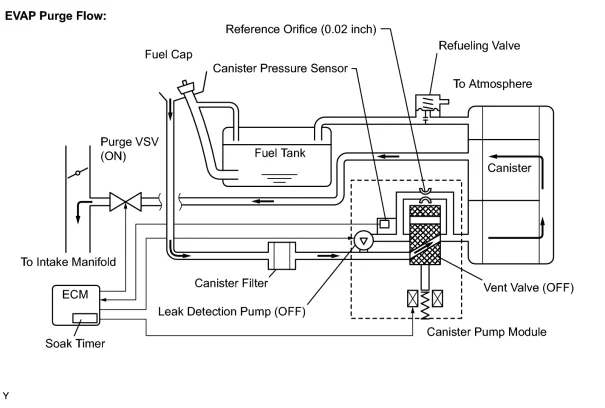

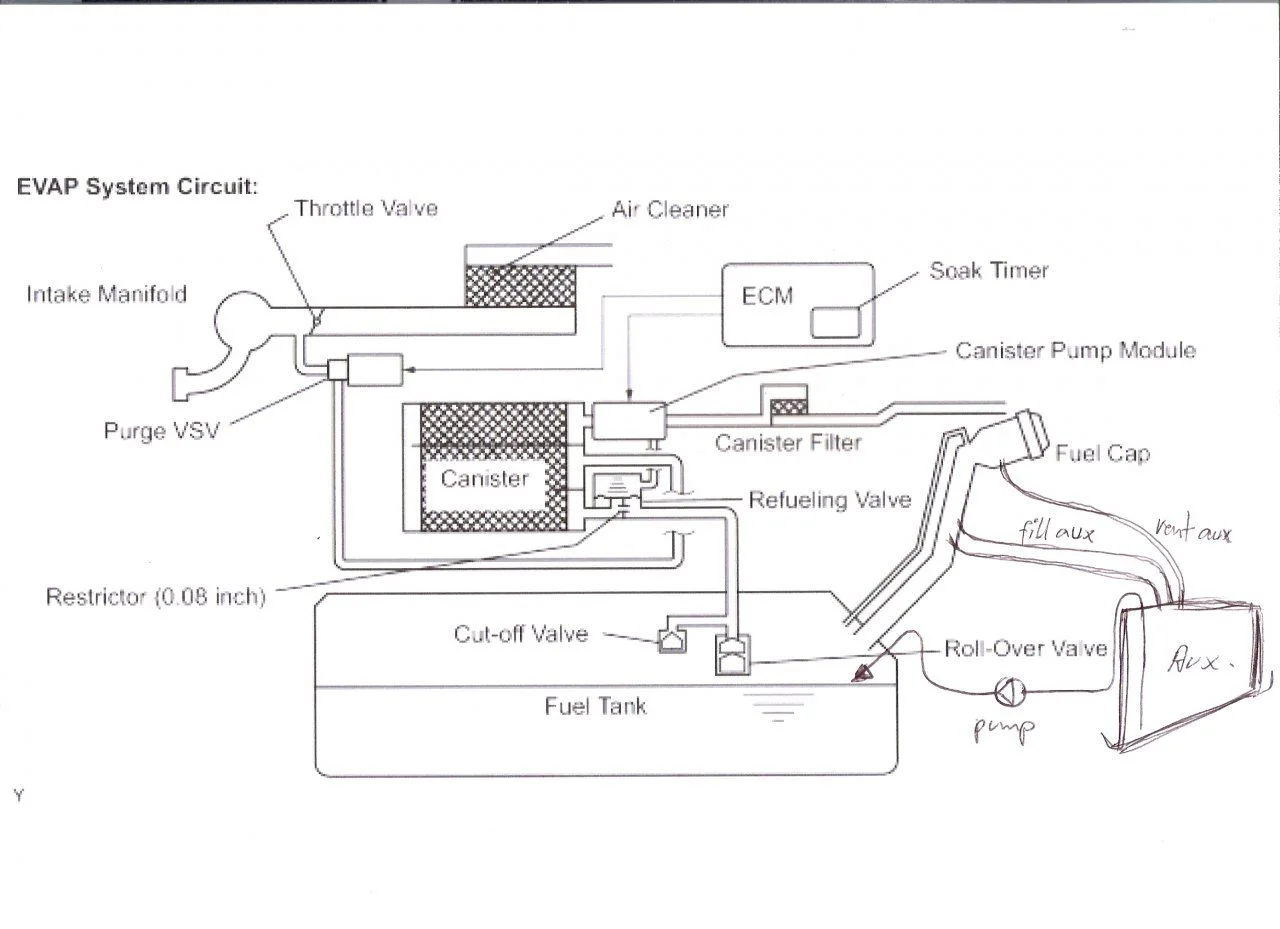

two more pics: one is another scheme from the FJ tank system, the other is appr. what I've made.
So this is the riddle...how does the fuel get out of the canister filler line, whis is normally only the inlet for the canister regeneration?
Cheers,
Dirk
Is the following right:
-the canister system is always open except for the pressure test?
-so when overfilling the main tank by pumping (it's a rather strong pump, but a lot less than the fuel station pump), the pressed out air is going...where? It should go through the bleeding pipe and from there back into the aux tank.
-excess fuel should just flow back into the filling hose and into the aux tank...but it seems it doesn't
Cheers,
Dirk
Ah, sorry, forgot to say: both bleeding line and "vent aux" are tightly sealed by the fuel cap, because else the pressure test wouldn't work. They "meet" just below the cap, my aux vent is welded into the metal.
Dirk
Me again...talking with myself...
Would it be possible to install a back pressure valve in the canister line or would this cause too high pressure in the tank system when the fuel is evaporating?
Dirk

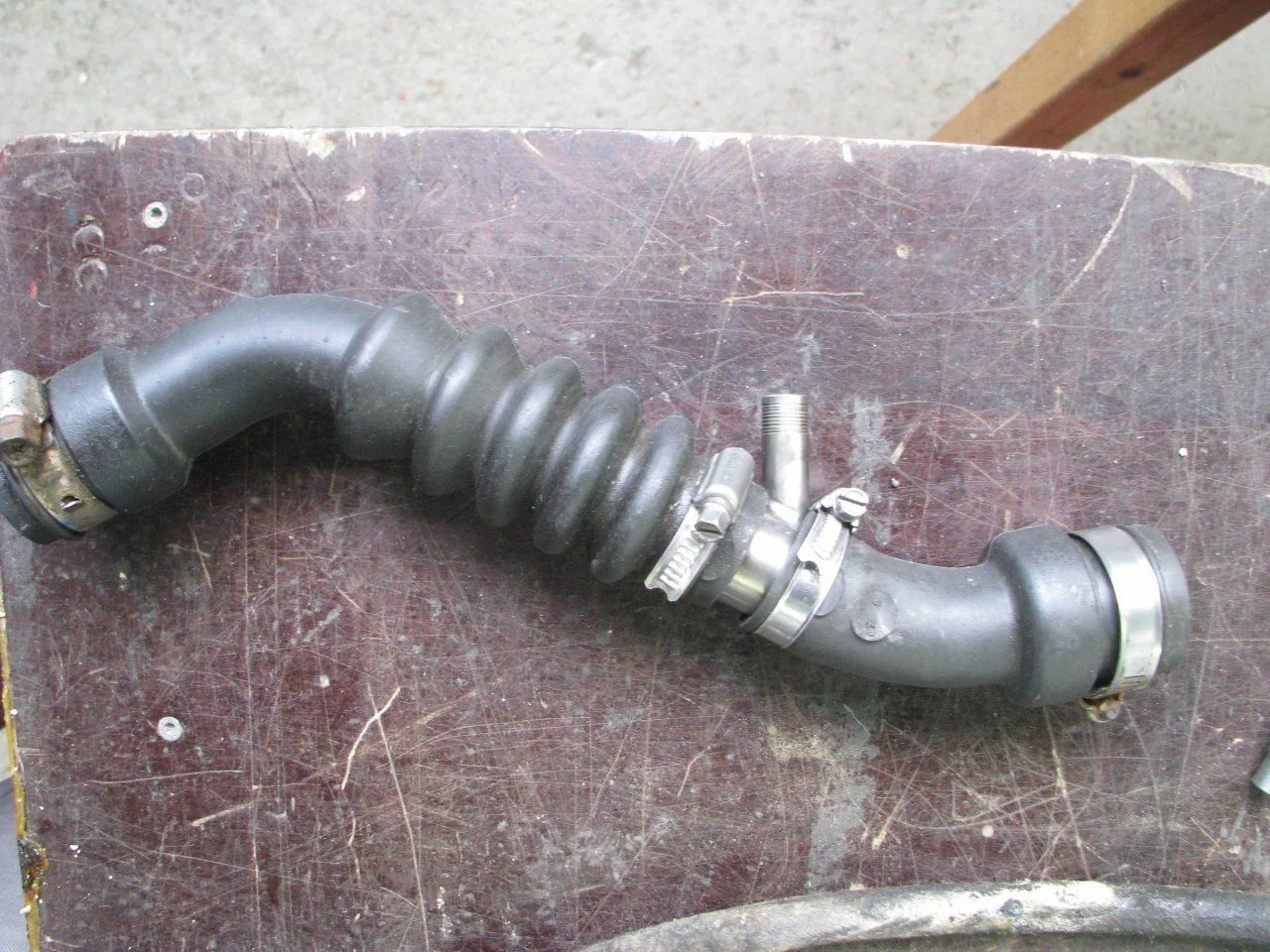

Tha last failure notification was then probably from fuel spilling into the purge valve or carbon filter canister, I assume, so the system got soaked and drowned. Til now, I have no idea of HOW the fuel got there, but the only change I made was filling the main tank from the standard filling hose (see above) and not directly in the tank body with an attached filling inlet.
The only picture I have it the one above, it's the filling hose with the inserted T-piece. If the tank is full, the fuel does no longer flow into the tank but backwards to a welded Y-piece in the steel inlet tube and then back into the aux tank.
