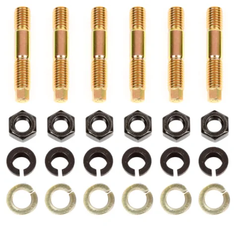

I've not been able to find these Automotive Racing Products (ARP) studs for a 100 series front axle yet. I sure like the way a star socket can be used to install or remove the stud. These are available for 80 series and earlier.
If anyone knows of an ARP stud with the star end for the 100 series, I will be grateful for the lead.
I think that kit should work on the 100. IIRC, the hub stud size is the same for pre-96 pickups/4Runner, FZJ80, and UZJ100. I’ll look to see if I have any spares laying around from both to measure.
The studs are substantially larger on the 100 series vs 80 series, 8mm vs 10mm.

Just the ease of removal and installation if the star head was on the outer end. Unfortunately, those appear to be on the wrong end. That's mostly it.
