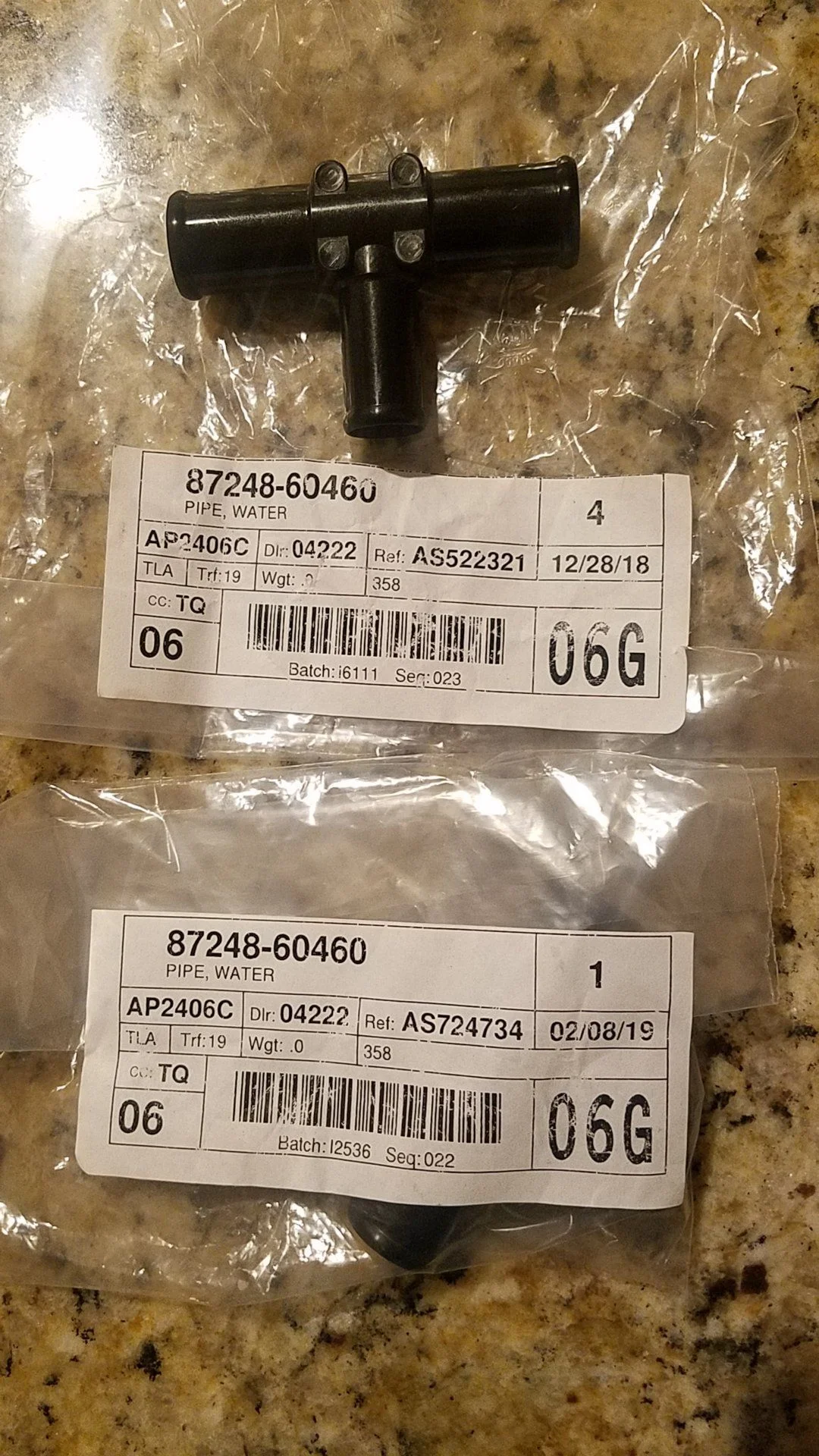

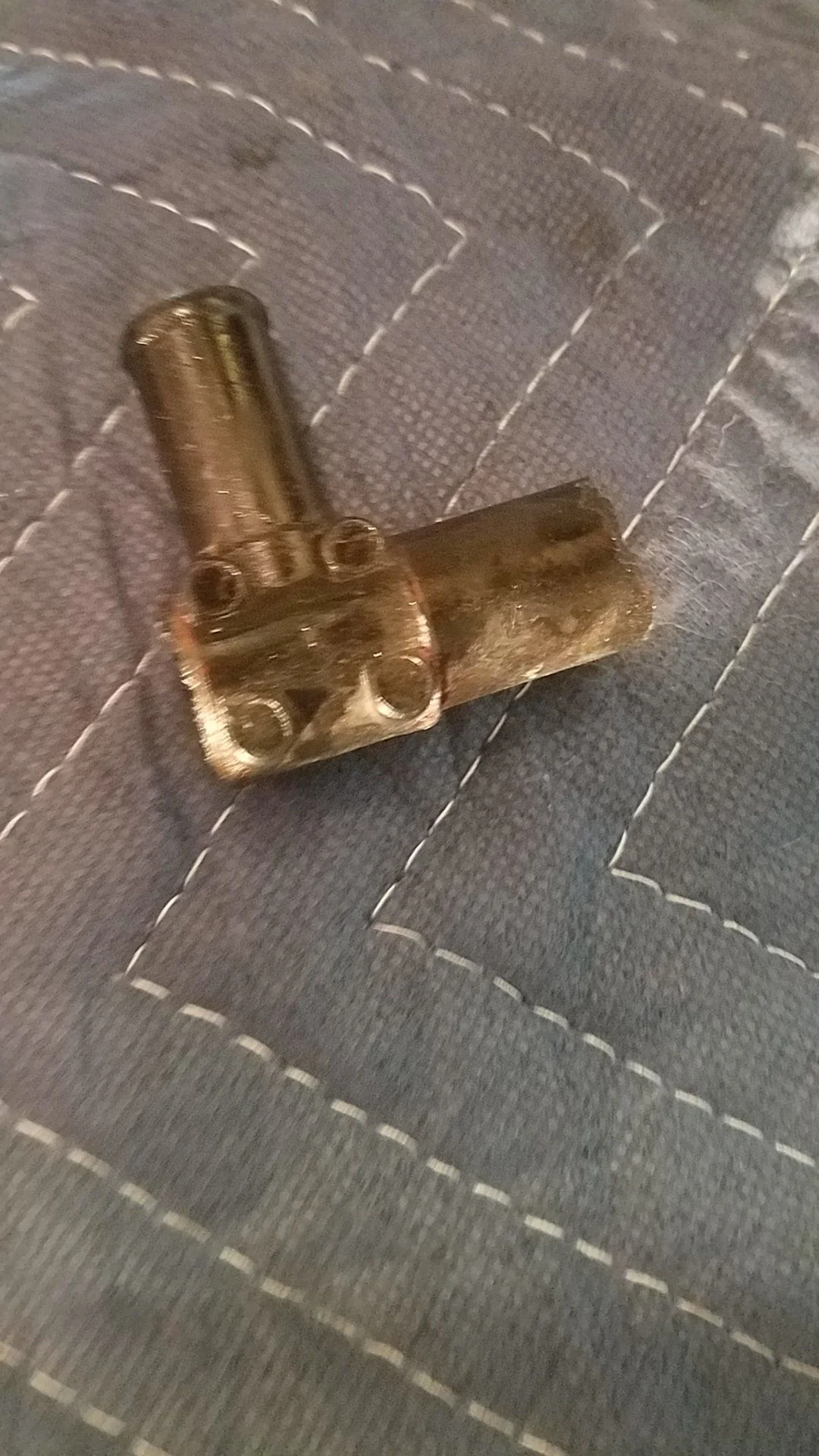

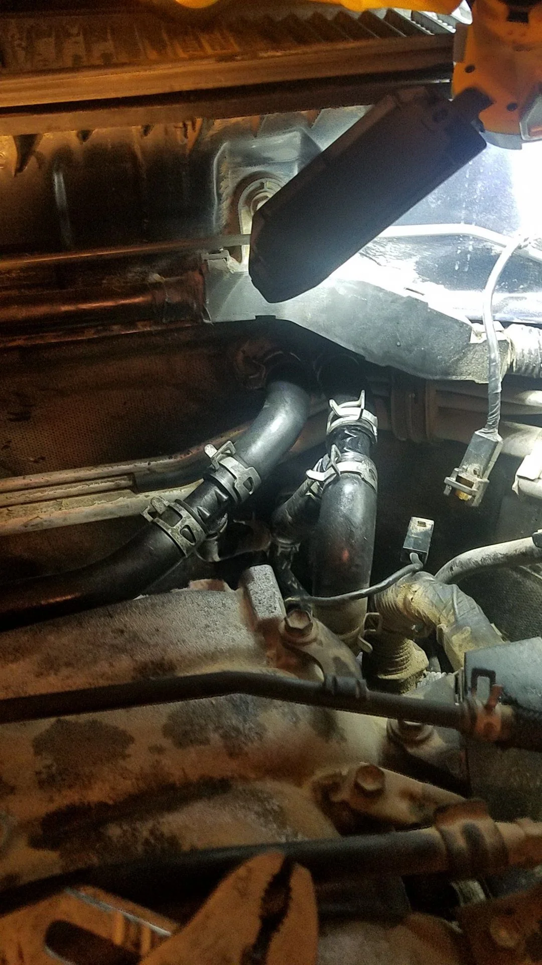

A huge thank you to this amazing club for their knowledge. A lot of you had been telling us 100 series owners to change our heater T's if we haven't changed them in a while. I changed mine out this weekend with Toyota OEM( $14each Toyota Carlsbad with our discount for being a club member). When I went to change my now and I couldn't believe my eyes mine were actually completely cracked all the way through in multiple spots one actually pretty much disintegrated when I went to remove it. I recommend removing the hoses as well and washing them out from the plastic particles if you encounter that yours have been deteriorated very badly. In the end it was a pretty easy job with a pair of pliers and a thick blanket to lay over the engine once it's cool. A big thanks to all you again for passing on your knowledge and keeping our rigs running!!
Do you always run with the dust cover off? I always wondered if there was a reason for it besides the cleaner look for those owners that are engine averse.
