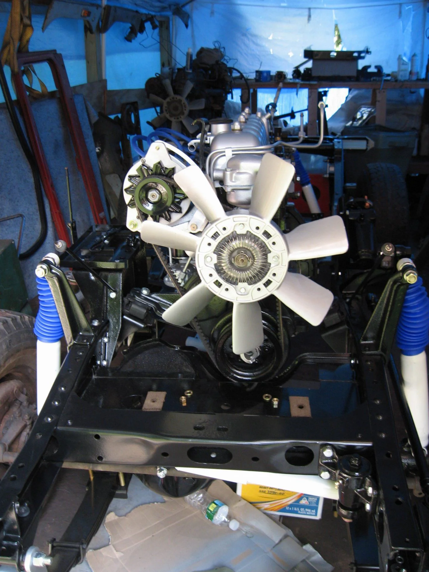

Assembly help
one all the way on the right is hood prop as stated for a split hood - should work for your year
one all the way on the left is a later cruiser radiator support bracket. IIRC your year model should just have one long radiator support on the passenger side.
Radiator supports I've seen were straight and threaded on the radiator end and used rubber cushions on both sides off the bracket on the radiator mounting housings.
you nailed it! it looks pretty damn close to the same size. But you are correct... one end is bent and flat.. the other is straight threaded rod to support the bushings etc.
had to dig through my old pictures...
