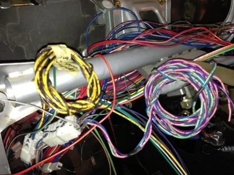

Was wondering if these multi colored wires are speaker wires?
According to my wiring diagram for a KZJ70....
Light Green and Blue are for the front right
Pink and violet are for the front left
Red and white are for the rear right
Black and yellow are for the rear left.
Possibly the same for others !
