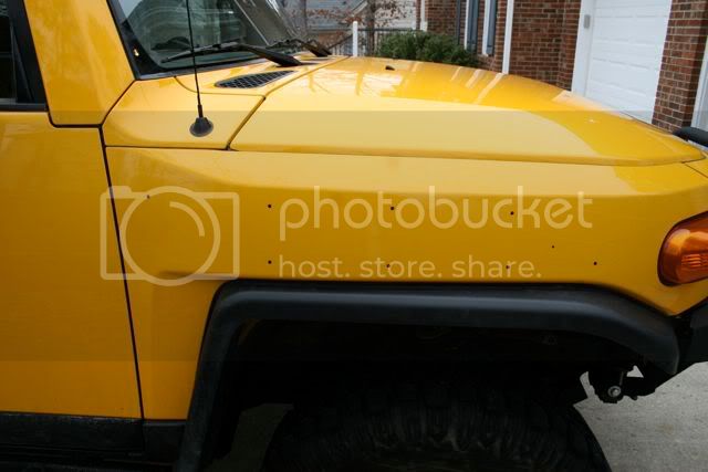

Here is the pic of everything marked up and ready to start drilling...

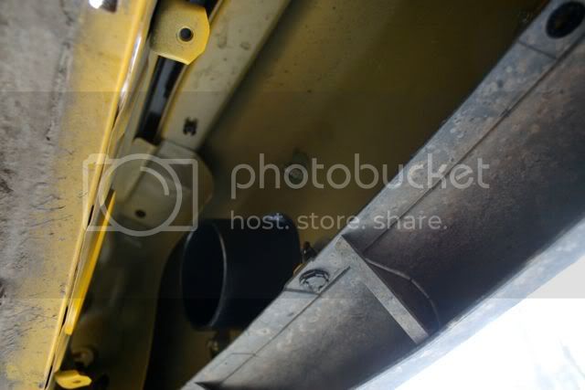

Pic from inside the engine bay with the intake removed...
Pic from inside the fender well with intake removed...
Another view of the same with a bit more in the pic...

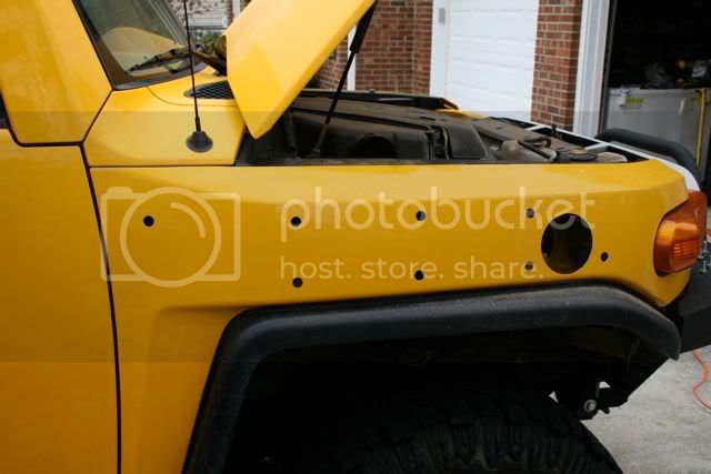

Pilot holes drilled, could turn back if I had to...

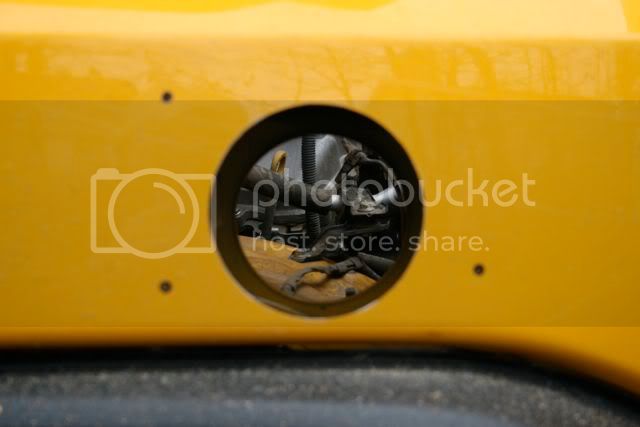

No turning back now, 105mm hole drilled, easy view into the engine bay...

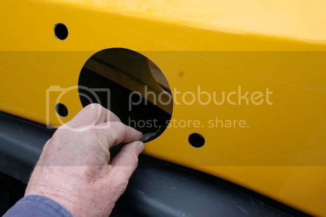

Major holes finished in the fender, the step drill made these really easy...

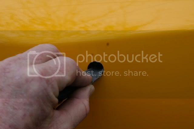

Working the burrs off with some 220 grit wet/dry...

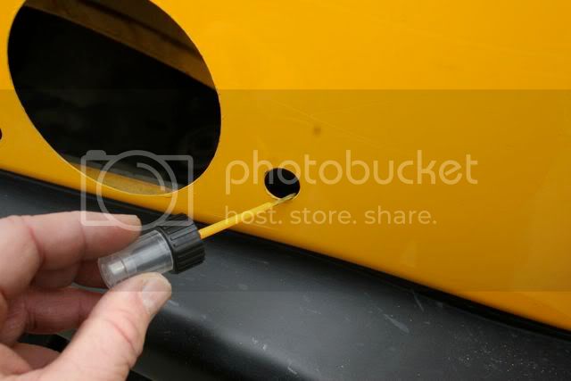

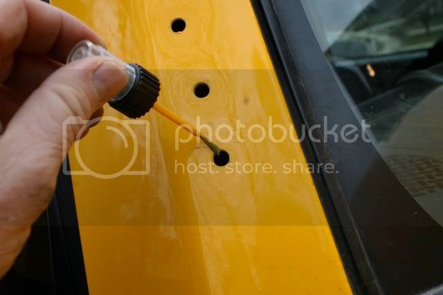

Now to apply a bit of the Sun Fusion touch up paint to help hold off the rust...

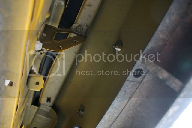

Plastic nuts installed. This is the one place I would be careful to not round the holes any larger than the spec. Mine went in tight but when I went to install the bracket, they spun in the hole. It took some force to get the to hold, once the screw expanded the plastic enough, they held firm...
A-pillar bracket installed, awaiting snorkel body to be mated with...

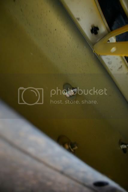

A couple shots from inside the fender well with everything snugged up...

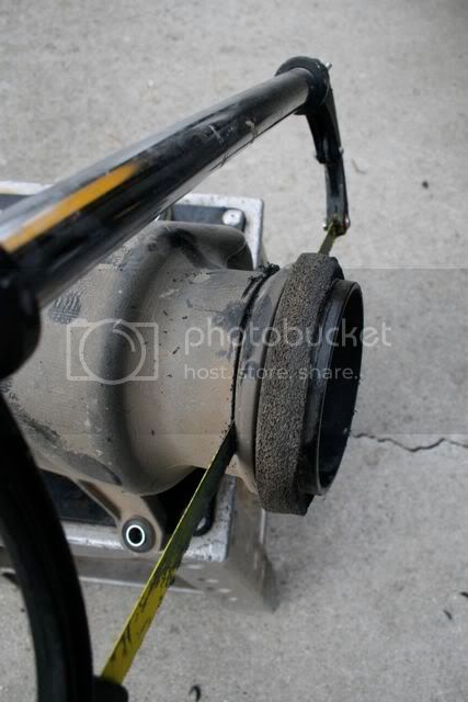

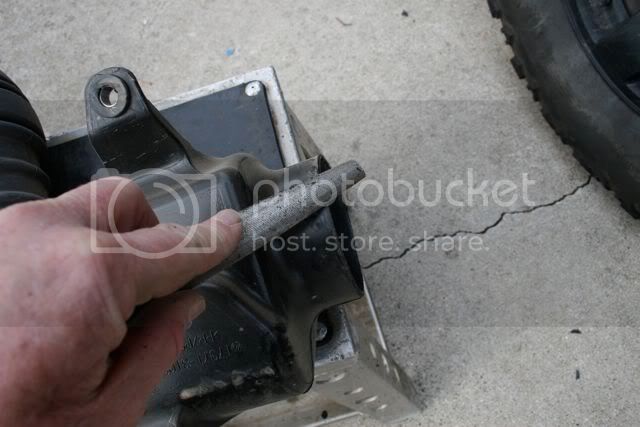

Time to hack off the intake for the union of the snorkel to the intake. I was careful to not take off too much but found that there is plenty of margin. Due to my paranoia, leaving plenty of material on made for having to really squeeze it back into place. I could have taking off another 1/4-1/2" without any problems...
I chose to hit it with a file to knock off the rough edge and give it a little bevel to make it easier to slip on the rubber union between the snorkel and intake. A few extra minutes made for an easy slip on of the junction...

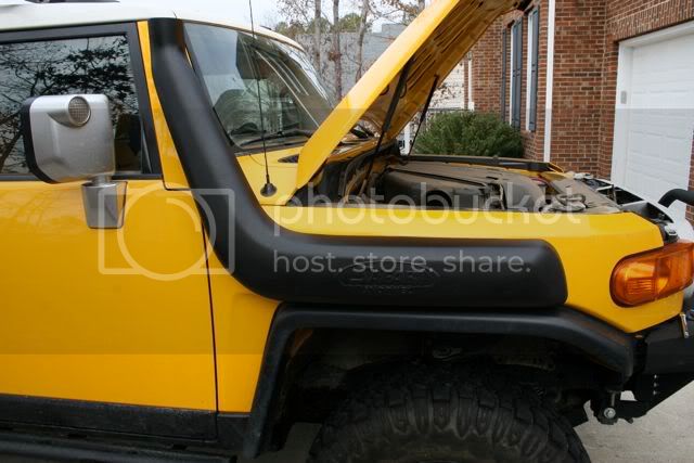

All done, not bad after all and it still looks pretty good...
