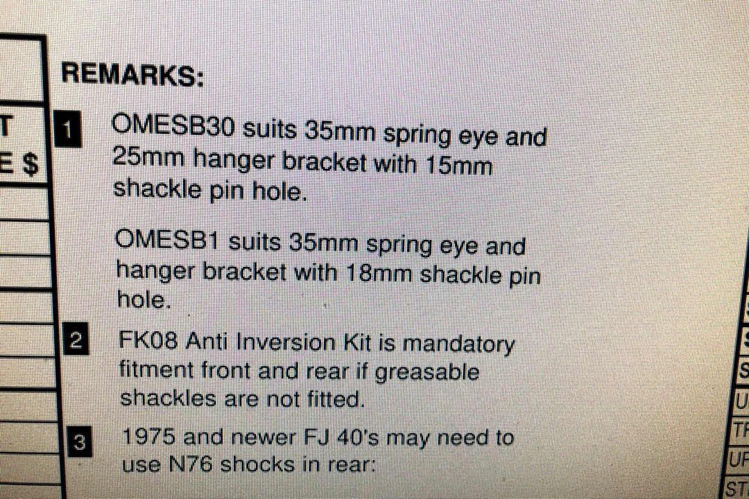

Different spring makers have different size eyes. I learned that when I got a set of OME springs. And you just learned it now. So, you’ll end up with some spares. Not so bad. I acquired a huge assortment of spares getting it all sorted out having OME springs, stock size greaseable pins on the fixed, end and homemade 5/8 greaseable pins on the shackle ends.
If you had noticed “Note # 1” in the catalogue, you may have figured it out.
Odd. My spring eys are 25mm and the hangers are 35mm. Exactly opposite of note 1. The OMESB30 kit has 6 of the 35mm and 2 of the 25mm. Thus the problem.
35mm shackle hangers are not stock for a 1972. Your frame is either not a ‘72, or it has been modified.
