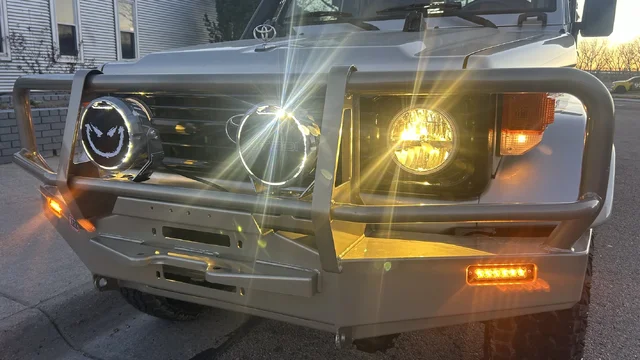

Can someone tell me which rigid lights & what p[art number you used for this application? Is the square hole in the bracket 3'' x 3''? Thanks in advance!
Definitely go with Slee's brackets and Rigid lights. Install wasn't too bad, and the gains are incredible not only for function but looks as well. The standard setup looks very dated, but Slee's upgrade makes it look far more modern.

the bracket install looks pretty simple. Did you have any wiring issues with the Rigids or the ARB indicator lights? Are they just plug and play and work off the factory switch?
Turn signals work fine tapped into the factory wiring. I wired my fog lights to a separate switch panel, but I'm sure it would work using the factory switch considering how low amp draw they are.
Looks good but you might want to flip your passenger side turn signal as the white lighted portion should be on the outside portion of the truck like it is on the driver side.
I know man .. of course I realized that after I buttoned everything up :bang: .. I am hoping I can flip it without taking off the entire bracket
