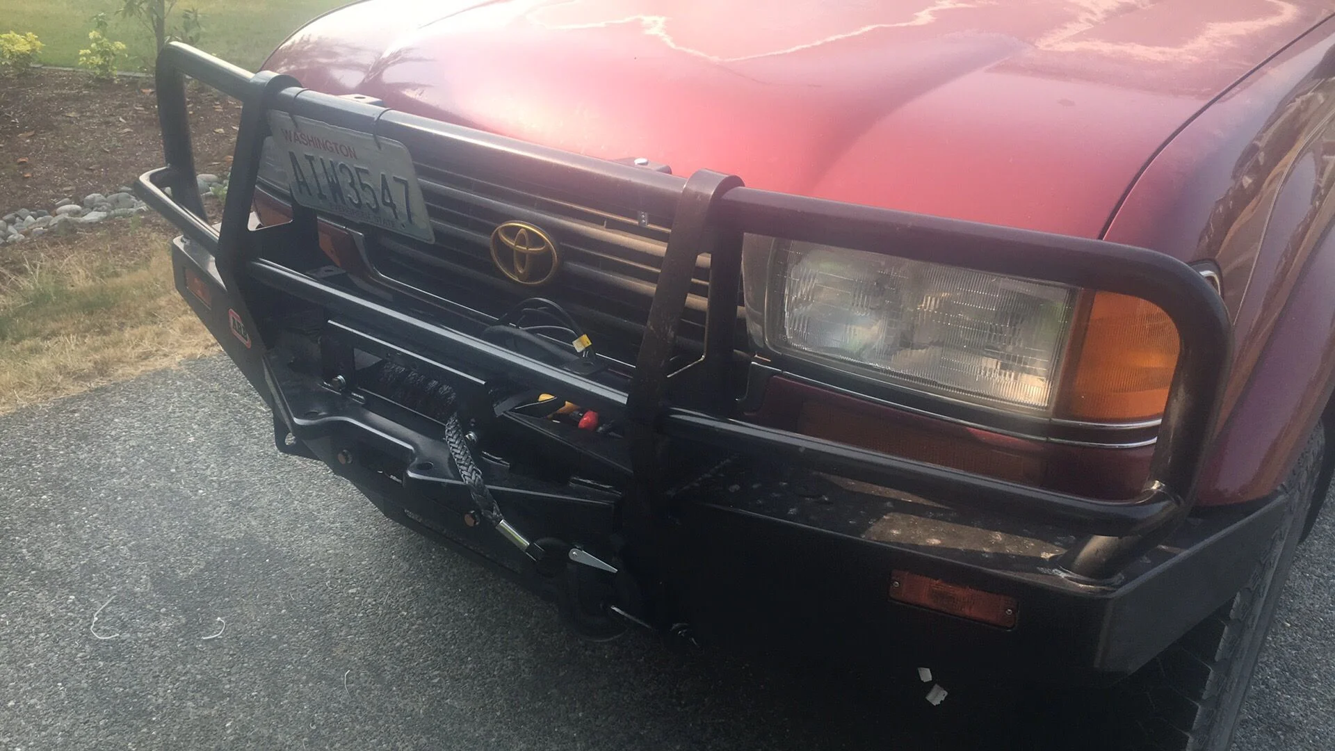

I've installed an arb deluxe winch bumper with a Smittybilt 12k winch, synthetic rope. I see people use aluminum fairleads. The fairlead that Smittybilt included has bolts centered, but I think I would need an offset fairlead to use the bolt holes. What do I do with the tabs in the bumper that are supposed to support the roller fairlead? They look like they might contact the rope in an offset pull.
maybe a pic?
I think I need to flip the winch, as the rope should come out of the middle of the bumper. And I know I shouldn't use the winch until I get the fairlead installed. I have a sheath now protecting the rope from the edge of the bumper.
But you can see the two problems I have here, the bolts are not centered on the opening, and those tabs are in the way.
I do have a Warn but a cheap Harbor Freight winch. When I flip mine in the ARB on my FJ62 the cable came out the bottom. The writing/labels were up so I can read them. For fairhead had drill new holes so us was centered on the bottom opening. Replaced the side roller pins with grade eight bolts the went the flange sticking out the bumper. Pins would have worked just like including flange for a little extra strength. Kept the steel cable for a free reasons. Mine is hardly ever get used. If I would have had to pay a grand for a winch wouldn't have one. Found the used bumper local and is a winch bumper. Cruiser is kept in a insulated garage in Northern Arizona so rust isn't a issue. Worked in the trades and had many classes on OHSA rules. One thing they drove in was any safety harness hard hat had a five year life then needs to be replaced. Have steel cables on winches over forty years old. In Arizona twenty years and won't trust a synthetic rope.
I used a new roller fairlead on mine (with Synthetic) and bolted right up (Superwinch)
I know lots of people say not to use a roller fairlead and other say only aluminum.
