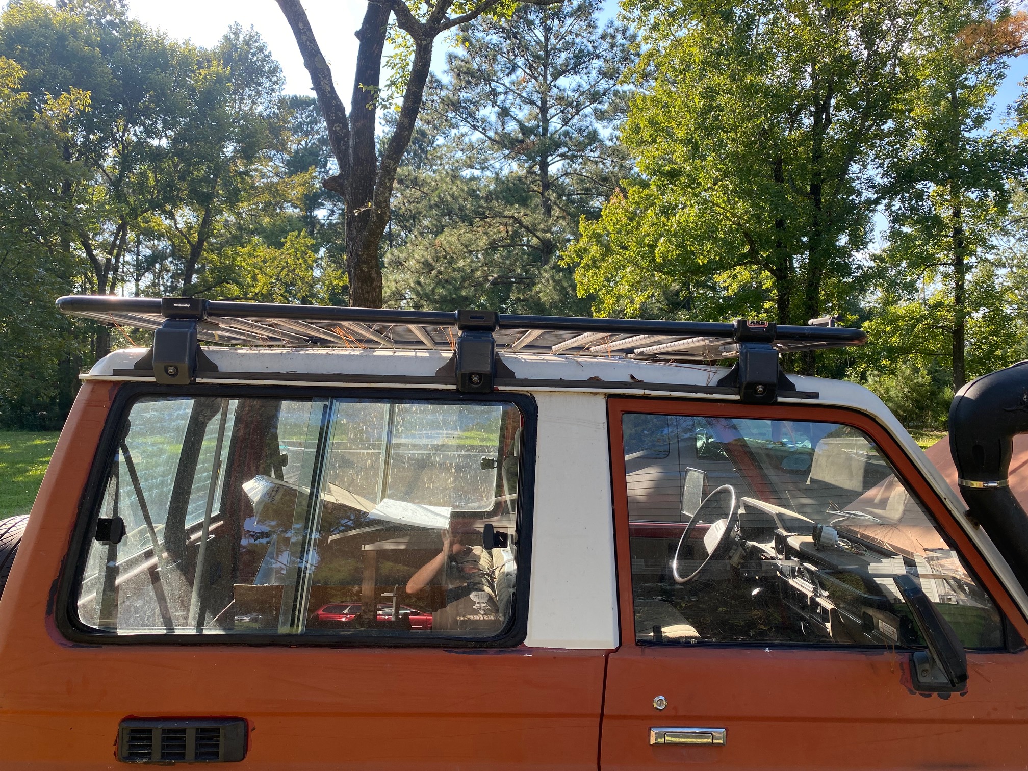

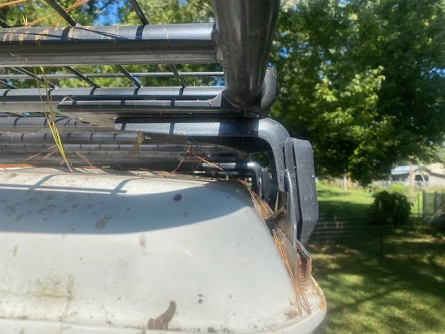

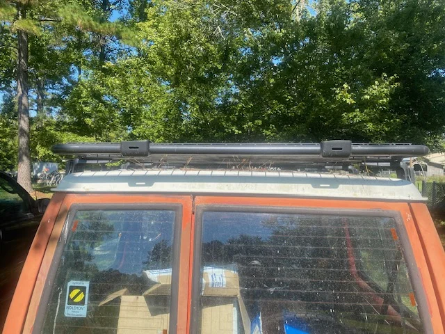

Looking at that picture, when I measure from the bottom of the clip that goes under the roof rail (just below the single bolt head that you can see in each clip about an inch from the bottom of the assembly) to the top of the part of the clip that bolts to the rack, it is between 5.5 and 5.75 inches. The rack is 75 inches long. You may notice that I cut the top rail off of the rack. I decided that I preferred it flat all the way across to make it easier to load and for ease of RTT access. Please let me know if you have more questions.

I have the 50.5. I think you could use the wider one and have it work.
