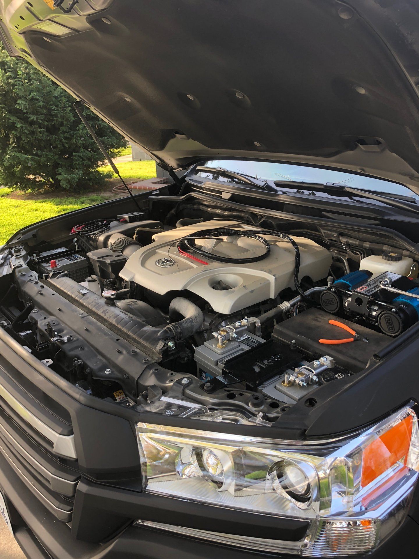

I’ve installed 2 now on my trucks and really like it. It’s about a half hour job with 2 people or a very frustrating much longer install solo (top bolts need to tightened while nuts under fender are held with a wrench). Get a buddy and save yourself some time and colorful language.
Yes. Well built, and easy to install. But it's made for a specific height battery. You'll want to add the big battery along with it.
I also use the 2nd battery tray from Slee...which is especially nice, since it also provides brackets for easily relocating a few guts to make space for a type 35.
