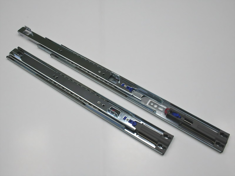

I'm not happy with the drawer slides I have from CS GLide - they are side mount soft close - and they are not working well.
The gliding action is excellent and they appear very well made. However, the design of the piston on the soft close is poor. They often malfunction by not catching the piston and setting it in the proper position. The piston then retracts to the close position while the drawer is open. This leads to a situation where the drawer ends up about 1/2" away from being closed sitting against the retracted piston. A little effort will push it past, but it basically does this every time once it starts to fail. I have a couple drawers that are used a lot doing this. I'm at the point of having 3 options:

If the side mount replacements are of reasonable quality I'd prefer that route. Cheapest and easiest option. The KV slides look to be a much better mechanism for reliably "setting" the soft close function. I also like the idea of the accuride 3832aa which soft open assist and soft close with a small piston that goes under the drawer. I think I have room for them if I re-mount the drawer faces just a little on the bottom most drawers.
Any advice or experience on either model would be greatly appreciated.
The KV uses this type of internal mechanism:
As compared to the CS Glide that look like this:

I just noticed that the K&V slides you pictured have the soft close feature. We haven't used that feature for about 4 years, and at that time we had trouble with the little plungers. It was the first time they were available, and they were supplied by the K&V people for free as a demo site. I cannot say whether K&V have worked out the bugs yet. I would hope so though.
We use hundreds of the K&V non-soft close slides very year though with out trouble.
