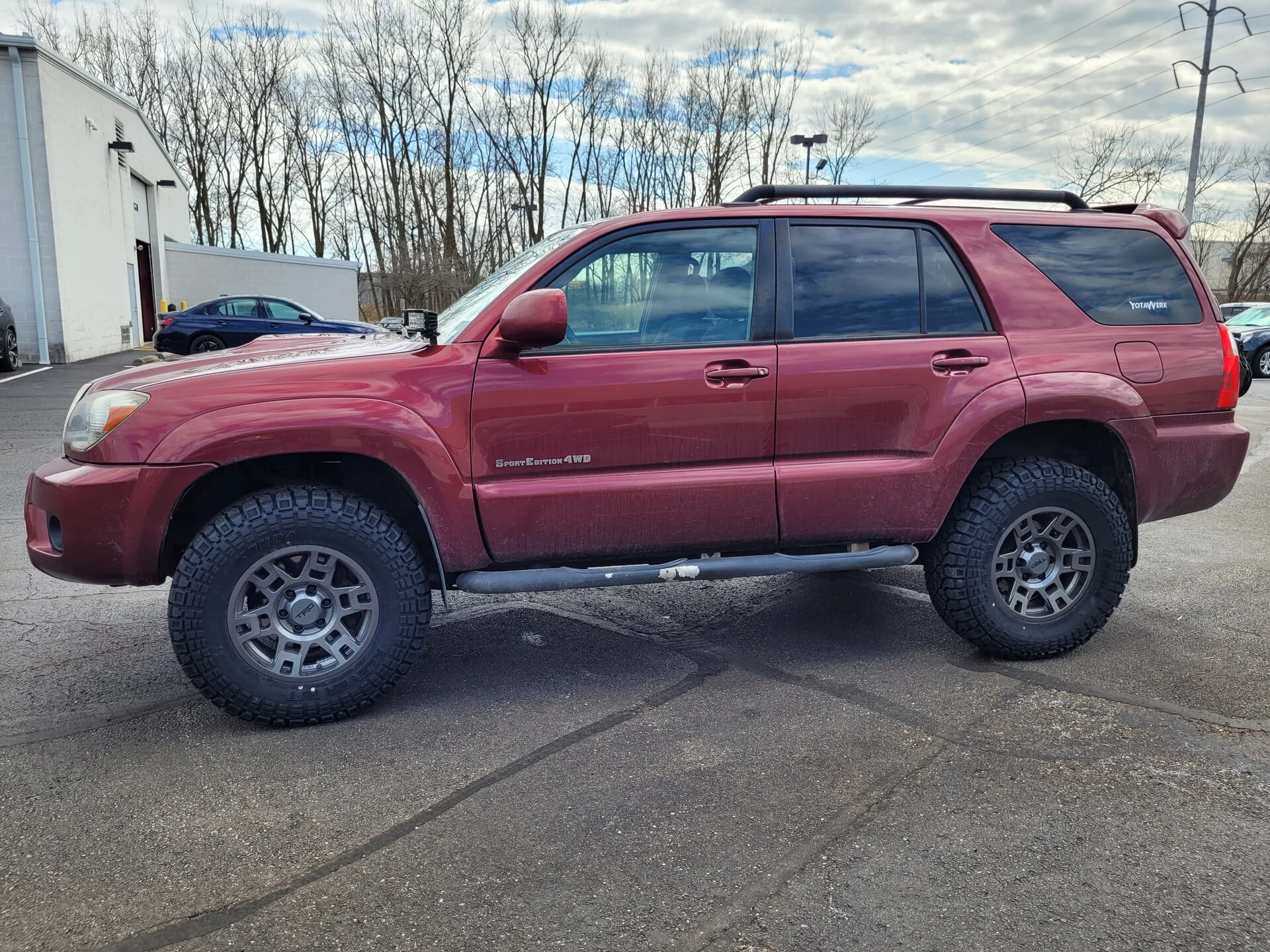

Anyone running 33x10.5R17 tires?
I didn't know this.. TY for the education!
The width is more of a limiting factor as is offset. No rub on body mount and I just had to push wheel liner forward and back, with no lift.
The fat tires >= 11.5” tend to rub on sway bar or frame even with a -12 offset.
Original tires are 10.6” wide and are tucked in at +25 offset.
So, skinny tires tend to work better with less trimming and less metal chopping than the fatter tires (up to 33” tall).
After 33” tall…then it may start rubbing based on other factors like uca, camber, offset, etc.
