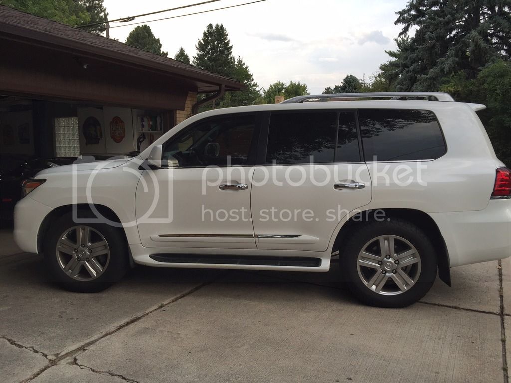

285/55/20 should fit just fine, 305 may rub if all stock. Am running 275/60/20 bfg rugged terrain on the wifes 570 to fill out the wheel wells a bit and it fits nicely, very minor rub on full turn.
Here you go.
That's awesome Ali! Thank you for taking the time to post! I'm sure my wife will NOT tolerate the rubbing since our LX470 rubs the crap out of the wheel well with 315/75/16s.

no problem and wow thats a huge tire for an LX470, guessing its lifted or running AHC locked in high at minimum. I run 295/70/17 on my 100 with a mild lift and it barely fits.
I just purchased those same rims. I have yet to install them but after seeing your picture I am very happy with my decision. Now I need to decide on which tires and tire size.
Yeah the chrome wheels ours came with did not do it for me and I am a sucker for simple five spoke design. Luckily all the tundra guys seem to be giving these away.
