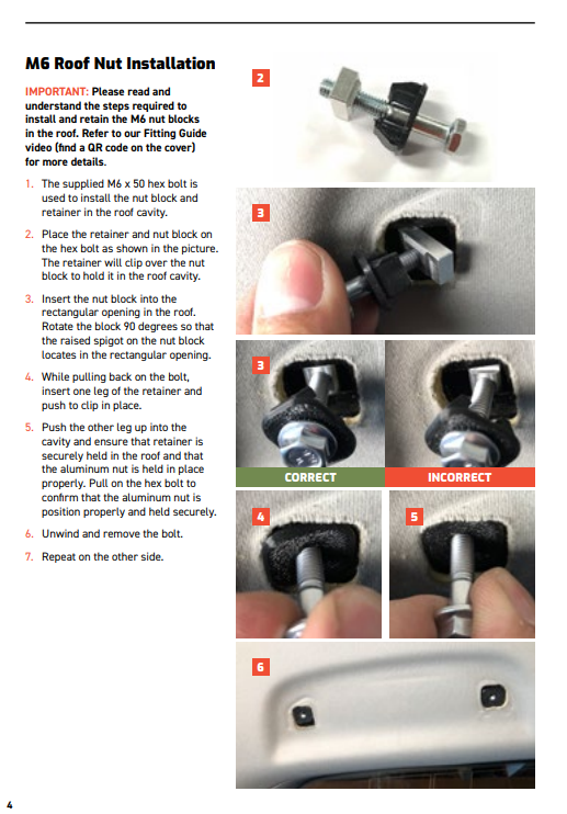

Swapping my Kaon shelf over to new truck. I don't think I can get the black retainer clips off without mangling them. Anyone done this? I may just have to get new hardware from Kaon.

It looks like the retainers tighten into place with the bolt? Can you reinsert the bolt and push to loosen them somehow? I agree you may just need to source a new set of clips from Kaon.

The pics above are exactly what I have. The plastic part is soft and I think I will destroy them when I pry them out. I’ll just give it a shot and see.

I had to remove mine for hail damage repair. Take care to unscrew the bolt only enough to pry out the retainer. At that point you can see what you are doing and remove the nut bolt
Update for posterity and as a means to remind myself for next time.
I finally got back to this and got the Kaon fasteners out. The trick was realizing that the bolts can be removed and the plastic clips keep everything in place and you need to use a longer M6 bolt to thread back in and use it to push the retaining block out of the plastic retainer.(reverse the original install technique). Duh. Then the plastic clip can be pried out and the whole thing removed.
