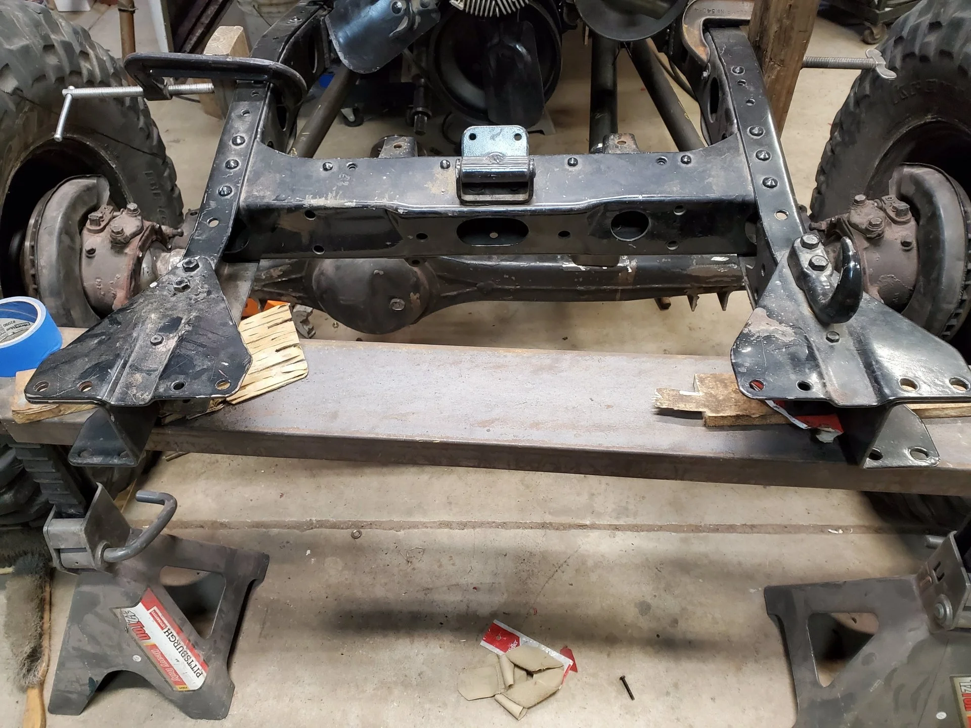

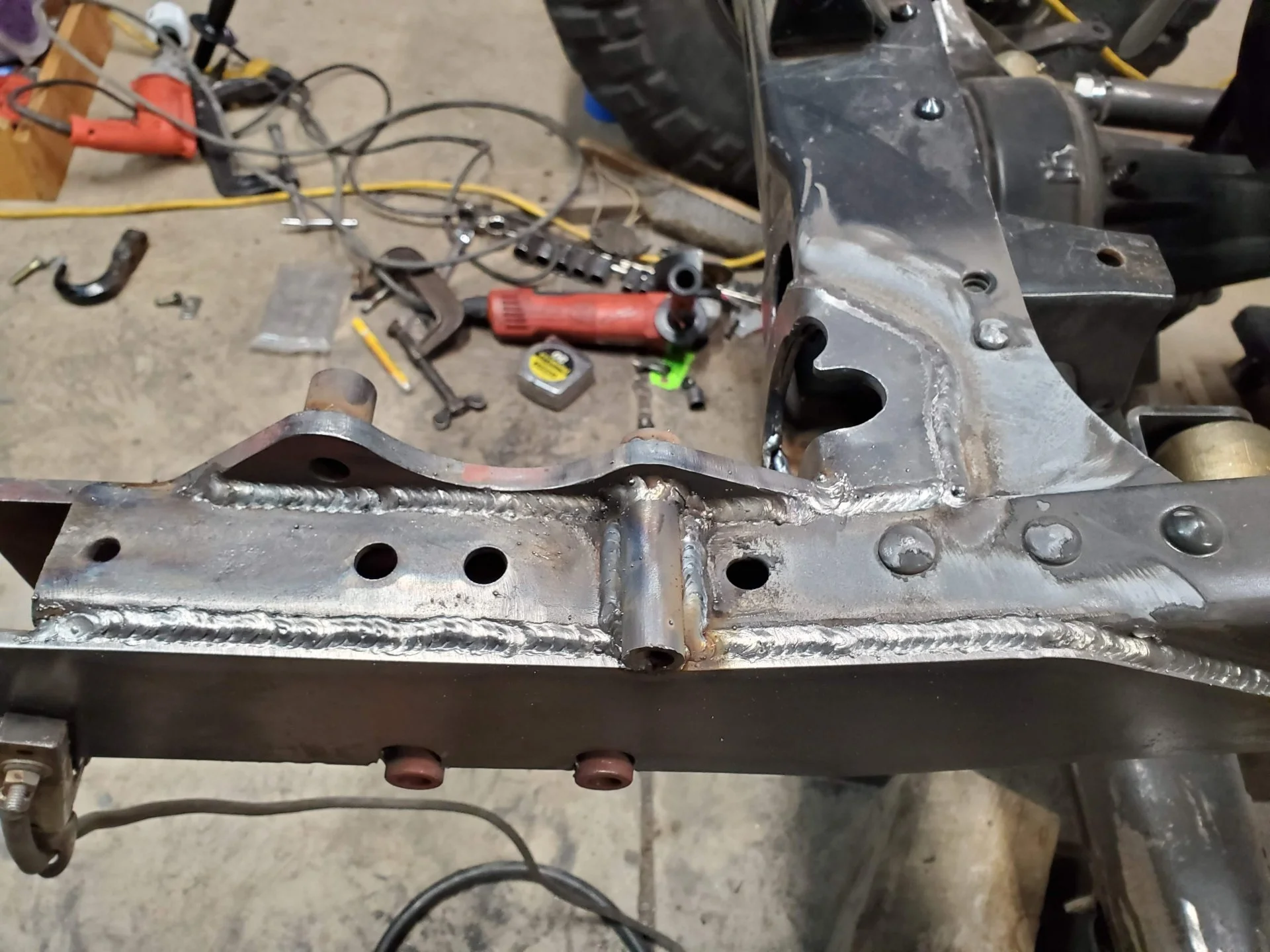

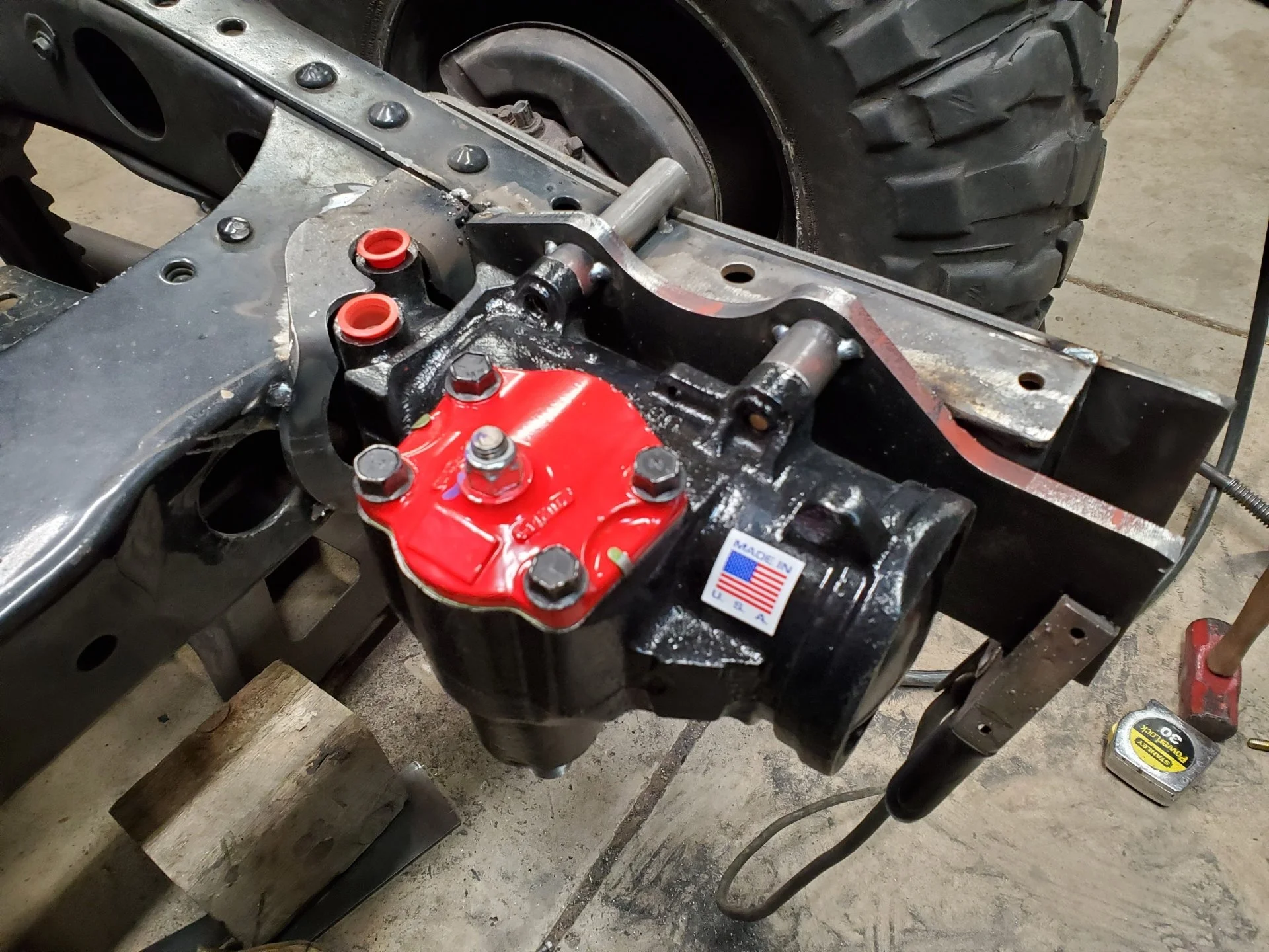

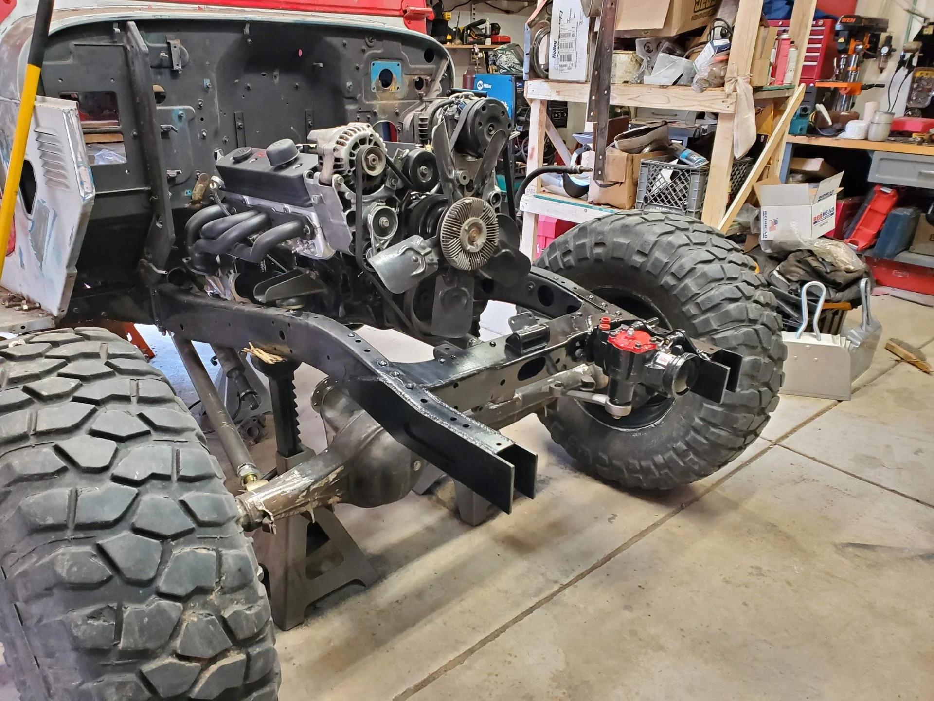

DangerNoodle Essentially a fire wielding monkey. SILVER Star Joined Oct 25, 2019 Threads 43 Messages 3,245 Location Yur mum's house Website www.instagram.com Jun 13, 2021 #2 Not super detailed, but it is pretty self-explanatory. Stock Frame Plates tacked in. You want to keep the box as level as you can, which the 4x4 labs kit does very well, and it also reinforces both sides of the frame rails. Welded up.
