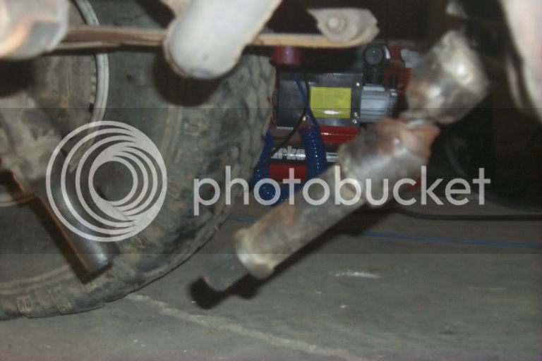

I love how the 4.3 has worked out. Tons of power, great economy and excellent reliability. My only issue has been doing this a couple of times:
But thats mostly my fault, a bit to much throttle on a hill climb.
