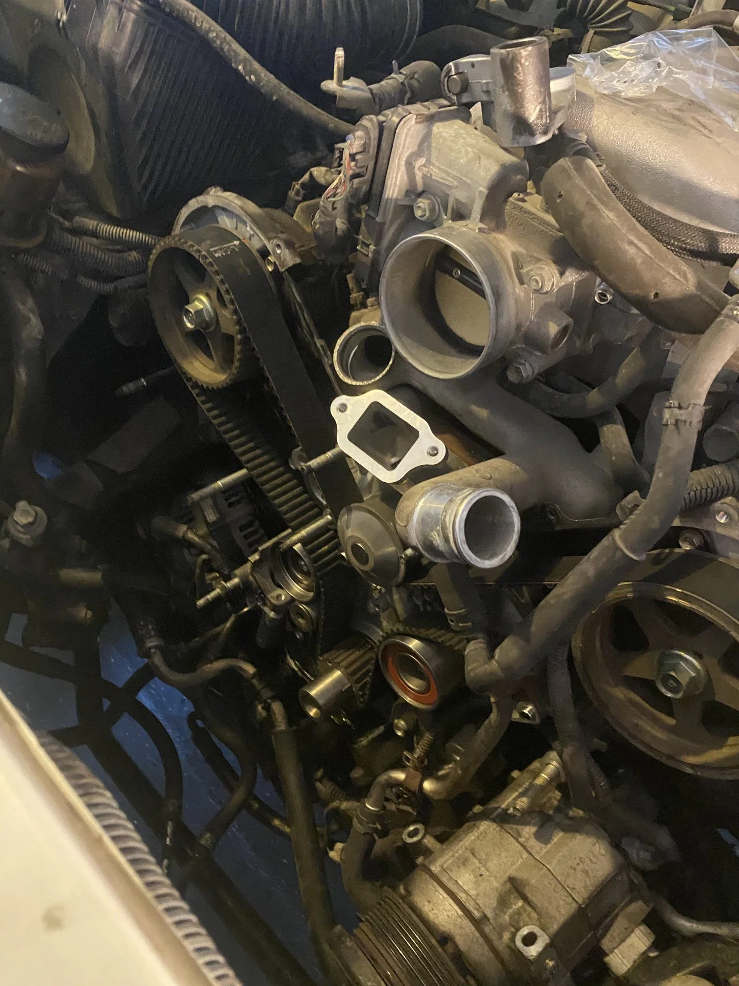

I got the lift kit and control arms installed !
rocky road kit for the gx470 heavy with struts assembled
at the same time we installed the LongRange fuel tank +33 gallons
Before the kit was installed we did the water pump crank seal belts and flushed the fluids. OEM fluids refilled
still breaking it in
tires have not been mounted due to me not wheeling any time soon
Have not taken the photoshoot it deserves yet
Nice work dude!
