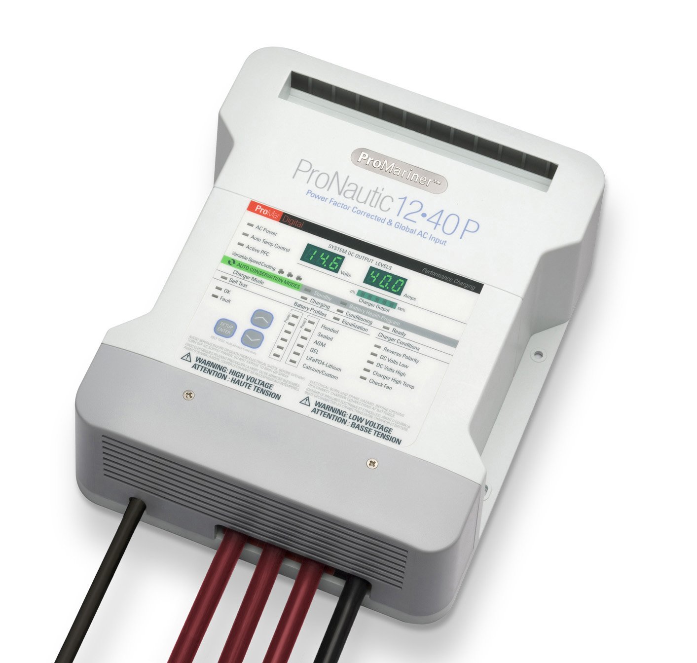

I just got another Odyssey 31M PC2150 battery and am looking at chargers after nearly killing the old one due to inadequate re-charging after cycling it. For best results the 2150 requires a minimum of 40A and 14.4 to 14.7V through both Bulk and Absorption cycles. Very few chargers meet these requirements and the ProMariner - ProNautic 1240P is the least expensive by a little. But very high quality. So... Anybody have/had one?
It's strange that Odyssey doesn't even sell a charger that can meet their own requirements to charge their batteries. The largest they sell is 20A. I didn't see a charger listed on their recommended charger list either:

Makes overall cost of ownership for an odyssey much more expensive...
