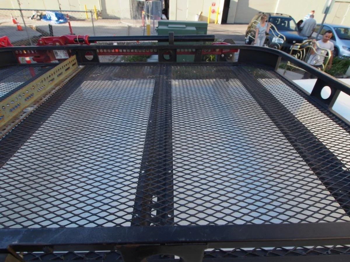

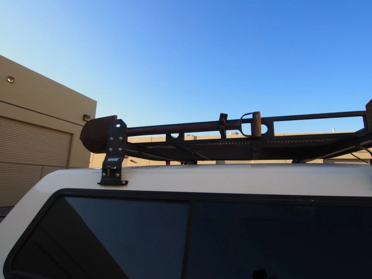

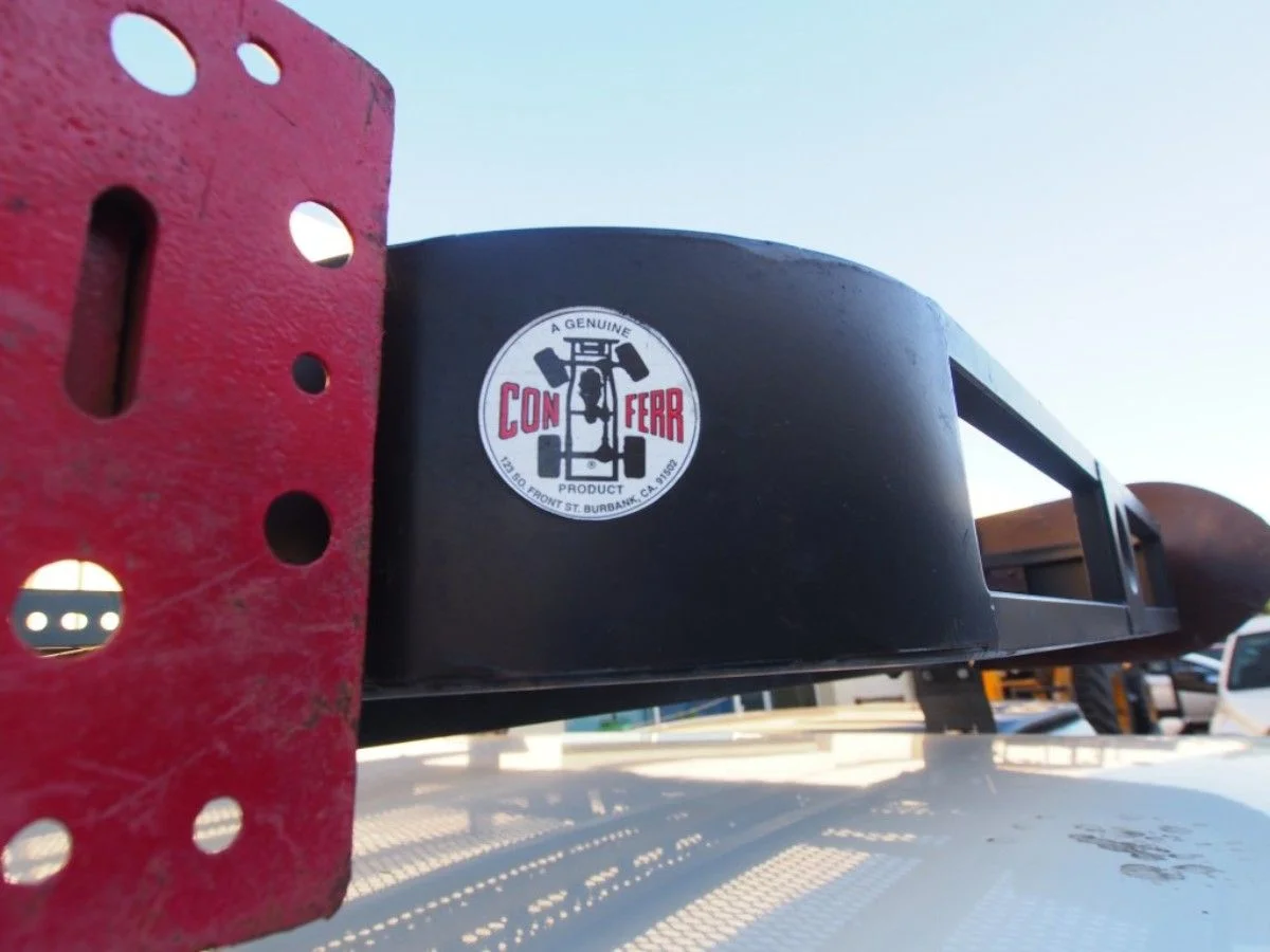

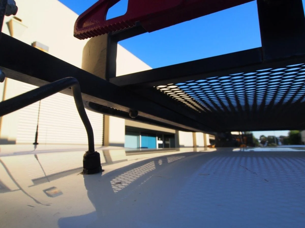

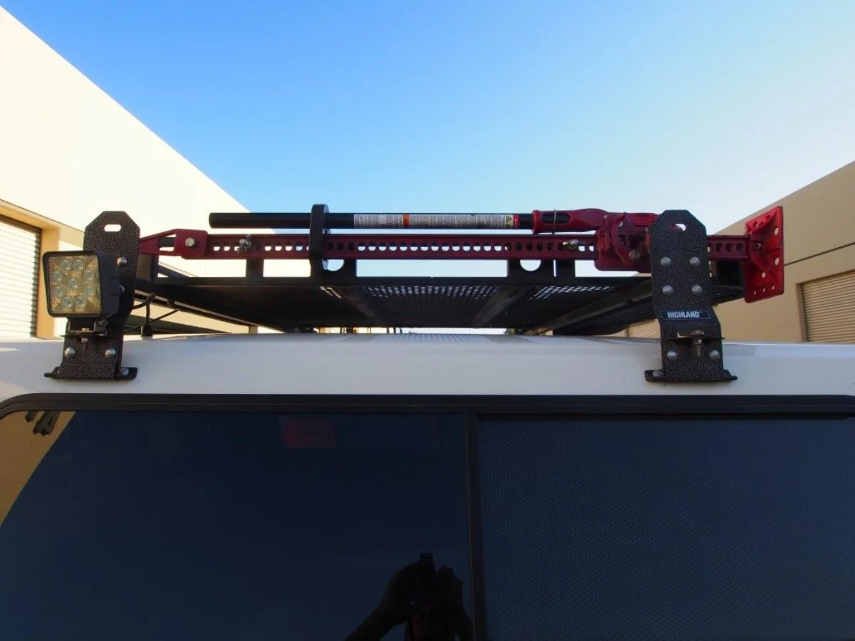

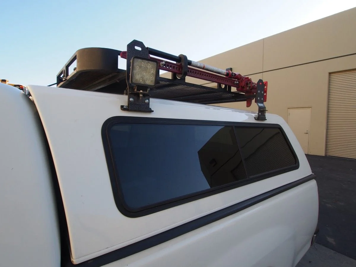

Con-Ferr rack w/ expanded metal deck
Welded in expanded metal & gave a fresh coat of paint.

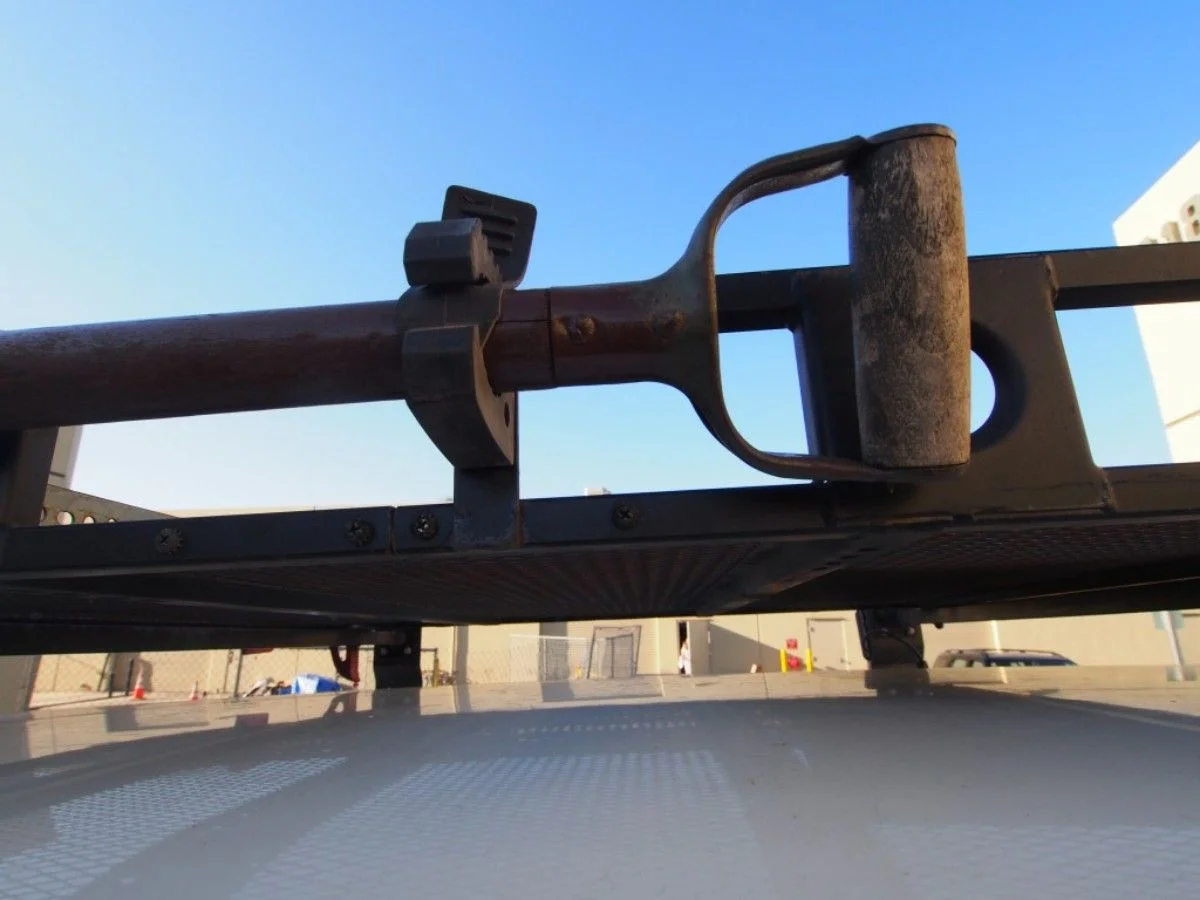

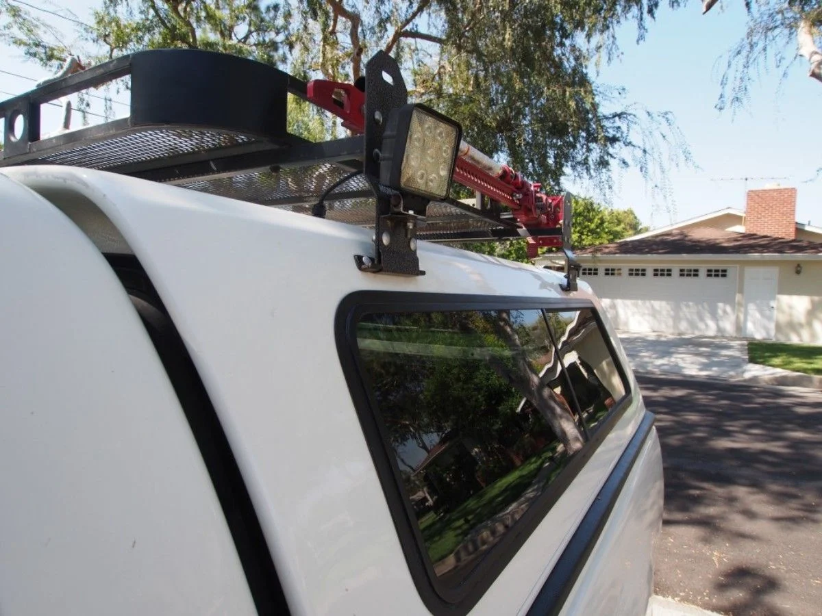

I built one out on the previous shell on my Toyota. I did the following:
1. Welded in a stretched steel floor. The plywood it had before didn't tolerate rain well.
2. Fabricated Hi-Lift jack mounts on the left side and welded them in
3. Added Quickfist clamps and mounted my shovel on the right side
4. Made it quick-detach with 4 bolts. I made custom cross bars and used a van ladder rack kit to mount it up with 4x 5/16" stainless bolts.
5. Added a piece of perforated angle iron from a warehouse shelf to lock my NATO Jerry cans down with. I could hold up to four across and they were very secure.
