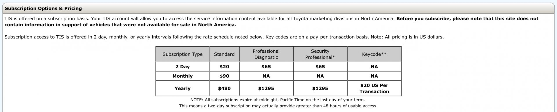

Regarding what you have access to and the length of the available subscription, I’m just learning about that now.
And I’m guessing that to program keys that the Standard subscription won’t work and that the “Professional“ version is required. The cost for a 2 day access to find out isn’t all that much. I’ll likely try to program other things too while I’m at it.
By the way, with a Professional subscription there’s access to something that sounded interesting when I checked it out last night. Here’s a quote from the same page the table above came from. “ Professional Subscribers receive complimentary access to Identifix Direct-Hit for Toyota “ Sound like some kind of knowledge base where professional mechanic, whatever that means, share repair and troubleshooting info/stories. Not knocking the help great members here share when someone is looking for answers, but methinks this Identifix thing might be helpful.

And to be clear, the TIS referenced length of subscriptions is access to the online factory service manual. It does not come with Techstream or the OBDII to computer cable.

Got it. Like I said, I’m new to this. Looks like for $1,500 or so, you can get the cable and Techstream Lite plus the one year access to TIS.
-> Question for anyone that knows….. What happens to Techstream Lite once the first year is up? Need to renew every year or do you ”own” it after the initial purchase?

It has to be renewed. That is the big advantage of the "alternate" method. They seem to have broken the time limit. The advantage of the "official" method is that it is supposed to run faster.
