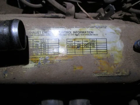

So I am *NOT* now the proud owner of a NEW TO ME 440... I now own a "440-3"
"same thing... a 440 is a 440"... ummm, no. As luck would have it... to be brief (google it)... I have an 'improved cooling' industrial engine... special unique heads (so I CANNOT swap to any other options) and some special one of a kind other thises and thats...
So... I should change this post to: "Any other 440-3 Guys?"!!!
Anyway... from an RV... so already has an RV cam (I win)... hardened everything already (I win), lower compression (lose), more torque (win), and low miles... so.... after all the bitching is done... no complaints... (so far!!!)

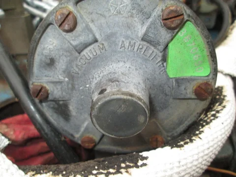

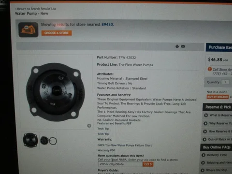

**Attached is the IMPOSSIBLE TO REPLACE water pump... :)
(check out the cool vac booster though!!!... booster for brakes is in the REAR of this RV... so they needed ALOT of SUCK. So now I have extra to use for..... something cool... later!!!)

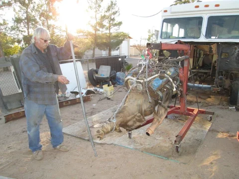

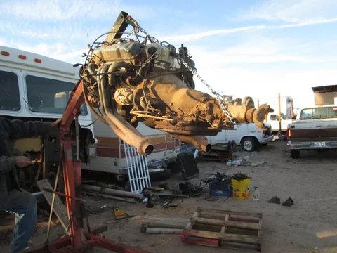

And yes... it is a beast (also note the total destruction of the RV to remove it!!!!)

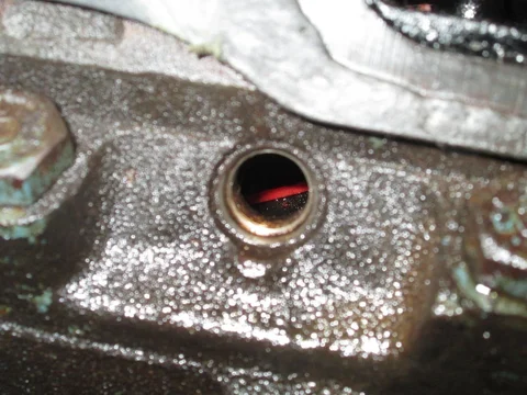

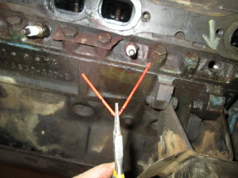

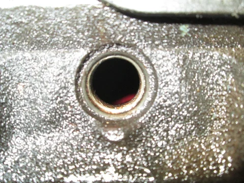

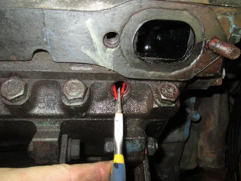

** I did have a fun little adventure... spraying all the holes (plug hole here) with DeepCreep to loosen everything up... and the STRAW BLEW IN.
Thought that was a head removal for sure... then we got creative!!! (and lucky as hell)

You'd have to search out the parts numbers from the internet gurus on all things Mopar - I've been away from those engines for far too long . The info is out there and specs on the head shaving argument should be found on the racing forums . Be careful handling that engine with stands and lift cranes - it's way heavier than it looks .
Sarge
Thanks Sarg... I was worried about the fitment... but is is nearly 8" narrower than an IH 345!!! Also a little lighter!
But yeah... lifting and moving with the 727 attached... less fun!
Now block only... and drained... happy on a super heavyduty stand!
