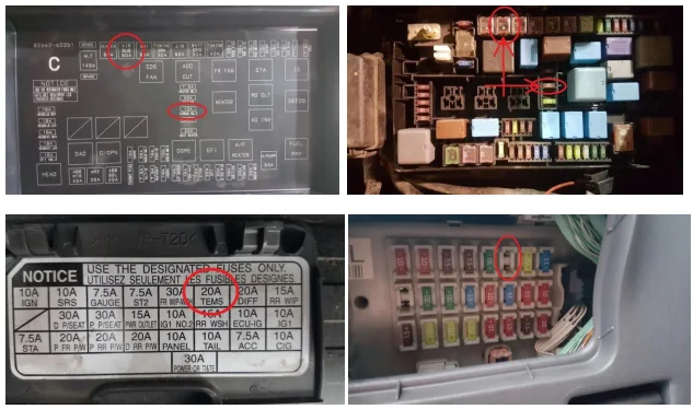

I've done as much research as I can but can't really seem to find the answer. So we lift our GXs, removing the air suspension and pull the 3 fuses/relay. EXCEPT, if I do that many many lights come on. I have to leave the TEMS fuse in and then the only light I get is the flashing "OFF" light. I've lived with it for about a year and it doesn't really bother me. But an answer would be good if anyone knew.
I have an 2005 (built 11/2004) and have done the ZPC. If I pull all normal fuses/relay that everyone recommends, I get several lights that stay on. If I leave TEMS in, then I only get the flashing OFF.

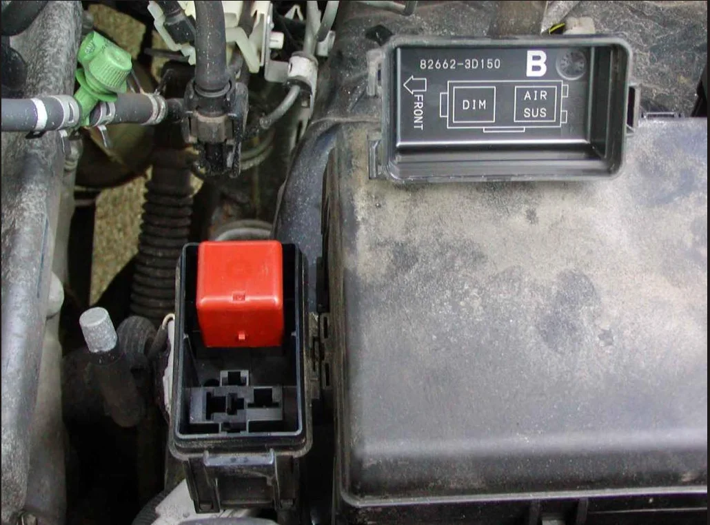

Under the hood I've pulled the AIRSUS fuse and relay. This result I get the flashing OFF light. Also pulling the TEMS fuse in the cabin gives me the many lights.
Did you pull everything noted in Metal Tech's instructions along with the relay in the small relay box on the side of the main fuse block in the engine bay?
Yes, I've removed all of those. However, if I leave the TEMS out, I get lots of lights. So, I leave the TEMS in just to only have the OFF light.
After consulting with @klavender1 little and doing a little more reading I started looking over fuses again. The 2 under hood fuses and 1 relay are infact gone. However the 20Amp TEMS fuse under the dash that I thought was pulled was not. So as of right now the "off light" is off after pulled the TEMS fuse. No other dash lights came on. This is on a 2006.
