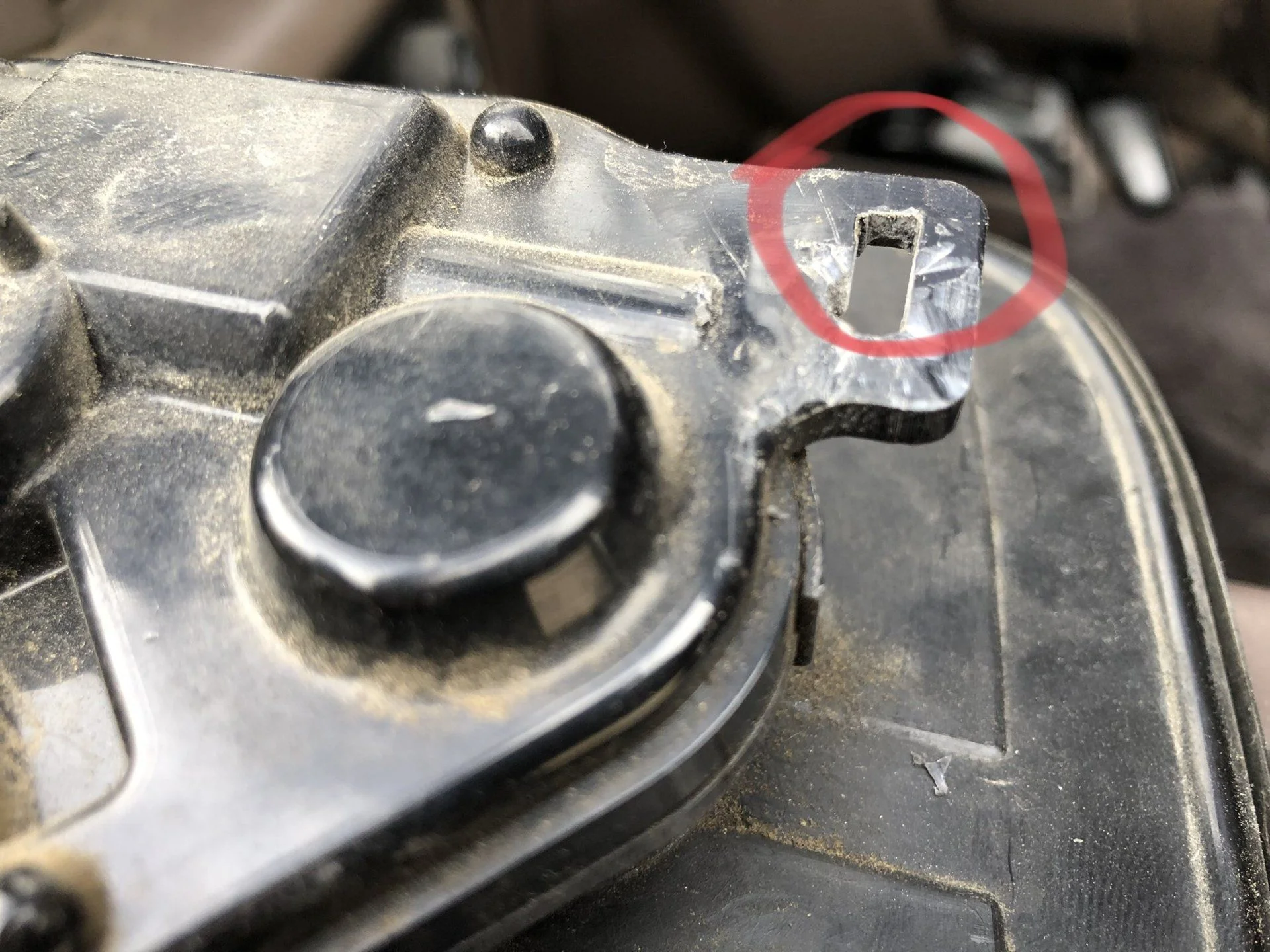

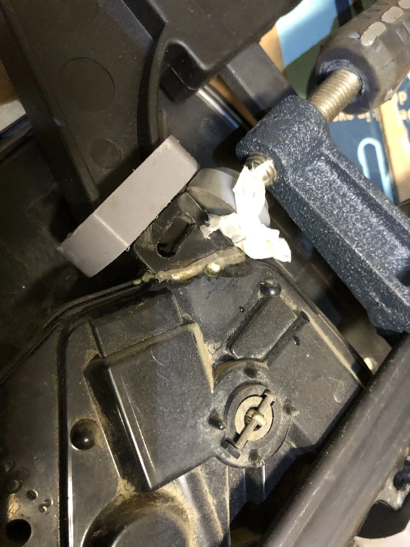

Just like most of 80 owners I have been dealing with shaky driver side mirror for years. Tried the zip tie method and didn’t work that great and pain to deal with. One the of the “ears” where the mirror hangs into the housing broke off a year go and fixed it with JB weld/epoxy, didn’t fix the shaking but some improvement. However the epoxy broke of a couple of weeks ago so I decided to use gorilla glue today and it should hold much better than expoxy.
After the gorilla glue fix the mirror still shakes ao I took a closer look on why it’s shaking. After taking off the mirror housing cover it was apparent that all the shaking is caused by the mounting slot to hang from the housing frame has been worn down and there is a lot of play.
So I decided to mix up a little bit of epoxy and filled the upper portion of the slot. I then waited till the epoxy is half cured but still soft and mounted the mirror and molded epoxy to the hanger on the mirror frame.
After a few hours I took it out for some hardcore mall crawling in the rain and no shaking!!!
So to solve the shakey shaky you just need 5 cents worth of epoxy!!!!

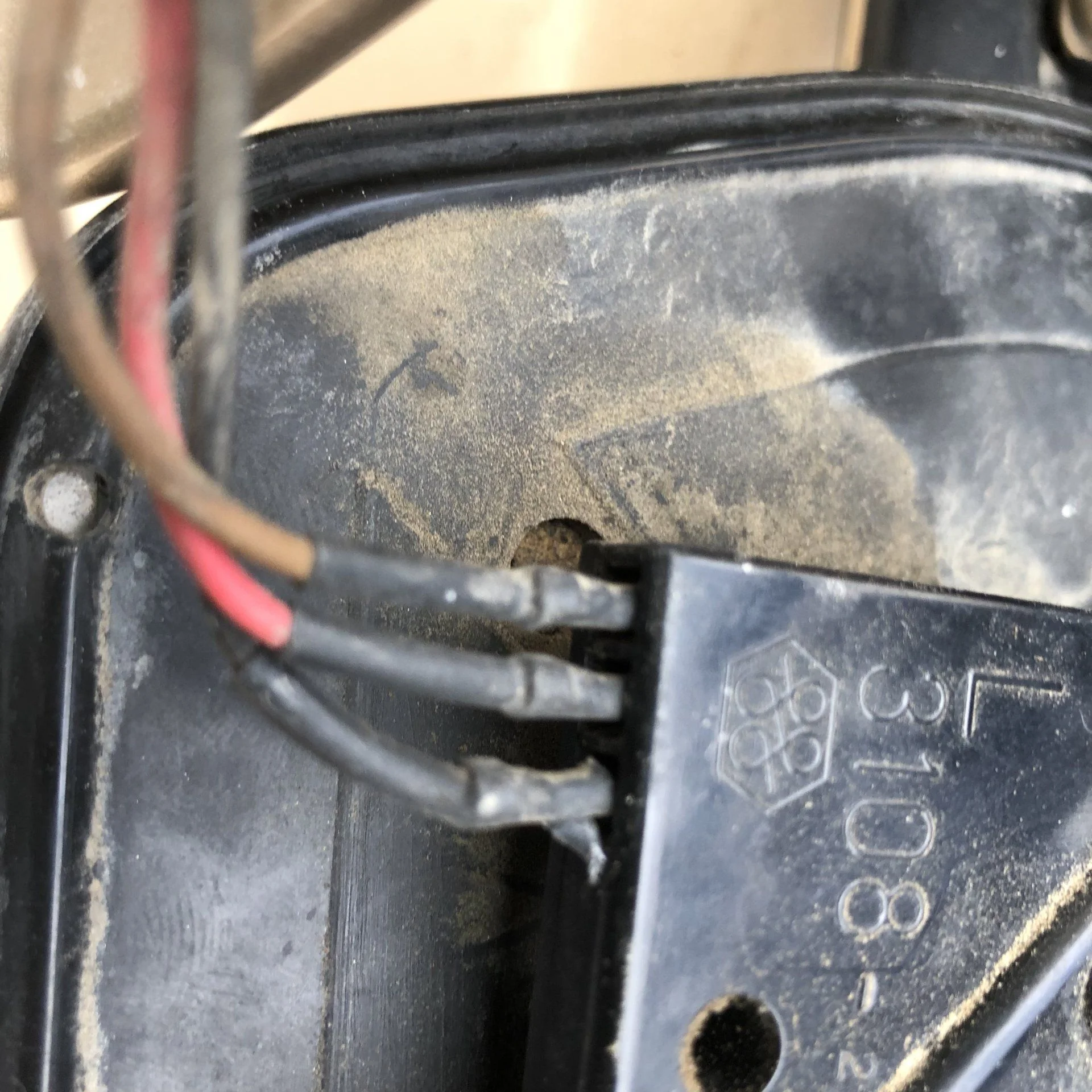

Oh here is the correct wiring for the mirror in case you have to figure it out like I did.

That’s why I waited for the epoxy to be half cured and still a little soft but not sticky, it will form to the hanger but won’t bond to it.
I'd suggest drill through the glued joint and pin the ear on with some wire and glue so you aren't relying 100% on a small glued joint
Not a bad idea, it’s hard to see but there is an extra piece of plastic behind the original for reenforcement. If it breaks again I’ll definitely try the pin idea.
