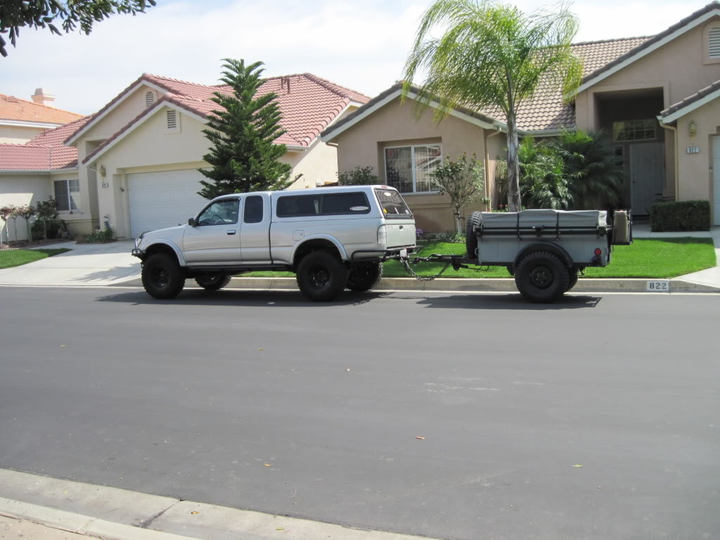

IMO the length of the tongue during normal use should be that which sets the tongue weight proportionately correct. You can do what is effectively a Shear-Moment diagram (& it's a good idea to do so regardless - see the link on tinytrailers.com) or you can apply a Rule of Thumb. The rule that I use is that the tongue length should be 1/2 the distance from the ball to the trailer axle. Then I do a Shear-Moment diagram to check that it works out. One trailer built like this has been certified stable to at least a sustained 80MPH on Mexico's Hwy 3 north of San Felipe. Or the driver was the certifiable one, but the trailer was stable at that speed, and it backs up better than all but one other trailer that I've pulled. That other trailer was also built using this RoT.
The 80 MPH trailer, post testing and looking a lot like Sanford & Son are using it:
