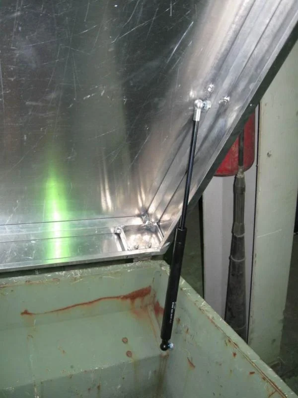

Eric Leblanc still had an aluminum lid available so that was perfect, saved me having to deal with that.
Put some canopy foam on the aluminum to seal it on the trailer and dropped it on, with the hinges Eric recommended.. no fuss. Nice product Eric!
Once the lid was installed on the trailer I took it to Strutwise and had em set it up with a couple of struts
Ended up with a pair charged to 250lbs each and some misc mounting brackets

Strut mount geometry and likely pressure needs adjustment.
In the current configuration 2x 250 lb Struts is not enough to
hold the lid with stowed RTT up. When RTT is open I have to keep the lid latched to prevent the
lid from poping up on it's own.

nice setup! those lids eric had look great. got a P/N for the lift struts he or you used? the pair im using for mine barely holds mine up now...but of course its not an aluminum lid. a gate does sacrifice a bit of structural rigidity. dont cut all the way to the top & you should be ok...they definitely come in handy though, especially with an RTT. good way to access the cargo area without having to disturb the RTT. on the latches, look at the HD draw latches from mcmaster. i used something similar, since the draw latches i got from home depot were nowhere heavy duty enough to withstand the rigors of off road trailering.

The position of the struts is the whole secret, on my buddy M101 the 2 struts were too strong, it wasn't easy to pull down the cover to close it, even with the RTT on.

Sorry, don't have a part number. Simplest is to just take your trailer over to Strutwise in Surrey
StrutWise sells,repairs,refurnbishes,custom designs gas struts in US,Canada,worldwide. and
Frank can measure up, pick out your brackets and he will charge your struts to whatever pressure required to do the job. Mine will take up to 500lbs charge each.
IIRC I paid $150 for the pair all in with brackets.
I have to rework my strut configuration. I like where they are at as far as being tucked out of the way, but the geometry makes it just too hard to set em up.
I am going to move em to a position where in the lid open position the angle of the strut is close to 90 degrees to the lid. The goal is full pound for pound mechanical advantage in the lid open position,
and when moved toward the closed position the mechanical advantage tips in favor of the lid...and the lid won't self open, even with the RTT opened up.
I would recommend you do same, especially if you are metal lid and planning for RTT.

Absolutely, and when you have the largest, heaviest RTT that Eezi Awn makes it really makes it a bit of a trick to get things set up.
We are lucky that we have a strut guy out here that can adjust the gas charge to fine tune things, and make adjustments as the lid load changes with mods down the road.

Frank at Strutwise told me that that the charge cylinder should be at the top for long strut life.
Then you put spacer so that the cylinder housing doesn't touch lid, he is probably right about strut life, but seriously, it ain't going to open has much has a rear car door!
