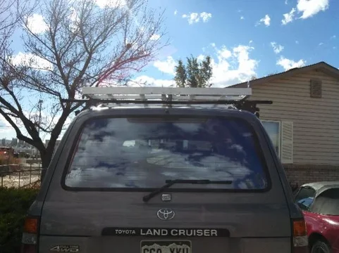

Another homemade, DIY, aluminum roof rack

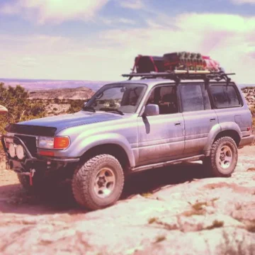

I made a similar rack out of an ATV ramp. Mine isn't as pretty but certainly works great!
Mine sits on Thule bars right now, also have a shoved and jack mounted to it. Here it is loaded on the Kokopelli Trail
Is the front of your rack load bearing?
Do you get much wind noise from your ramp rack?
My tires are louder than the wind in the rack.

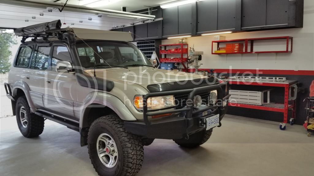

My JMoose with wind deflector - welded and powder coated. Ironman awning. Mounted on thule bars. The ATV ramp is rated at 1200 lbs and is a trifold
Man...I LUVV your truck!!
Thanks for the comment. Still a work in progress - there's a lot of nice trucks that I still want to copy from
Good Gawd @gofast, that shop is meticulously clean! Envious as I can barely walk in mine.
Just finished plumbing the air. Its a brand new shop build - hence the cleanliness. I started from bare dirt last September and finished construction in November - been fitting it out ever since - When you come to the Okanagan next time drop by for a beer.
