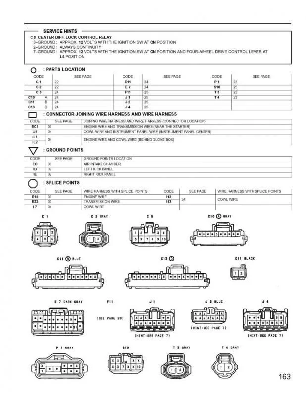

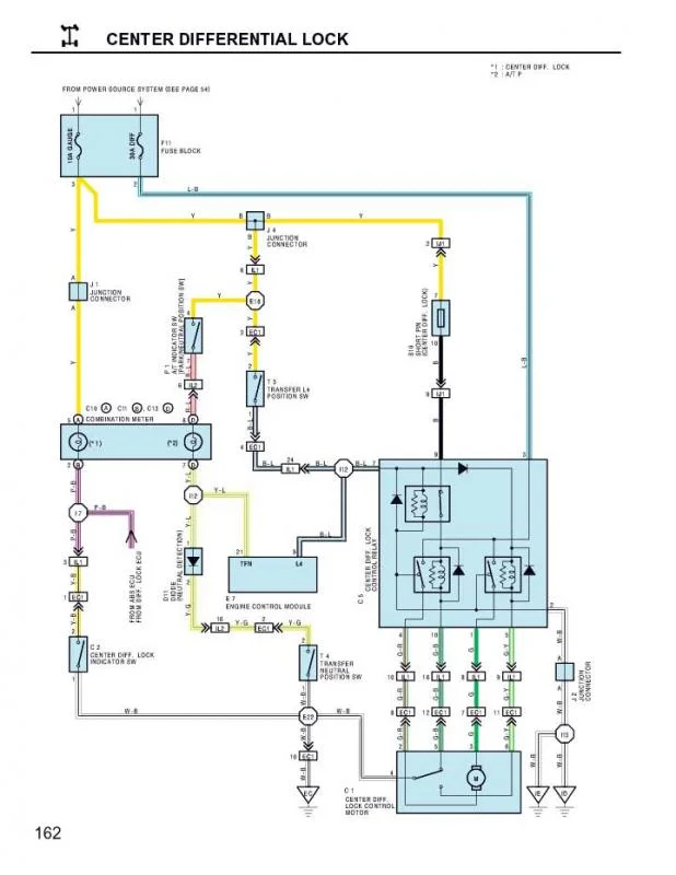

Yes you should hear the relay click, if not some tests;
The circuit is powered by terminal 3, the blue/black wire at the relay box, should have power when the key is on.
The relay is switched by terminal 7 the black/blue wire, it should have power when the switch is pressed or transfer is shifted into low. If not could be a bad connection, switch, etc.
Ground for the relay comes from the actuator position wiper switch, terminal 10 should have a good ground when the actuator is in the unlocked position. Could be a bad connection or the most common failure, the wiper in the actuator is not making a good connection, rusty, gunked, needs to pulled and cleaned.
If the above test good it maybe the relay box, but that is very rare.
