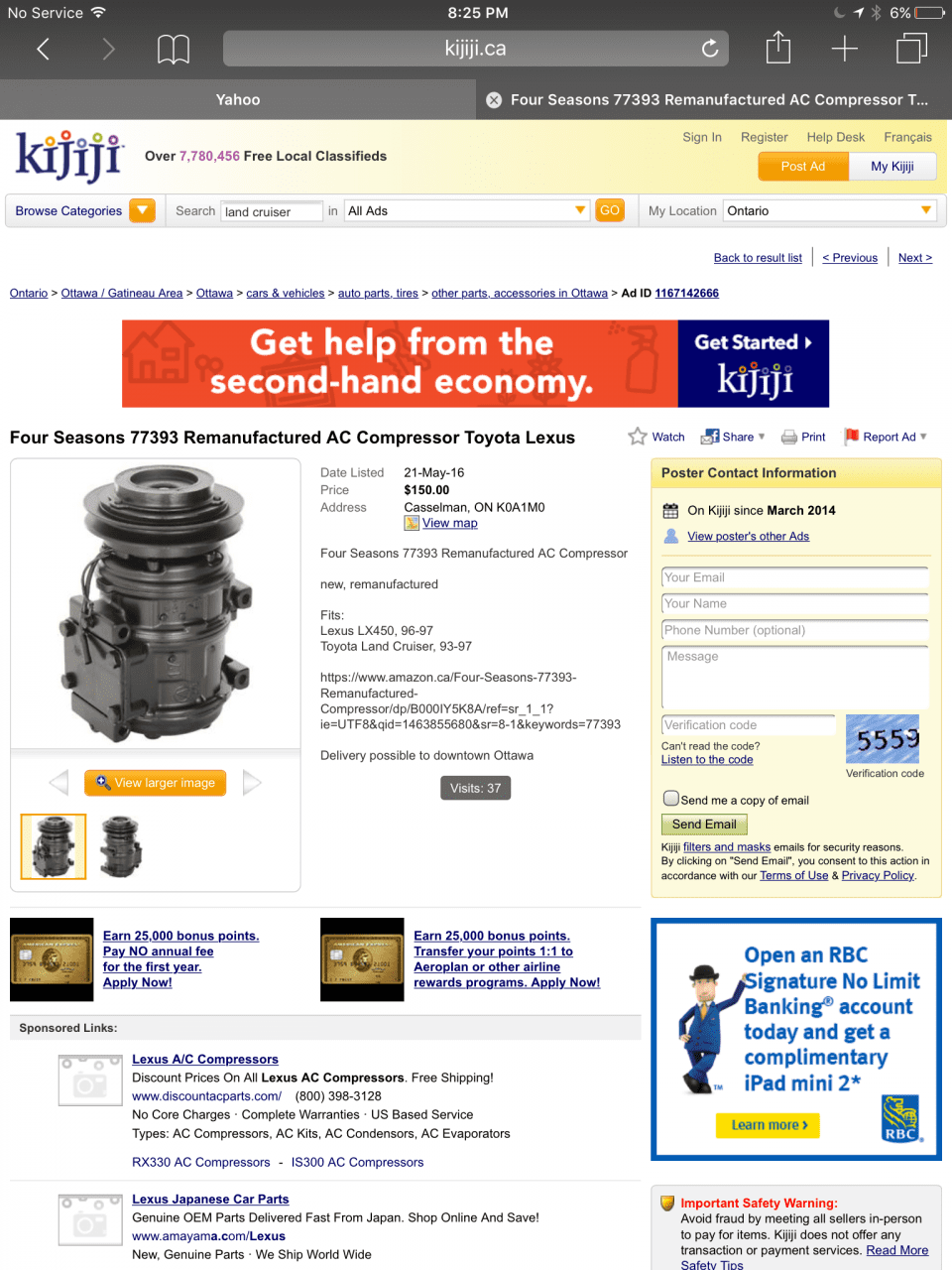

Like what everyone has said, you won't damage anything, unless your clutch is NS. If there is refrigerant in the system, and if there is sufficient amount to generate the minimum pressure, the clutch should engage when you press the A/C switch with the engine running. You should try this without the belts if you hadn't already installed them. Came across this local ad today a for rebuilt compressor.
