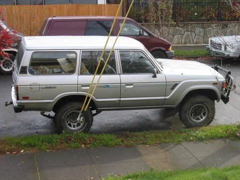

Another 3B conversion
Ive been driving the rig around town all week and put about 200 miles on it. My brother arrived here in Portland Thursday night and we have been working non stop to tie up loose ends
In the past few days we installed water, oil, and pyro guages permanently.
We also built a wire harness for the edic (between edic motor and edic relay). We spent a bit of time on this partly because I re-assembled the edic motor incorrectly. I had to take a working one apart to compare and got it working.
EGT has been a little high. Its easy to get to 1200 so we may turn it down a bit. There has been no smoke at all and oil pressure is great.
Last weekend I installed an OME lift and 33x12.5 tires with new rims. At this time I replaced the front axle with one from an FJ62 and replaced the rear diff with 4.11 from the same 62.
Tomorrow we leave for the 2400 mile trip from Oregon to Indiana.
Here is a pic with some temporary 32" tires on it. Ill post some pics of other parts of the process after the 25th.

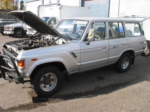

Turbo Time!
Truck running great, Pyro's down across the board after the injector rebuild, been a few months and a few thousand miles. Seems to have more power and runs smoother. I have the new motor mounts that will be going in in the next few weeks which will help with the vibration.
The truck is still for sale and in the next few weeks the Turbo will be installed. I have all the parts for the install, just need to get the time. I will be having surgery 6/30 so plans are to install the turbo shortly after. I'll keep you posted
