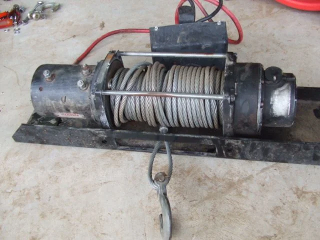

Hey I have an ancient old warn winch, I don't know what it is but it's REALLY old, it's 6000lb.

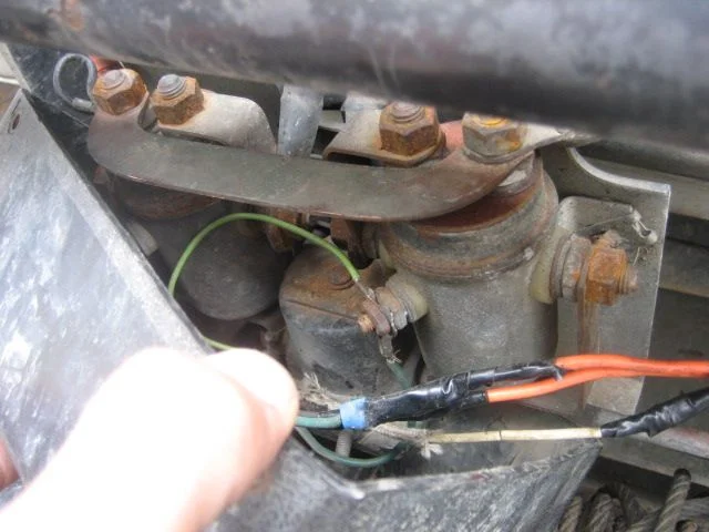

The motor works great, but the electrics that control it have kind of had it... I had it going a while ago, but now it pretty much just makes weird noises at me. Is there a simple way to just get a new control box for it... like a generic one? I mean all it does is switch the current polarity right?
the electrical side of a winch is really not that complicated. So, yes, I would think that you should easily be able to find a solenoid box off a current line that would work with yours. Just watch out for max current specs. And Warn customer service is really good, talk to them.
here we go... sorry for the size and weird angles, i'm at an internet cafe with my camera

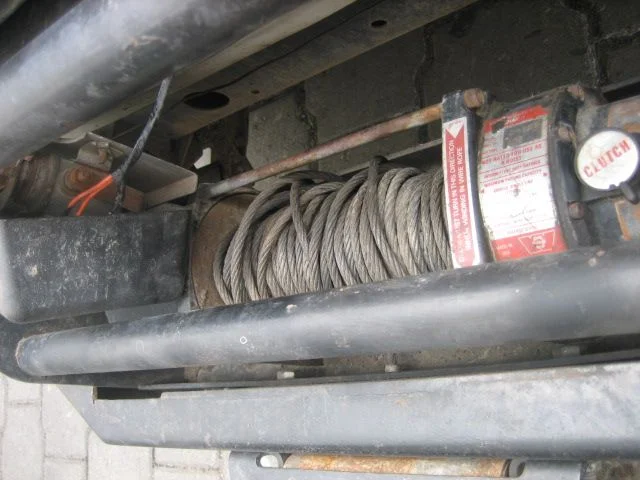

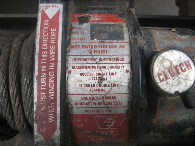

I did some work on a similar Warn a couple yrs ago. Here's some info that may help:
Orig_install_1986
NLA means No Longer Available

well, just figure out the wiring on your winch, how many wires, where do they go, see if you can get info on max current. Then find a solenoid box that is big enough and has the same type of connections. Probably check Warn boxes first since I doubt their solenoid box connections changed much over the last 20 or 30 years. But I imagine any number of manufacturers make similar boxes.
