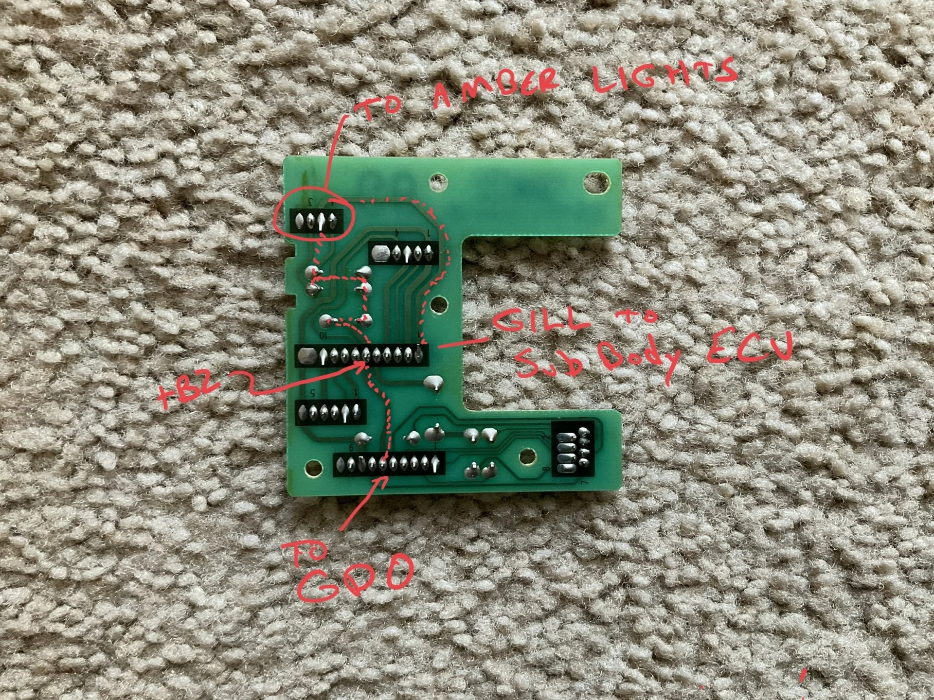

Here’s the EWD pics. Amber lights are highlighted on the second page.
Actually, I just looked at my overhead box and the thing I highlighted is some other illumination and not the amber lights. I can’t find those anywhere on the diagram. Sorry. Hopefully somebody else will post up whether or not theirs stay on
Looked a bit more and now I think it’s part of the garage door opener circuit. The EWD shows it being controlled by the sub-body ECU. Not sure where to take it from there. First pic is the EWD, second pic is the PWB from the overhead marked up with the light circuit.
My overhead console is out right now so I can’t check, but I’m pretty sure it does.
Looked a bit more and now I think it’s part of the garage door opener circuit. The EWD shows it being controlled by the sub-body ECU. Not sure where to take it from there. First pic is the EWD, second pic is the PWB from the overhead marked up with the light circuit. View attachment 2712801View attachment 2712802
